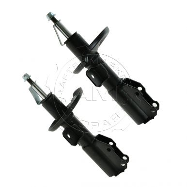

Based on a phone conversation yesterday with a sharp Bilstein Tech, my assumtion about the front struts being different on the 4MATIC vs the RWD was correct. They attach at the bottom differently:
2009 C300 RWD
2009 C300 4MATIC Not MB, but similar lower attachment
I assume global sales of the rwd are much higher than the 4MATIC, thus the limited offerings for 4MATIC shocks.

Originally Posted by Knightmare69
If someone could post a pic of their 4-matic front shock absorber I can post a pic of my oem rwd front shock and we can compare.....
Based on your old oem rwd front shock, which of the 2 shocks pictured above does yours resemble, down in the bolting location ? The picture or the illustration ?
Thanx
Thanx

I'm still traveling for work so haven't been home. However I noticed that a member (C200k W204) graciously provided a DIY for spring install and there is a pic of his front shock. We can now definitively confirm that RWD front shocks and 4-matic front shocks are in no way compatible.

Great! That pic and my MB illustration for RWD makes it definitive for the RWD model. But still would be nice to see a pic of a 4MATIC front strut, to put it to rest.
