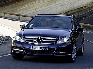

That is a final pre facelift Avantgarde with BiX & Parktronic. US cars are differently configured.
Here is after facelift.

Avantgarde only partially = US Sport model. US Sport models have things missing & also use an AMG style front bumper/spoiler. That AMG spoiler etc. is part of the Sport Pack in some markets. In other markets the AMG style bumper is not available.
