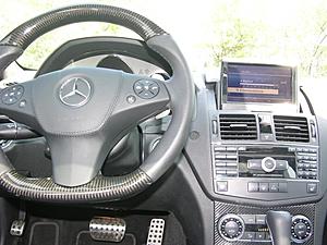

It have been done this retrofit in Germany, look the picture.

Its Look Nice, but this is the ntg4 from the e-class. This is Not the ntg4.5 with the sd-Card Slot!
