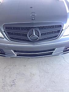

Old Jan 17, 2015 | 06:19 AM
  #140
0mercy's Avatar
Joined: Jan 2015
Posts: 146
From: Georgia
2010 S550 + 2014 CLS63 + 1993 300zx TT + 2014 Pathfinder + 2013 Hyundai Sanata
A few pics after the job completion... I'm yet to get a night picture but then again its only been 24hrs since the installation.

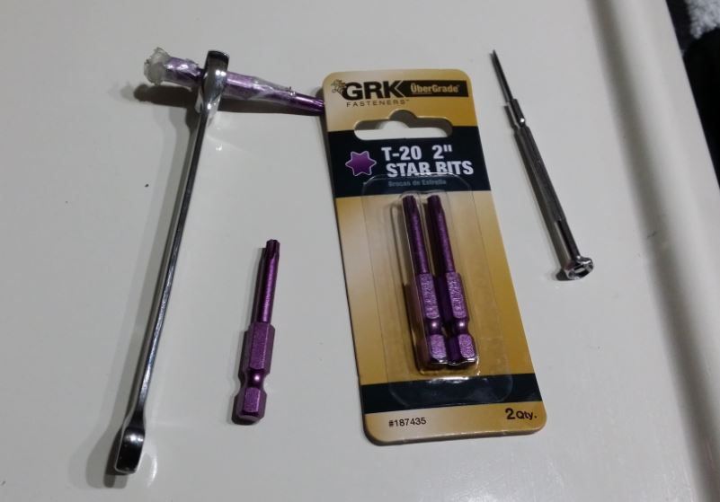

Ok, I installed my FULL TIME illuminated Star this weekend in my cold *** garage.
Those two rear SAM screws are a pain to remove/replace without the correct tools.
You need a 1/4 inch compact ratcheting bit driver because there isn't much space near those rear screws.
I made my own tool using (below):
Insert the bit into the wrench and put some tape on both ends of the bit. The tape will keep it from falling out of the wrench. I lost two bits before I got smart.
ratcheting wrench and 2 inch T-20 bit.
Those back screws added 2 hours to my install and I had to keep running to Home Depot to buy new torx bits because my fat fingers kept dropping them down the engine compartment.
The star looks good, but I didn't realize it was only lit when the engine is turned on.
The star does not light up when the doors are locked/unlocked.
I will fix that later.
