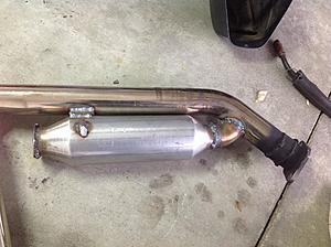

If you guys have drone and rasp its a easy fix. Google Helmholtz resonators. Branch resonators at the correct length for the rpm it drones at is also a easy fix.
