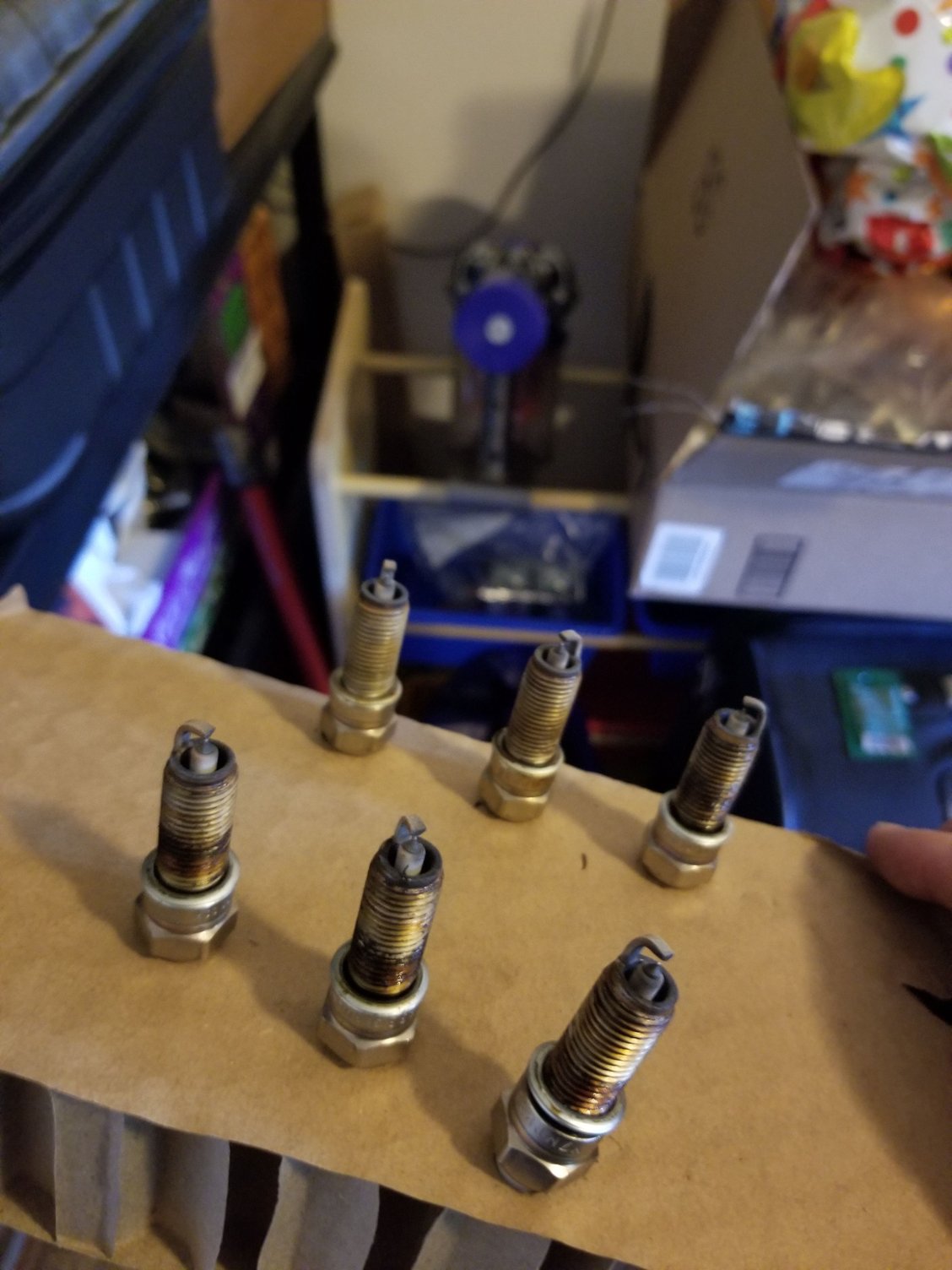

so i put those iridium R7 in and car runs bit sluggish, so I reset the ecu and engine perked up.
Anyways, anything the old plugs are telling me? they all had ash deposit of various amounts, I blew them off. 2 threads are drier while 4 are oily. TIA for youe feedback!

Boy, those have a lot of threads on them!
