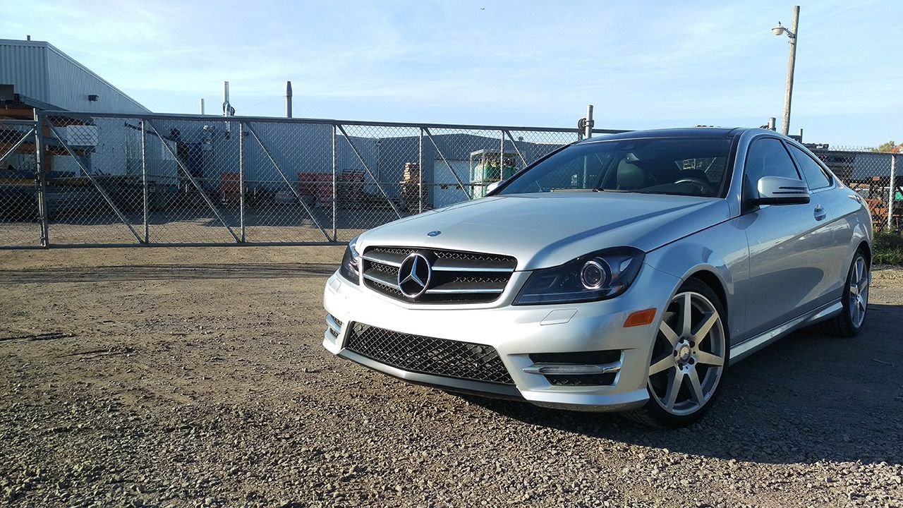

Well I've put square tires (225/45/18) on my staggered wheels. I have a C350 2013 with the 18" AMG wheels package (8 inches wide front and 8.5 rear) and I use these wheels for the winter. The difference between the front and the rear is really barely noticable.
I did that to have the possibility of rotating the tires and also because smaller tires width = better traction on snow.
I'll buy new summer wheels when the winter is over.

It can't damage the 4matic. My setup has the same tire diameter as the factory spec and it's the only thing that matters. Only the surface of contact to the road is changed and that's totally okay. By the way I just checked my car manual and it's 8inches and 8.5 for me. Canadian version. I measured them too when I made the switch.
I did ton of researches on that and I'm sure about what I'm doing. Also tons of c350 4matic are on 17" square.

The split spoke AMG rims on my C350 are 18x8 front, 18x8.5 rear. I think the guy is correct.

Mine are those:
And from the manual:
Old Dec 22, 2016 | 11:01 AM

I have the same
