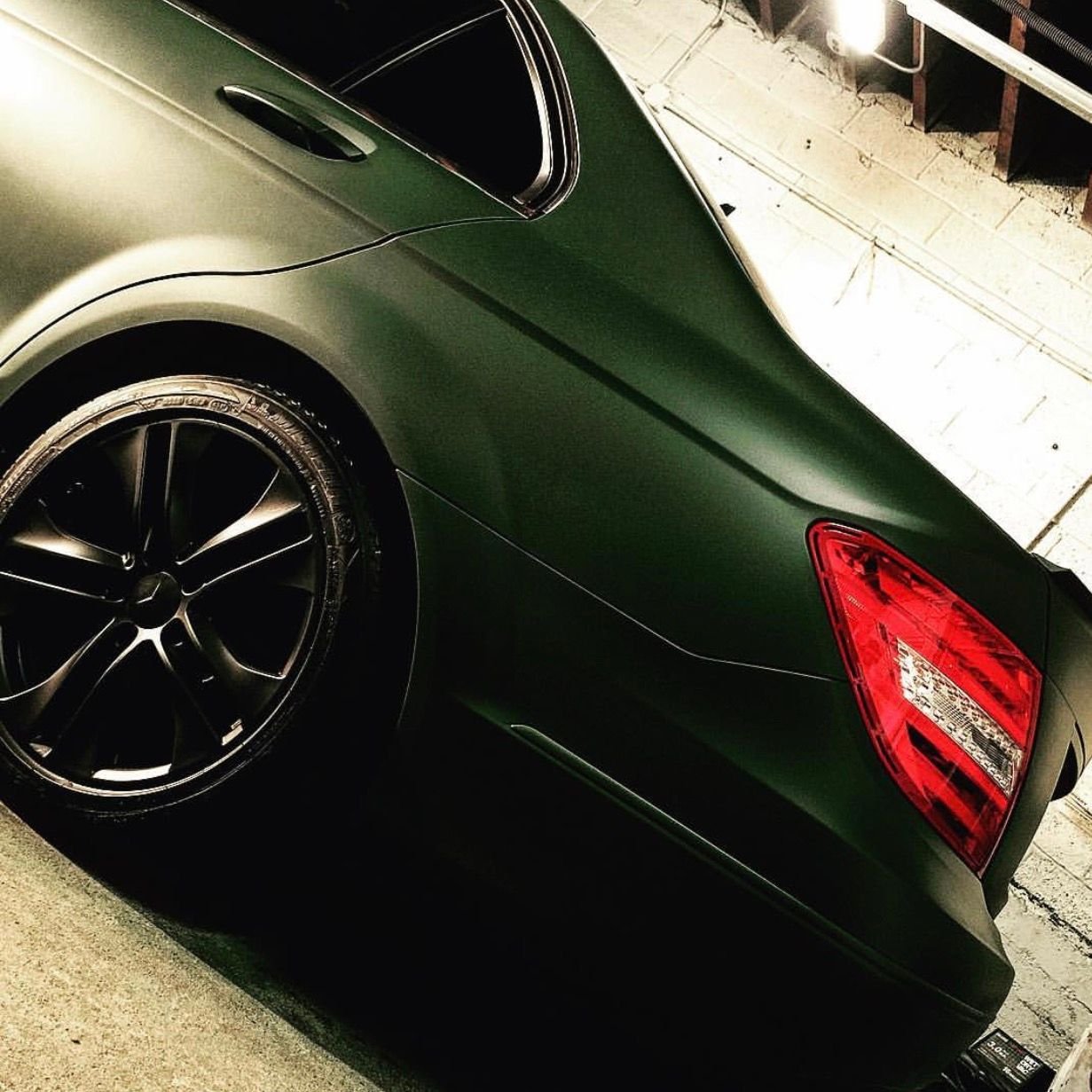

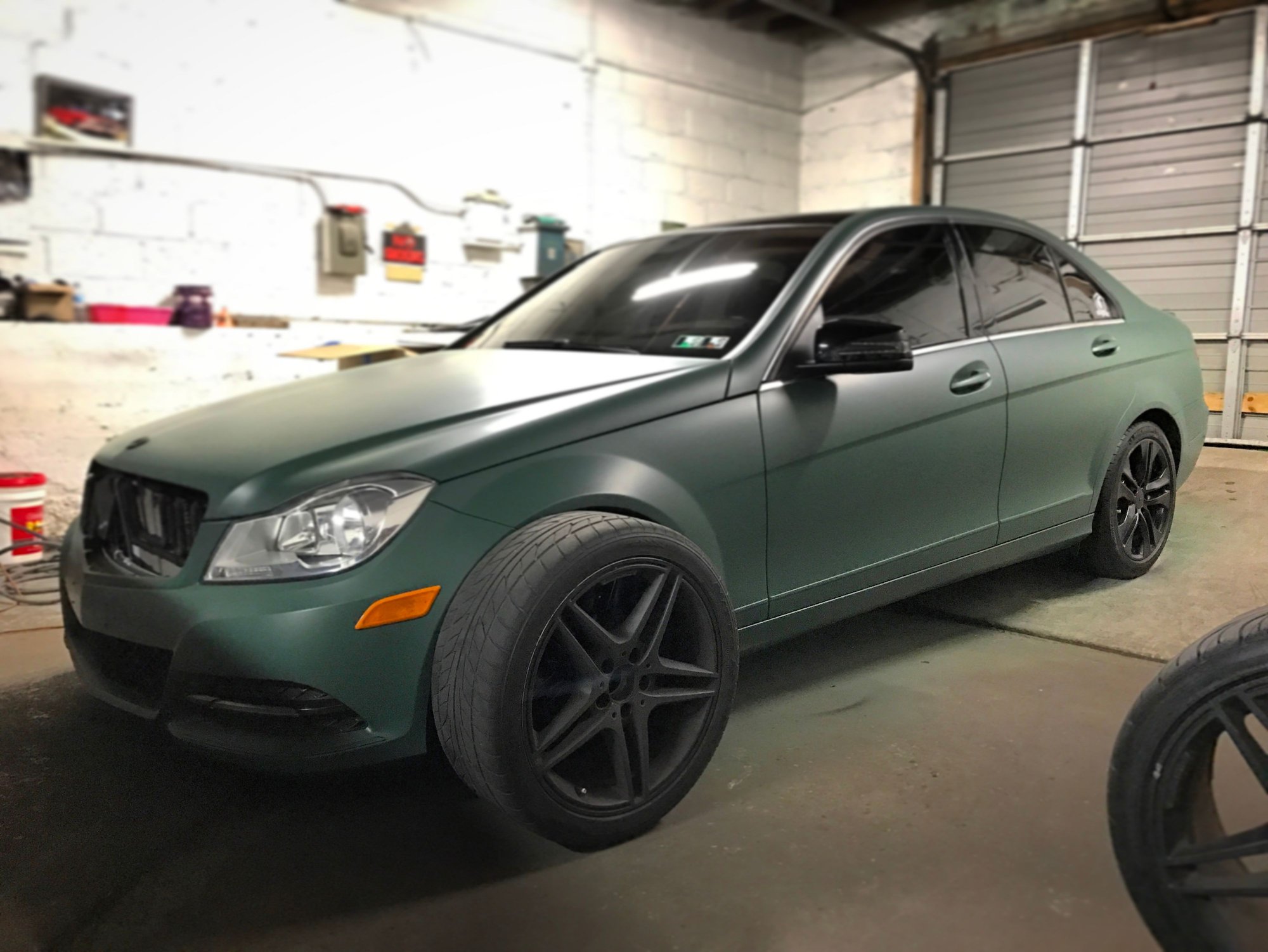

Stock 17" wheels
These are the wheels I bought these are for the rear 18"
Rear wheel
hey guys so this is my first time using this site. I've read a few post about this topic but still not clear. I have a 2013 Mercedes C300 Luxury 4matic. I've been customizing the appearance of the car, and I lowered the car with Lowering springs made for 4matic models. I just purchased a set of 18" c63 wheels that came off a 2012 C63, now I noticed that it's "staggered" and wanted to be sure that it's ok to put them on my car. I don't care about voiding warranty as it's done in another 1500 miles, but I don't want an major issues happening because of the wheels. I want to put new tires for the wheels. Please leave the best suggestion as far as what size I should go with for my car being a 4matic and a luxury edition. Please no smart remarks as I am only trying to find out some information. I appreciate any correct information.

What are the specs of the tires? They need to have the same (or very close to, within 3% I believe) rolling circumference or the AWD system won't be happy.
Stock staggered setup for 4matic sport models is usually 225/45/17 front and 245/40/17 rear.
If you punch those numbers in with the tire aspect ratio calculator here, you'll see that they have a very similar number of revolutions per mile, with a 1.2% difference. What is the width of the front and rear rims?

The new wheels are 18x8 in the front and 18x8.5 in the rear
Thanks for any info
