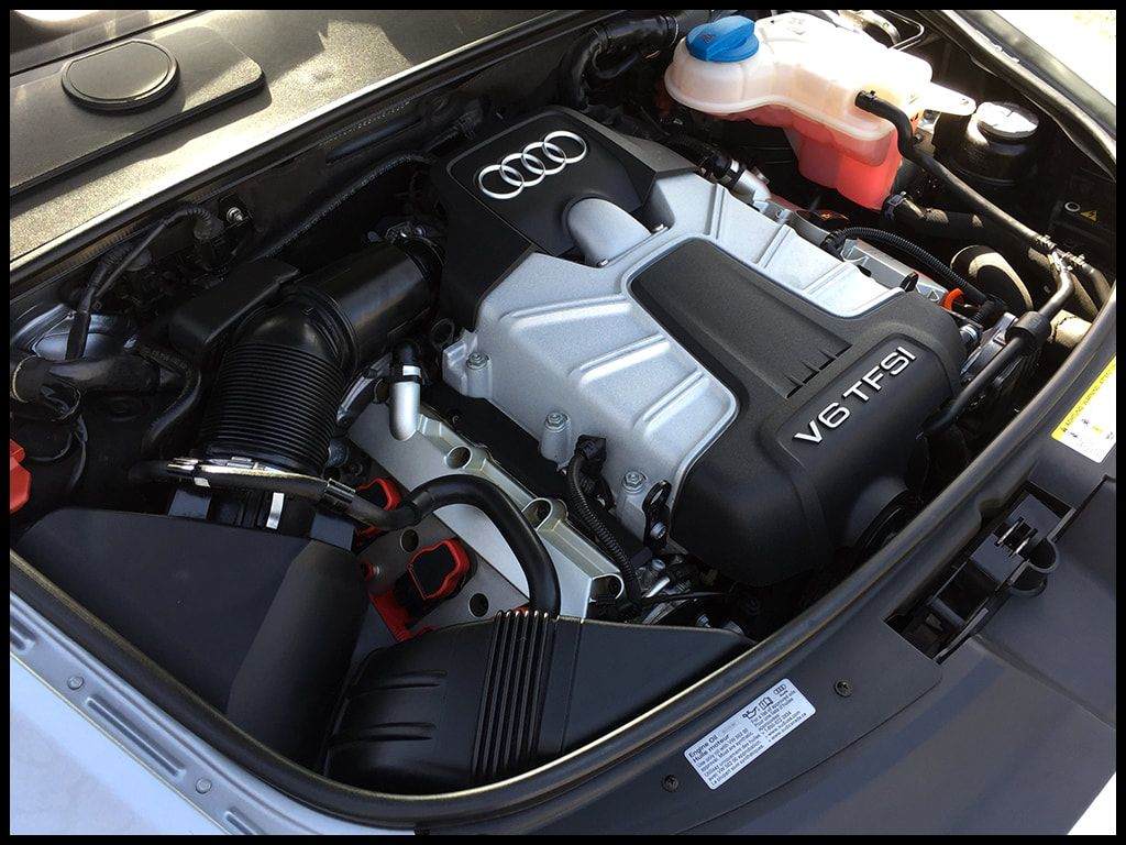

I know this is a necro-post from 2017, but I wanted to contribute with something I know about... I run a detailing business as a side hack on the weekends and I have been doing engine details for 4 years without any problems (and before that on my own cars for decades). The red flag in the original above post is the term "pressure washer." I would highly recommend against blasting a pressure washer in your engine compartment, for many reasons. No matter how low of a pressure they use, it's not low enough. Just don't do it. Not worth the risk.
The proper way to clean an engine is to let it cool off, spray it down with a 4:1 to 10:1 diluted degreaser or all-purpose automotive cleaner, then agitate everything with a brush. Some people have success with a small wheel brush, I prefer
these these
, personally. Rinse with a rain-type setting on a hose nozzle. I use a leaf blower to blow off excess water inside the engine nooks & crannies, too. I then spray down all engine compartments with a water-based dressing made by Meguiar's called D170 Hyper Dressing diluted to 3:1 for a satin finish. It's simple and it looks great when you are done. I hate working on dirty engines, so it's something I do to all of my cars.
Customers:
