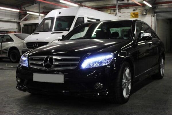

Those are actually custom OEM headlights, that photo has been around for a while.
You might have missed my comment but here is all the pictures we have so far from forum users:

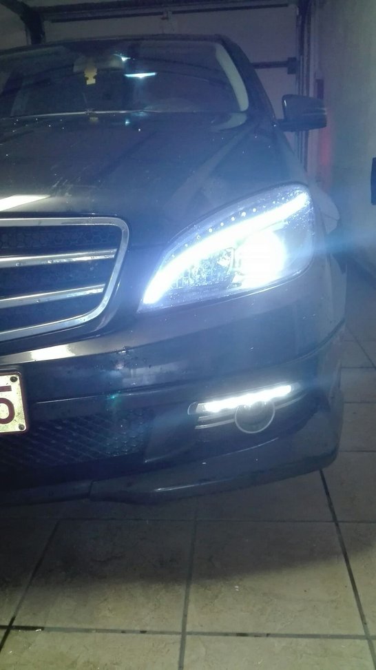

Few more from Doa

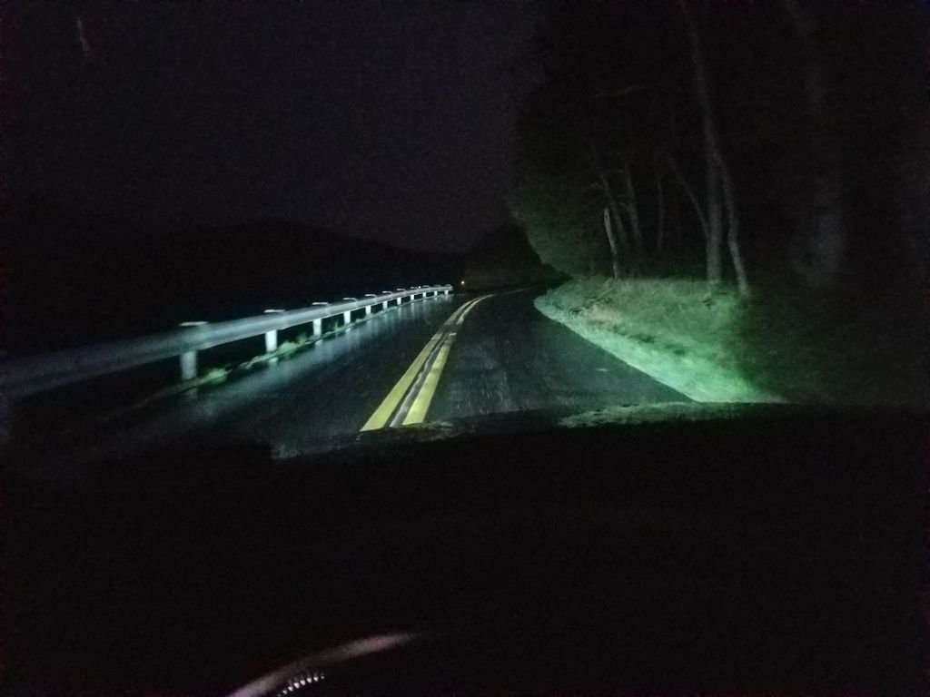

I'm not sure if technically they have proper beam pattern but it doesn't blind people and it for sure helps me see like actually see compared to my stock halogens.
To get an idea I snapped a couple quick pics just with cell phone. Not great with rain and all but I think it will give a good idea. Also, Morimoto XB 5500k on 35w ballast for HID setup. Some pics you will see I had fogs on, I think this will only apply to pre facelift w204's, or maybe the LED fogs or something make up for it, I'm not sure.
I have default projector glass in as well so maybe it's letting too much light out? Even if it's not good glass I can see clearer and with a better cutoff than I felt like I could get out of stock halogen in stock projector housing. Also for HID it has to be H11/H11B, found out hard way haha.

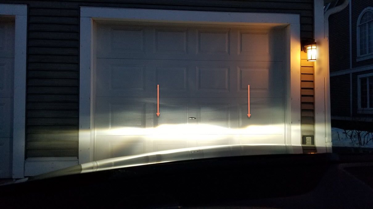

This is the pattern on my stock projector headlights with Morimoto XB35 + 6500k H7 bulbs from TRS (the retrofit source .com) . My car is about 4 or 5 feet away from the garage door and I cleaned my headlight lens before taking the pictures. Not a perfect beam, but like you said, it doesn't blind anyone.
If you can take a NEW picture, 5 feet away from a flat white surface (like a garage), that would be great! (also, clean your headlights first)

Looking at these pictures, aren't the light pattern abit narrow? I mean, no light on the sides close to the car.

I mean the pictures before that, the guy that took them on the road
