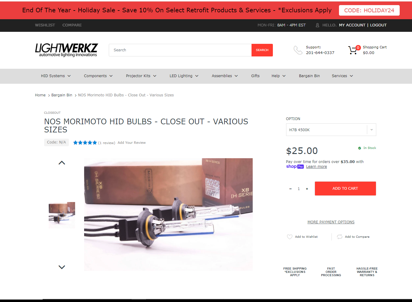

I was looking around and came across Morimoto bulbs at Lightwerkz for $25. With the savings code it came to $32 with shipping. I think my current ones I paid $50 + shipping. I figure why not have a spare set. They are the same ones I have currently installed, the H7B-4500k.
