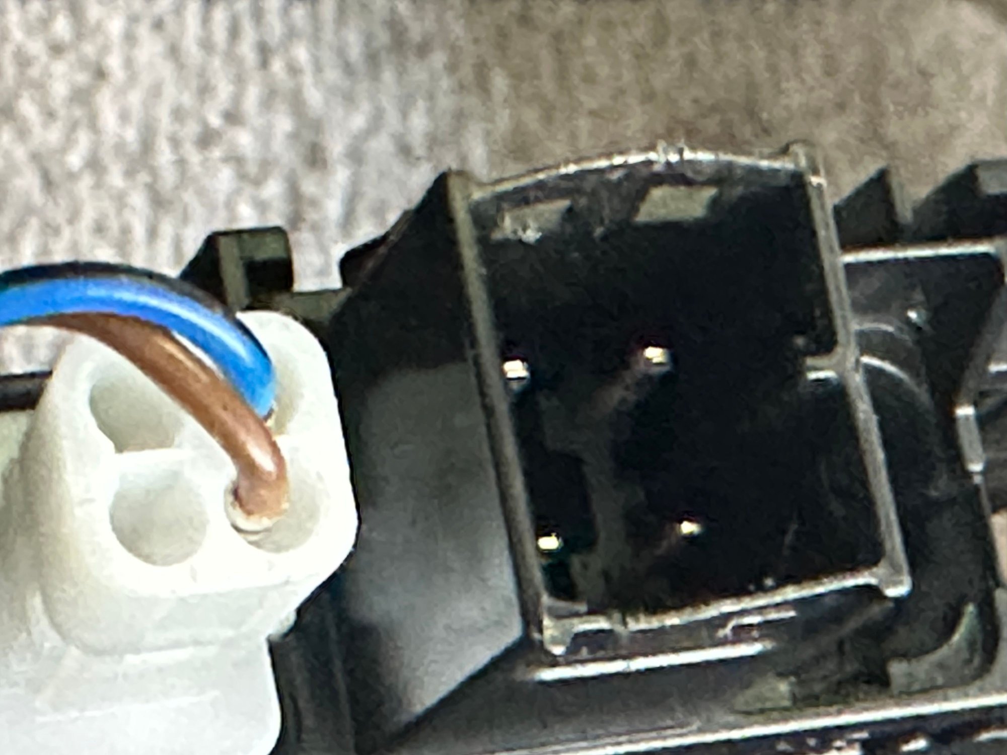

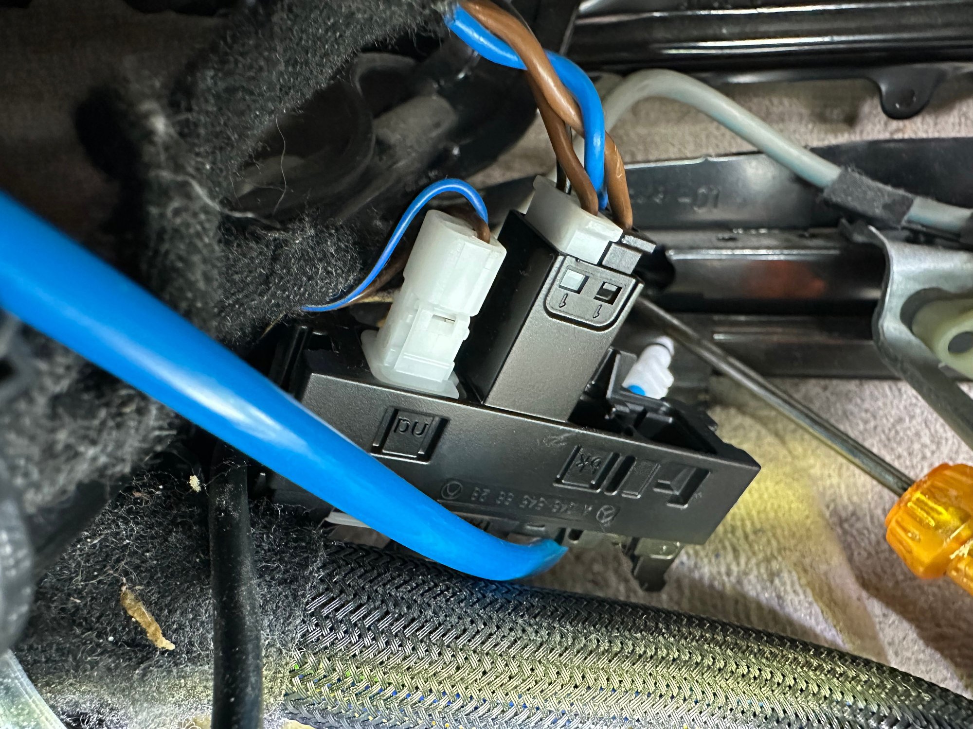

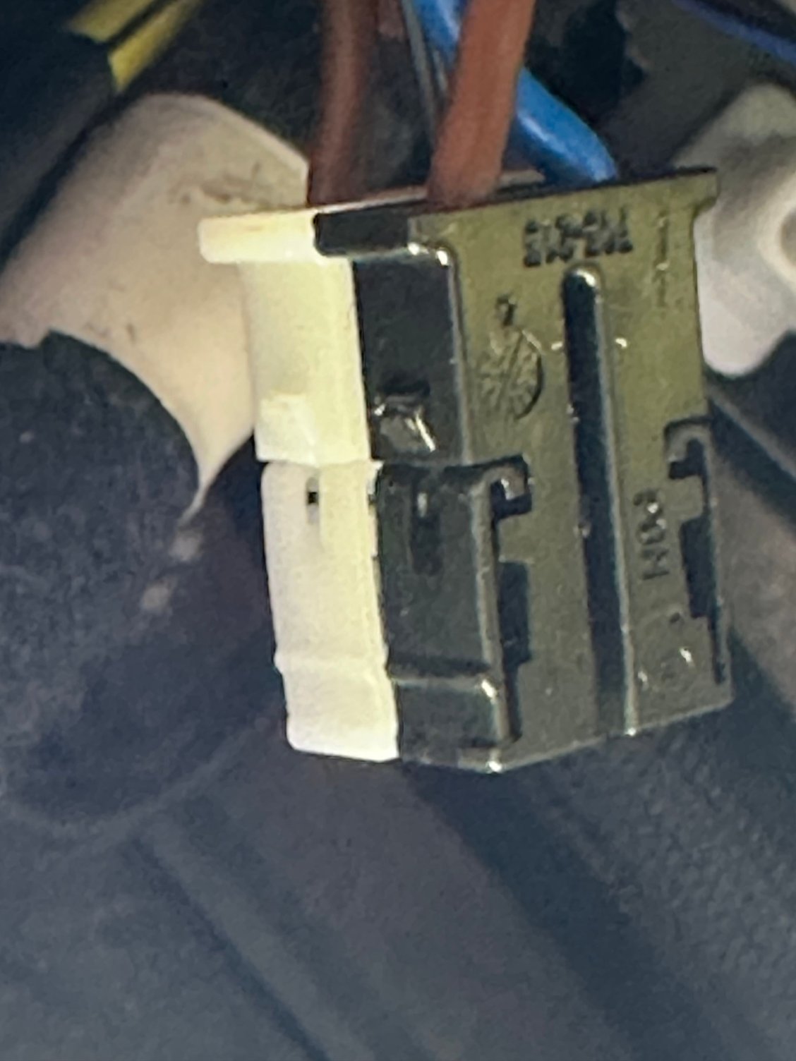

Old Yesterday | 03:28 PM
ih8germancats's Avatar
Joined: May 2026
2016 MB E350 4matic
Pics of the plug aka satans ahole
Originally Posted by GeSeGLK350
Happy to hear this helped you. I had to change the passenger side a couple of months ago. Was even quicker second time around!
Push this plug toward the front if the car - it pops out and you have more room
This is the plug you will swear at. I ended up using a pick next to the ridge to pull it out
See the ridge on the plug - get a pic in there to pull it out
hope this helps to see what you are up against - took me 15 mins after searching.
1 push whole block forward pops off for more room
2 using a pic to wedge by the rib and it will pop off with some swearing
