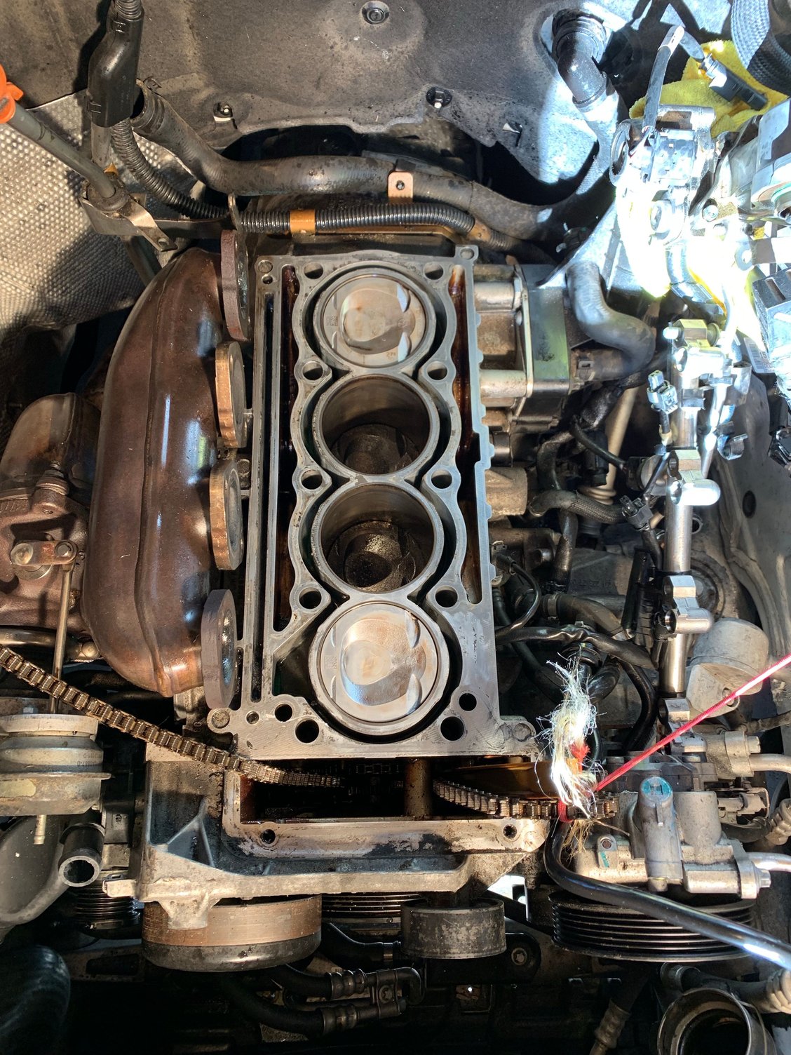

If i had consulted before starting the job I probably would not have attempted to do it but now since I have already done the tear down, absent of anything I can see that definitely says it wont work I have to do the rebuild and see what happens. I have also already bought the parts,hardware and Tools that I probably will never use again - there is no way I am stopping now.
I will keep this thread updated on the progress.
I just did a preliminary clean up on the block, cylinder walls and piston heads. Doesn't look that bad. I will tackle the head tomorrow and then take it to a machine shop to check whether it is warped again.

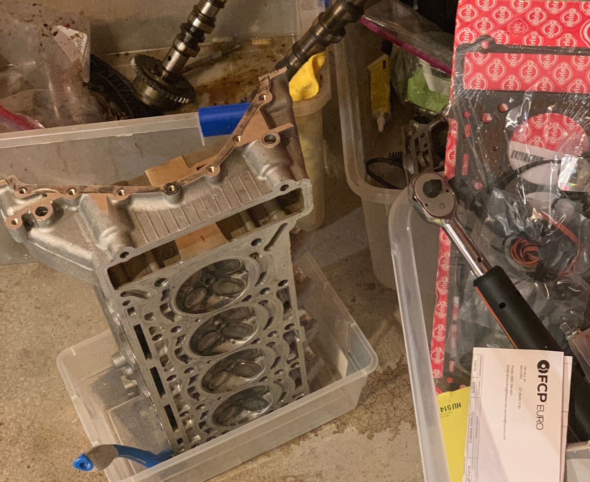

Head is off to the machine shop to check flatness(warping), replace valve stem seals, reface valve stems, cleaning, vacuum check and pressure check.
