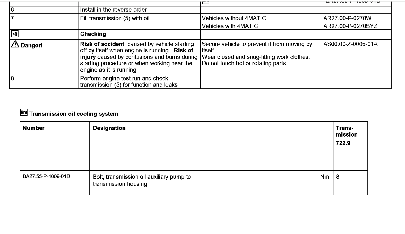

Anyone know the torque values for the bolts on the auxiliary pump?

Old Feb 12, 2025 | 08:54 AM
W212Wagon's Avatar
Joined: Jan 2025
Posts: 20
Likes: 13
From: Connecticut
2015 E 350 Wagon
Thank you!
