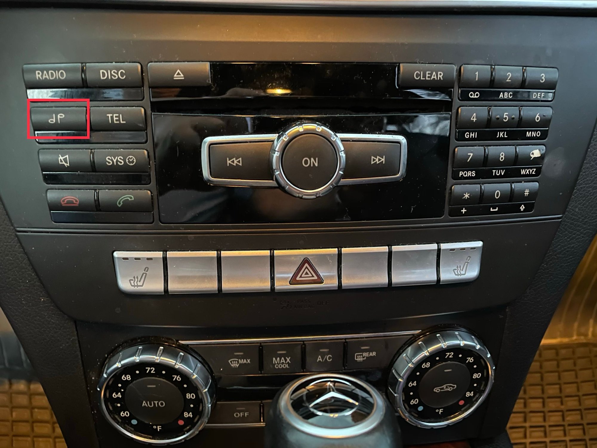

Hello all!! New Benz owner here and I’m really excited about it. However, I’m trying to figure out how to tell: 1) If I have navigation, 2) how the heck do I make it work? I’ve searched several threads and tons of googling and I’m not really finding much of a real answer. My car is a 2012 C300 4Matic Sport and the options show 001 Accessory Navigation System, however, when I push the “notes” button (see pictures), “No Navigation” comes up on the display. Do I have Navi or not?
Options from mbdecoder
Head unit (notes button in red box)

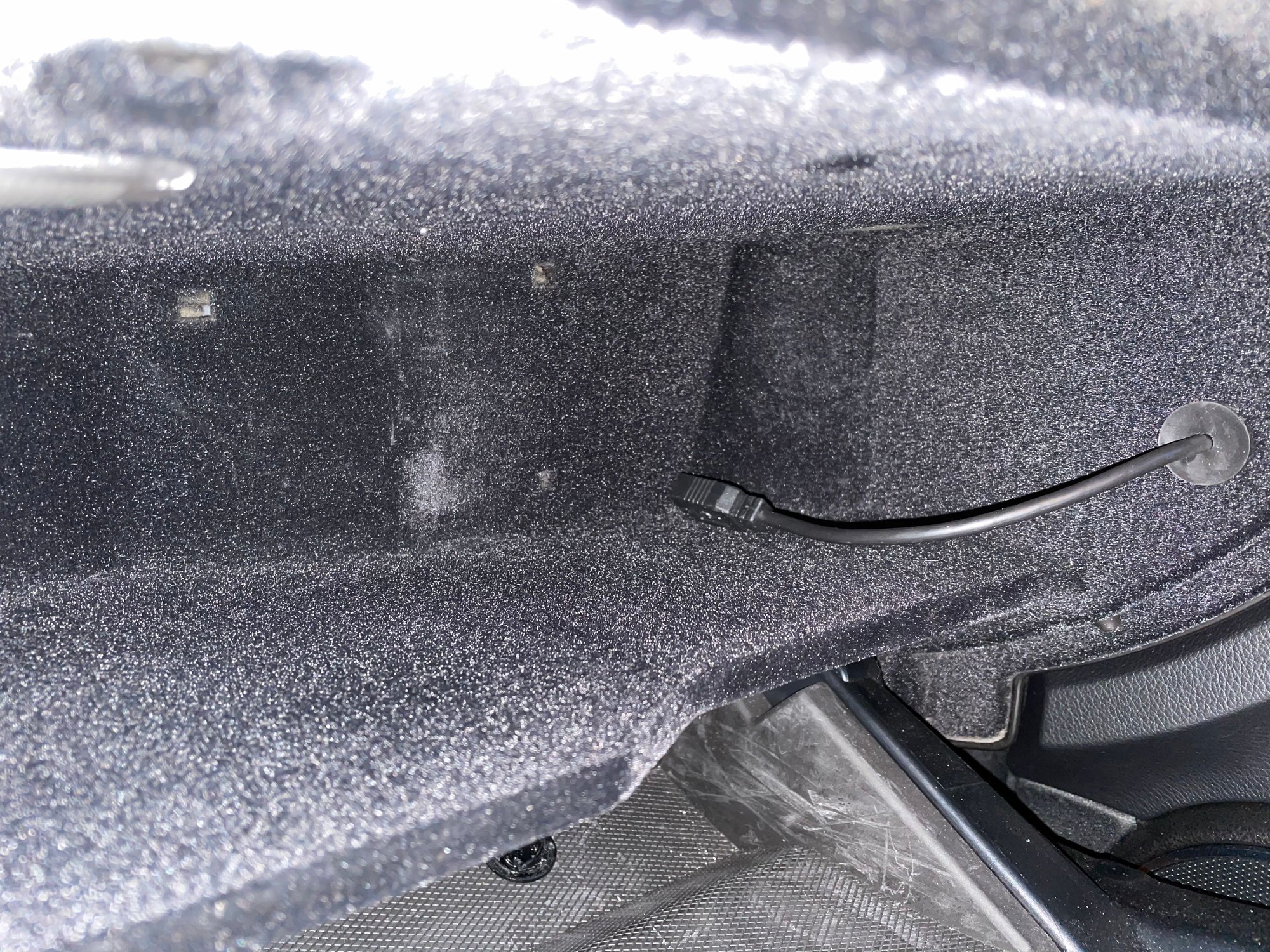

USB cable in the glove box

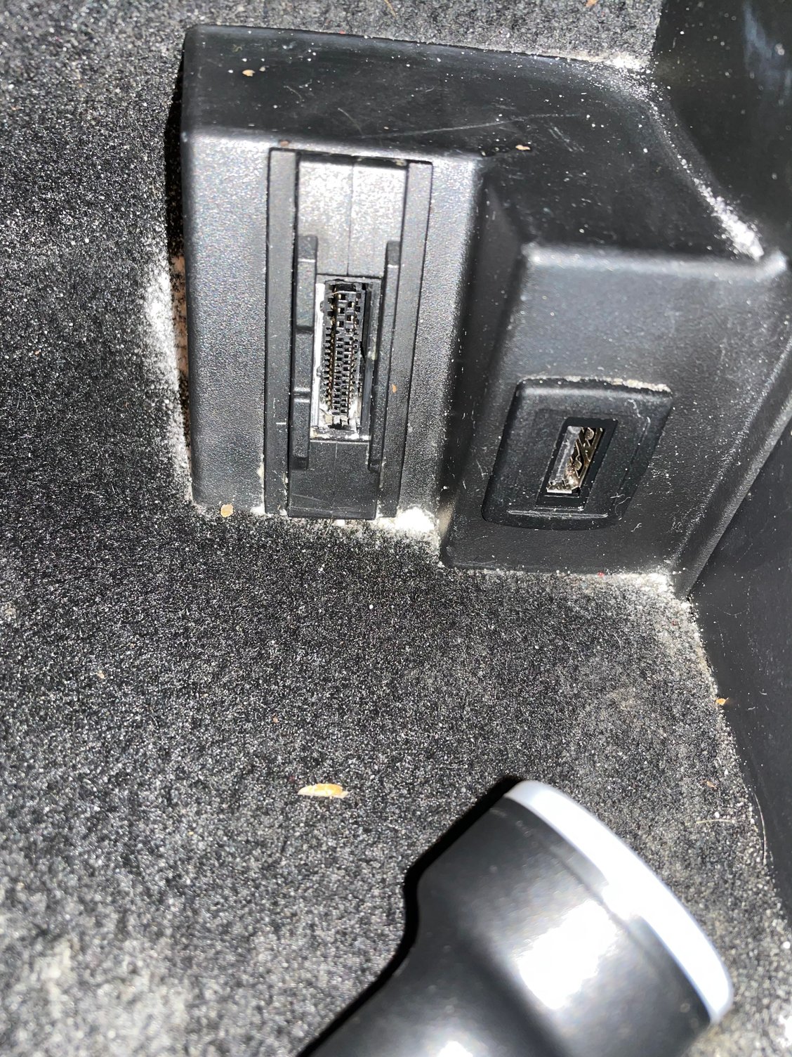

USB and another port in the center console

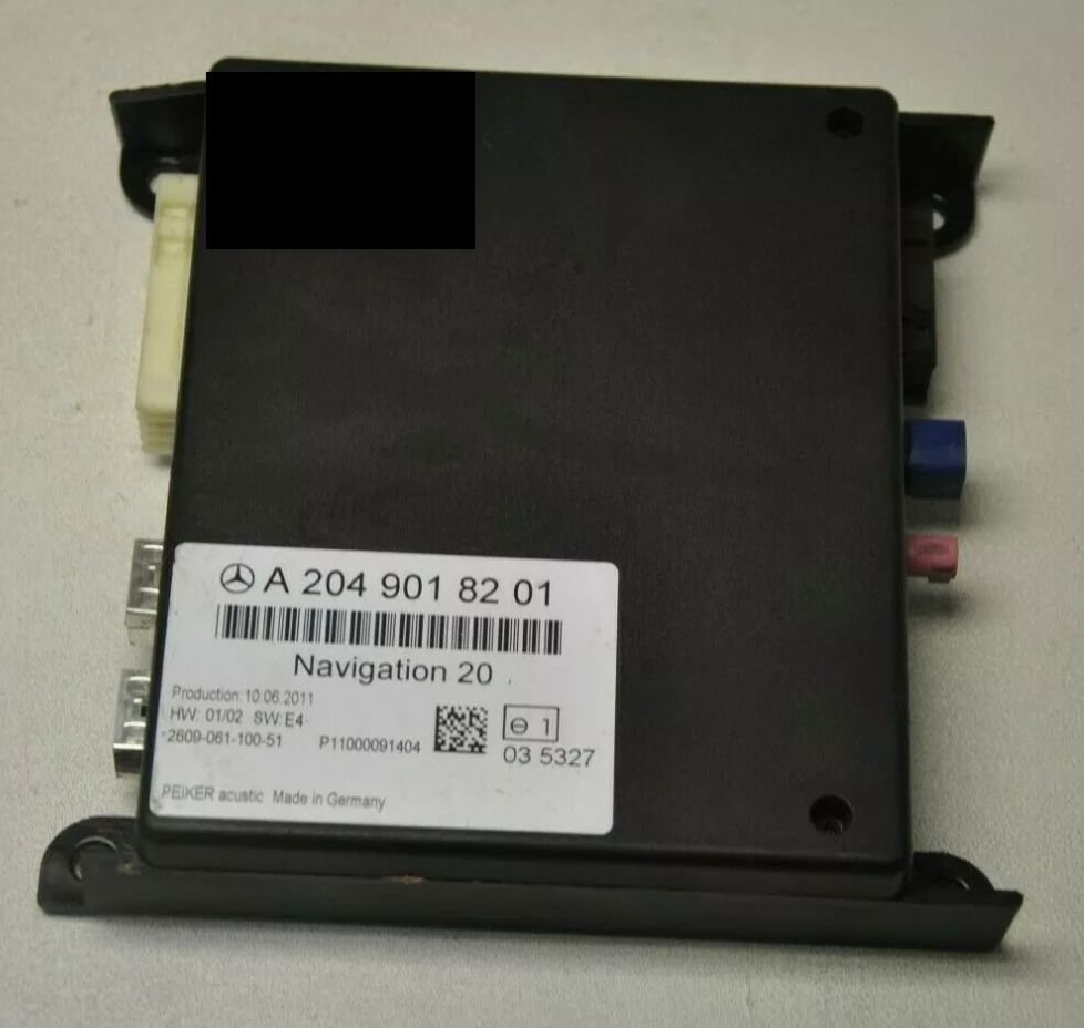

This is what I need to see if my C300 has.
