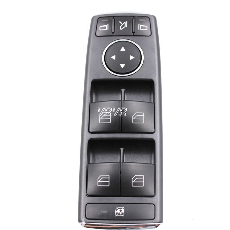

The switch unit in the door is quite inexpensive - $26 on EBay. Wonder what else one would need?

you will need door control modules, power folding mirror frames, and the switch unit in the door as noted above, then have someone put code 500 into the VEDOC at Mercedes, then get it coded into the car

Would the door modules be different (hardware) or does the circuitry in there already handle a different signal coming from the mirror switches?
Could I get a couple of used Canadian-model side mirrors and, heaven forbid, switch out the frame/motor elements into my USA mirrors?
And, finally, what is VEDOC exactly? A database of all the enabled features for each VIN? Thus associating code 500 with my VIN would 'authorize' this feature, so that it can in turn be downloaded into the car's computer/electronics as a supported feature?

Mercedes and a lot of other manufacturers use LIN and CANBUS for its vehicle electronic systems. The door control module, in this case takes the signal from the folding mirror command from the switch, sends it to the module, which sends it to the power folding mirrors.
As far as VEDOC, Mercedes maintains a database of all the installed options for each VIN. In order to get a new retrofit to work, you have to have someone capable of submitting the requests into that car’s VIN by adding the particular option code. One the Mercedes database is updated, you can then fo to a shop to have the car SCN coded for that option to be activated. Very cumbersome, and very frustrating, but can be done
