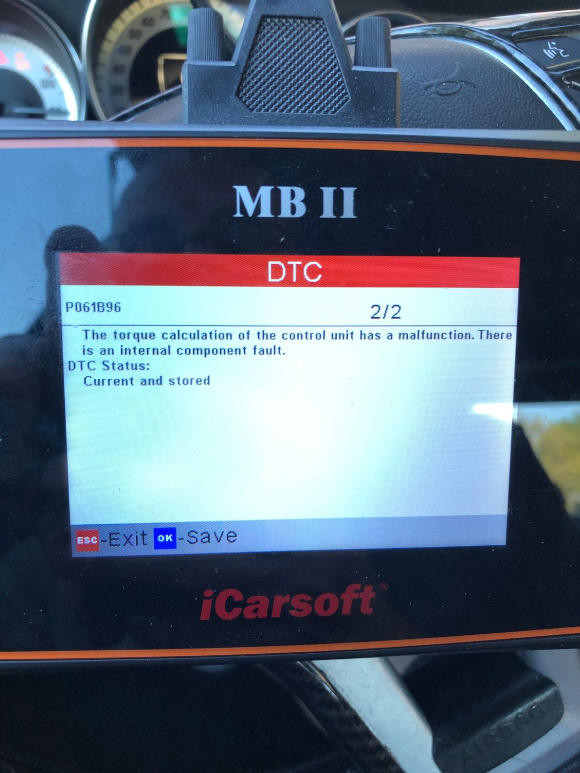

Code P061b96
Some videos talk about gas pressure and some talk about camshaft.
what is it exactly and how to tackle the issue

Fix the P034062 error first and recheck. Change the intake cam position sensor. No need to get the MB sensor. The Bosch part number is on the OE one and much less expensive. BTW — P034062 is also associated with the camshaft adjuster failures but the description is different.
Unusual that there aren’t 1 or 2 underlying codes with the P061b96. The description sounds like an ECU internal failure, but other bad inputs may trigger this. Some P061b codes are triggered by sensors on the transmission conductor plate. Not certain about this exact one. Maybe look at live data from the transmission and look for a missing input from one of the sensors. It’s a quick check that I think your scanner can do.

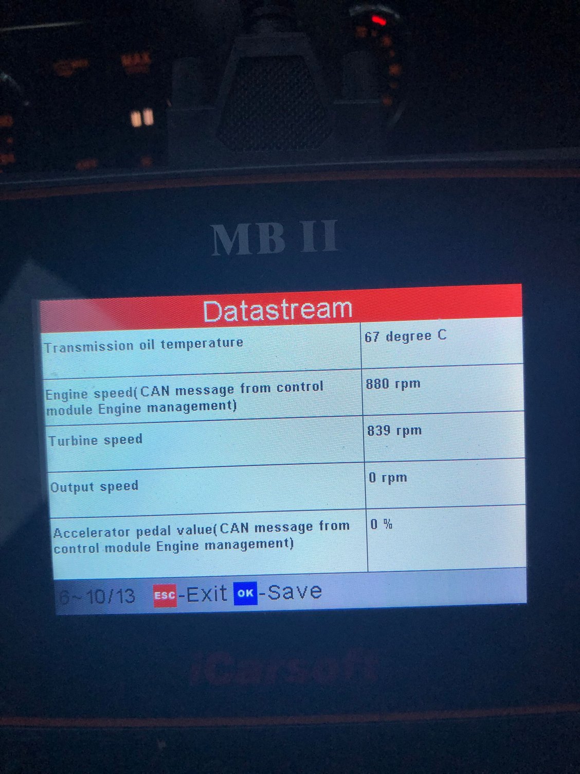

A while back I switched the exhaust sensor with the intake one to check whether the sensor is bad, however the code p0340 retuned.
I’m hoping still the sensor and not the adjuster.

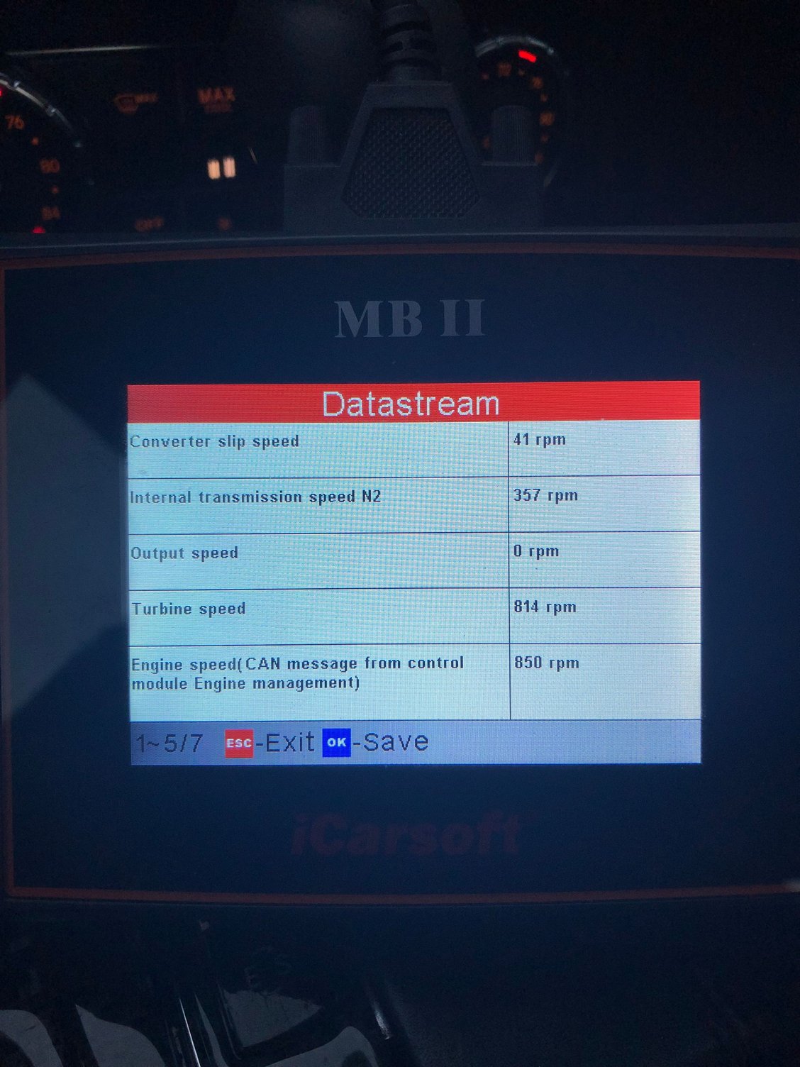

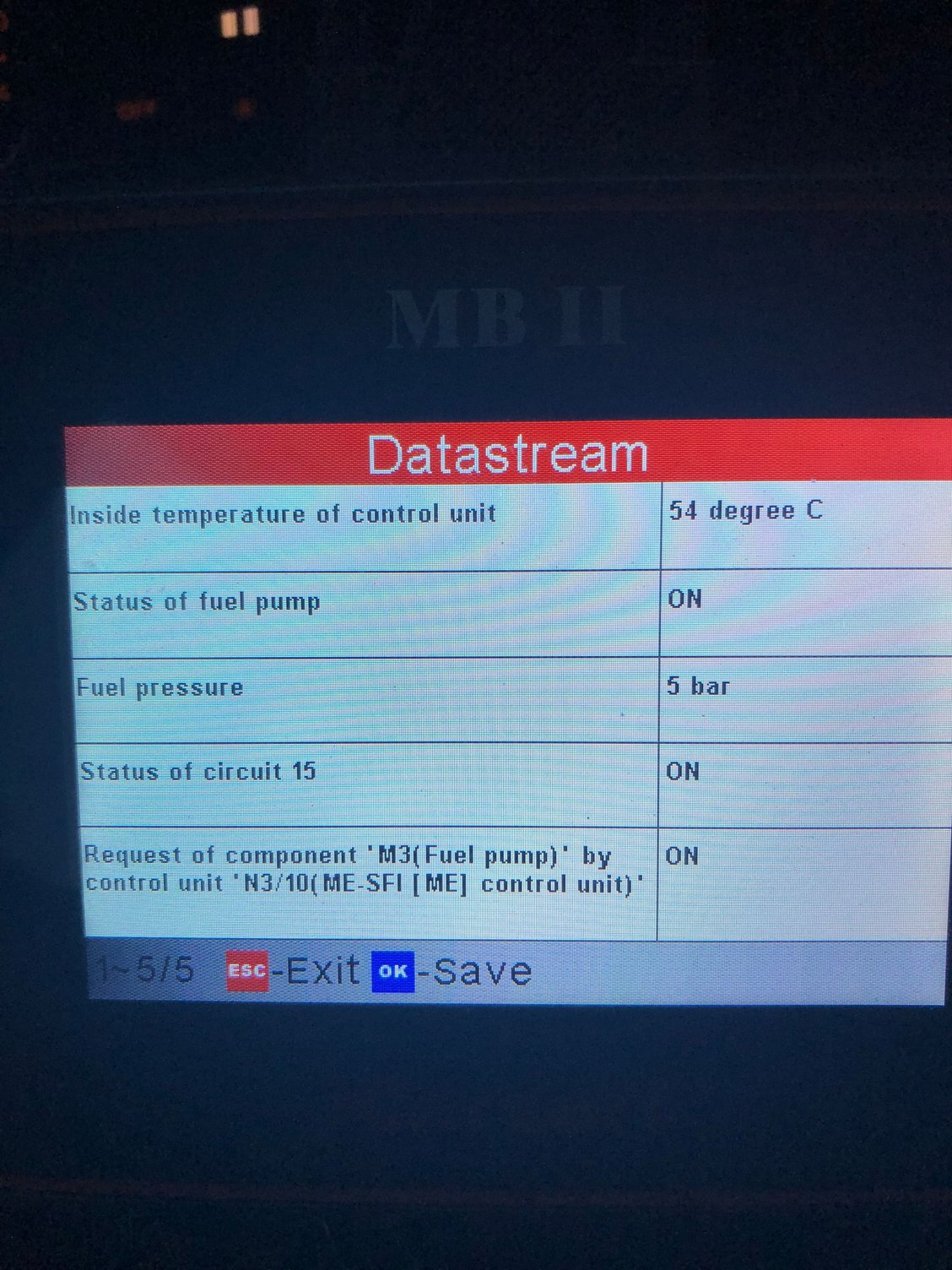

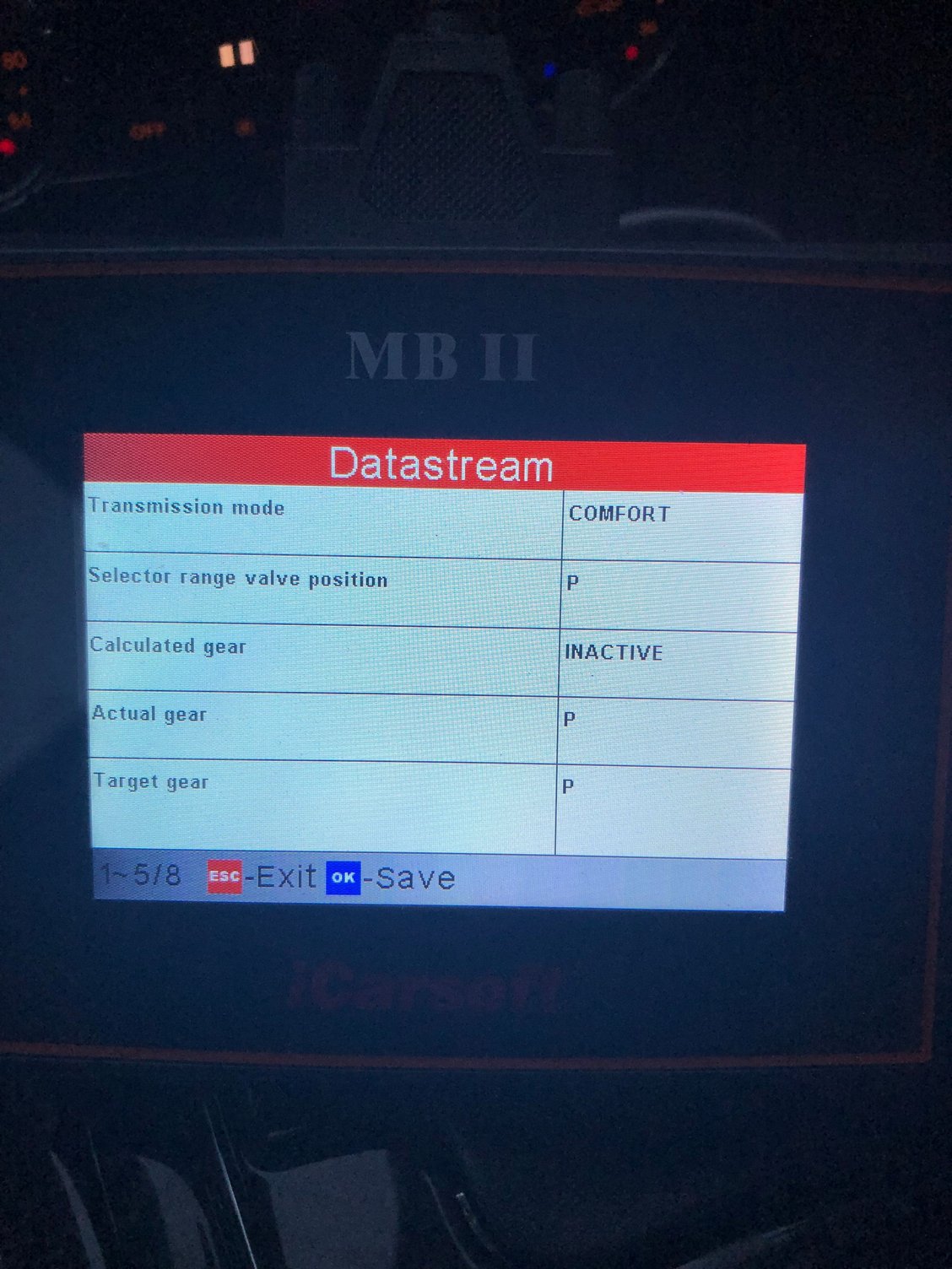

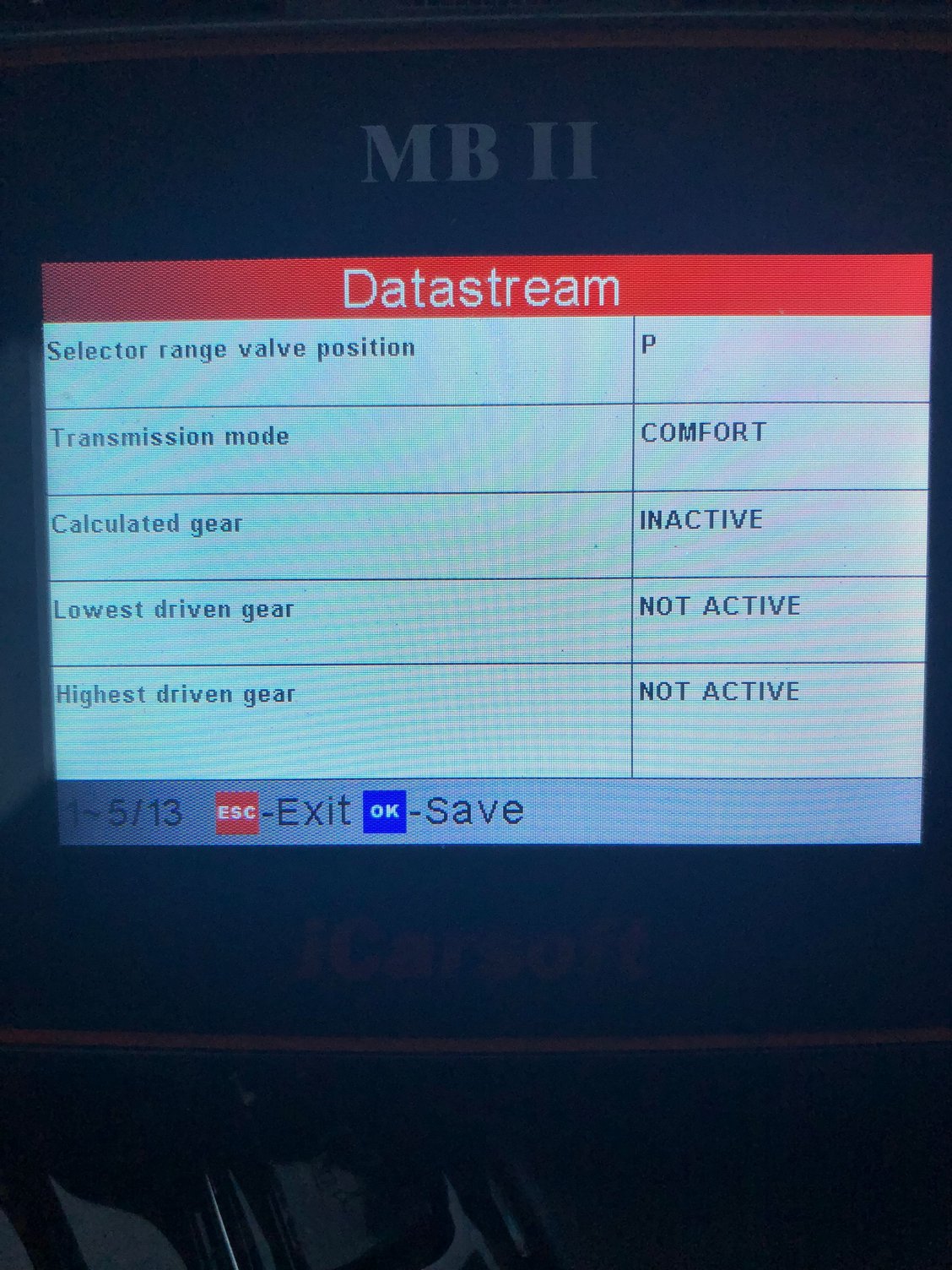

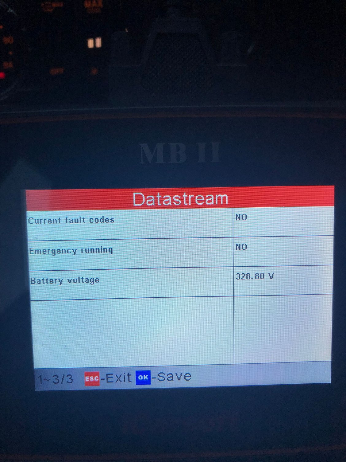

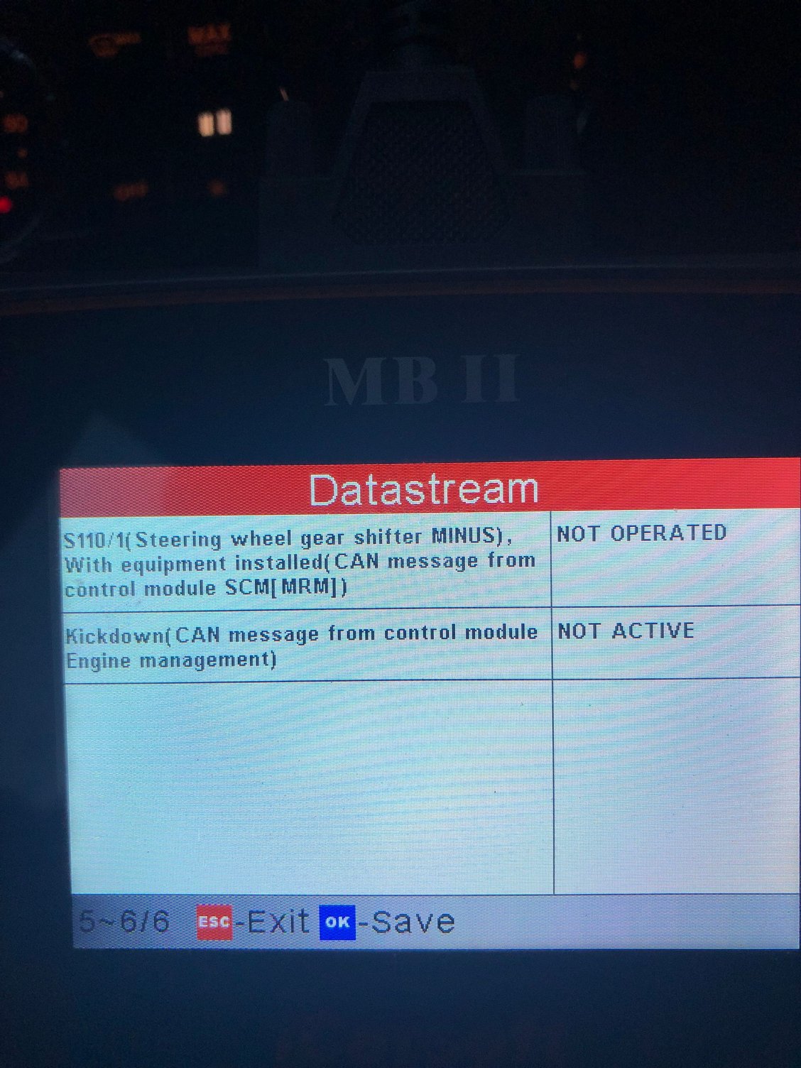

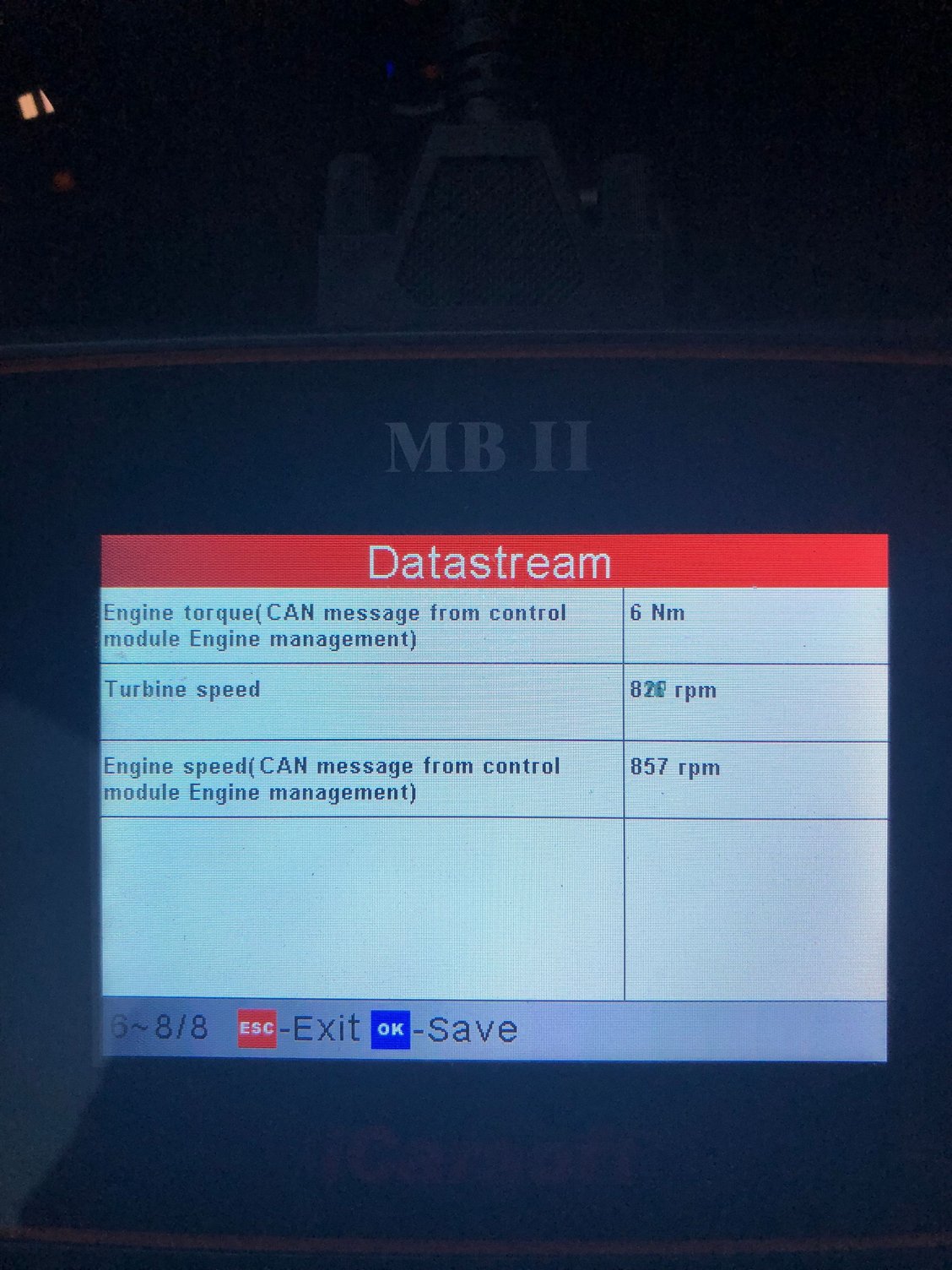

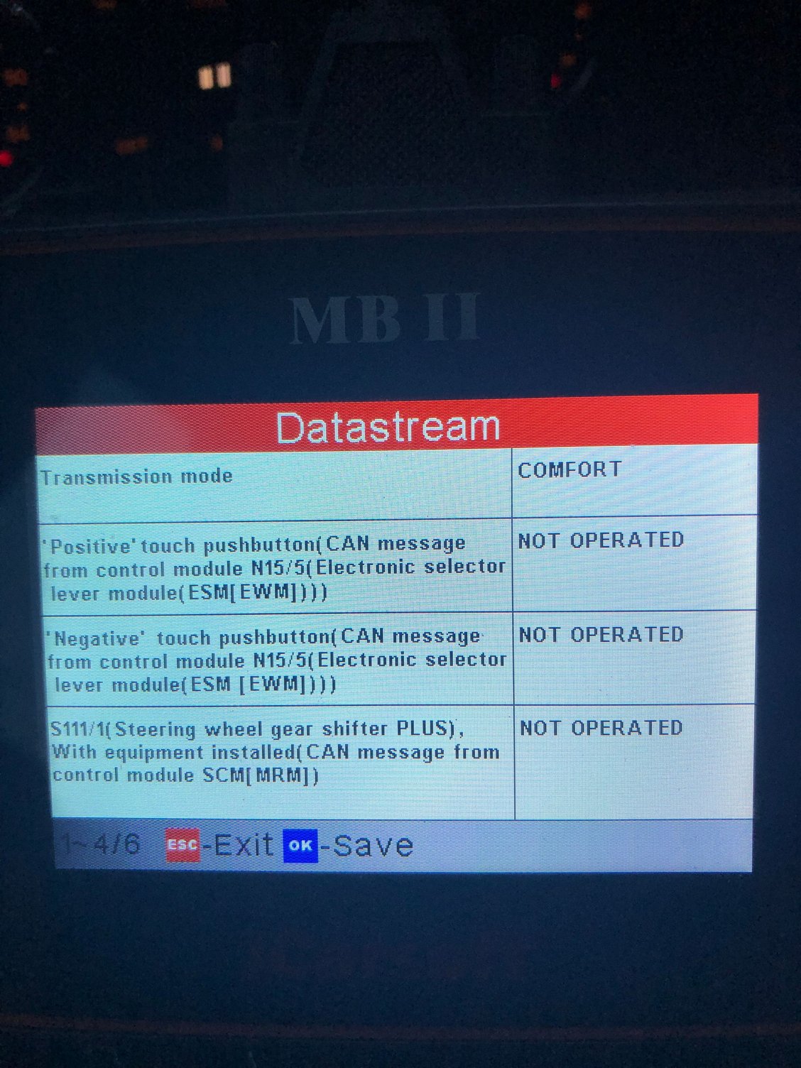

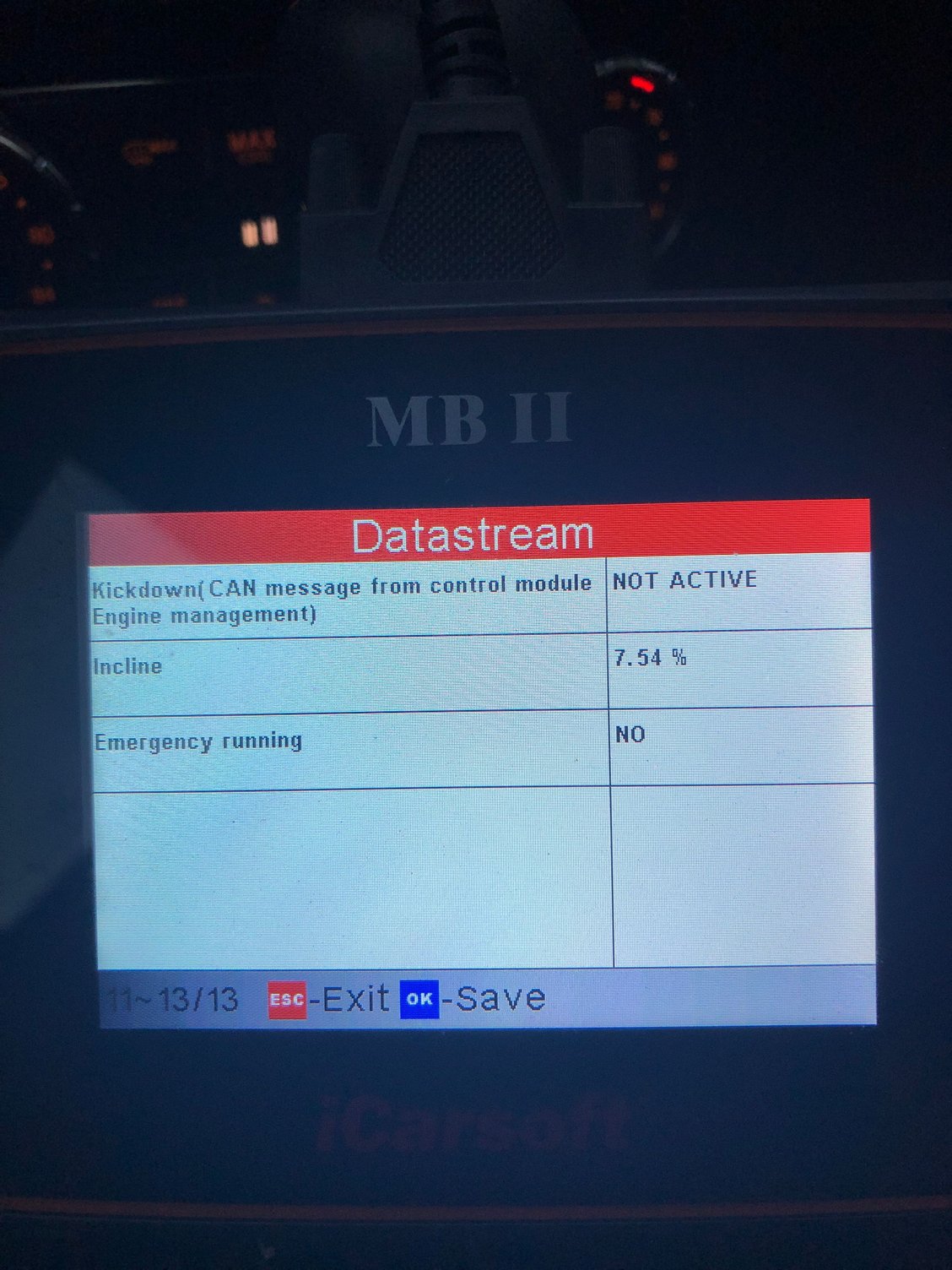

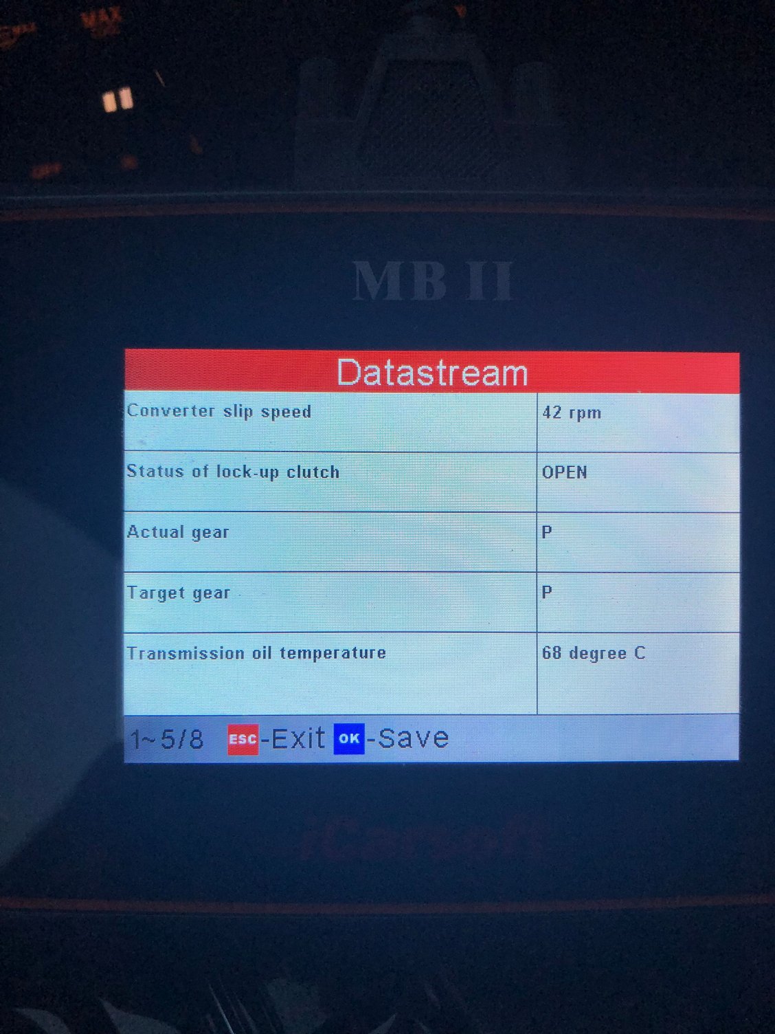

Would you check the images below to see transmission data

It looks like all 4 inputs are there. N1, N2, N3 all give readings. N4 is 0, but you can’t drive the car with the scanner connected. A bad sensor usually outputs some impossible value or no value, not zero. There are also no codes stored and no implausible warnings. The transmission looks okay at first glance. The ECU is also calculating a torque value. That leads me to think the problem is in the ECU itself, but I don’t want to jump to that conclusion without an actual MB Tech chiming in. Have you tried clearing the P061 code?
Since you swapped the cam position sensors and the DTC didn’t move, then the indication is correctly associated with the intake side. If you’re not having the hard starting and the rattling that go with cam adjuster failures, you may have a wiring harness or connector problem.
