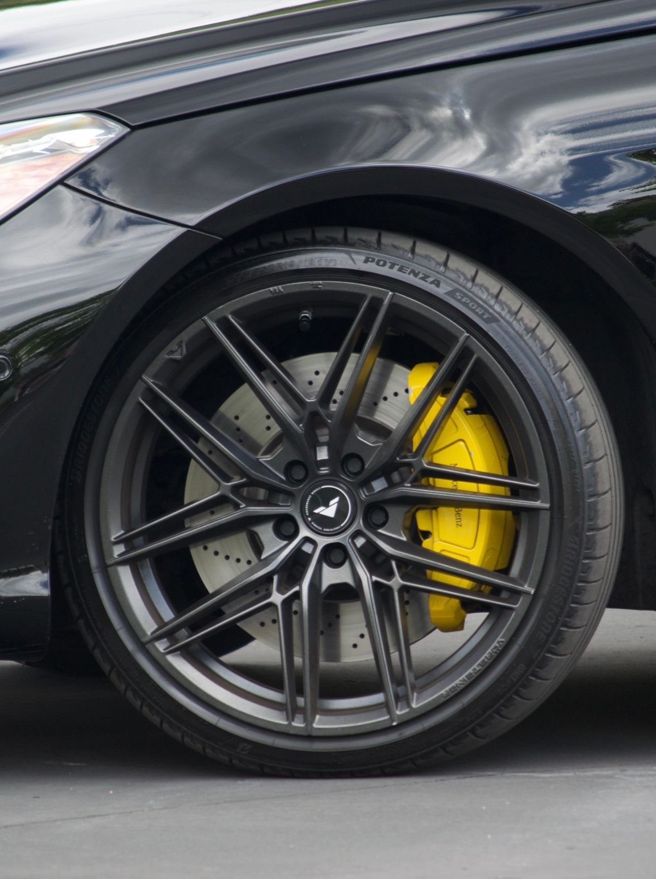

New update, the rotors you will need to work with these calipers are the 360 x 36mm Rotors off the C63. I bought the Brembo rotors off rockauto (it was cheaper than the Zimmerman from FCP Euro). Also, make sure you don't make my mistake and ordered brake pads for the C63 (I am so dumb), you need brake pads for the CLS550/E550 calipers. The C63 brake pads don't fit at all.
Are those spacer because the type of wheel you got?... Will normal 18 inch wheels will fit or we need spacers?...... First post btw...be gentle ....lol
Old Sep 26, 2024 | 04:50 PM
romeo291's Avatar
Joined: Mar 2013
Posts: 420
Likes: 38
From: NC
W204
Yes, those spacers are on there because my wheels didn't clear the calipers. In your case, it's going to really depend on the type of wheel design you have, because some of the OEM wheels will clear it, but some won't. You will need to look at the concavity of your wheel design and see if it's BBK friendly.

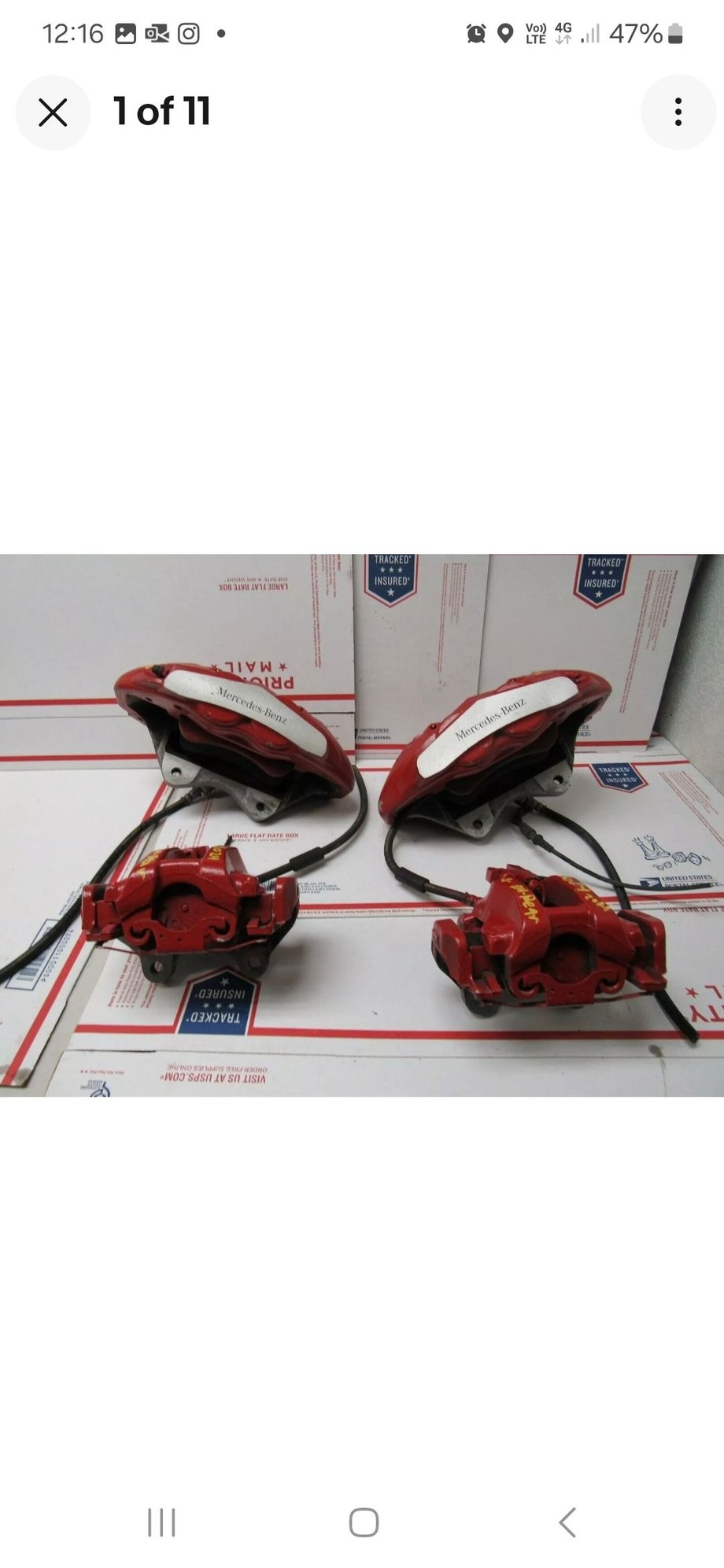

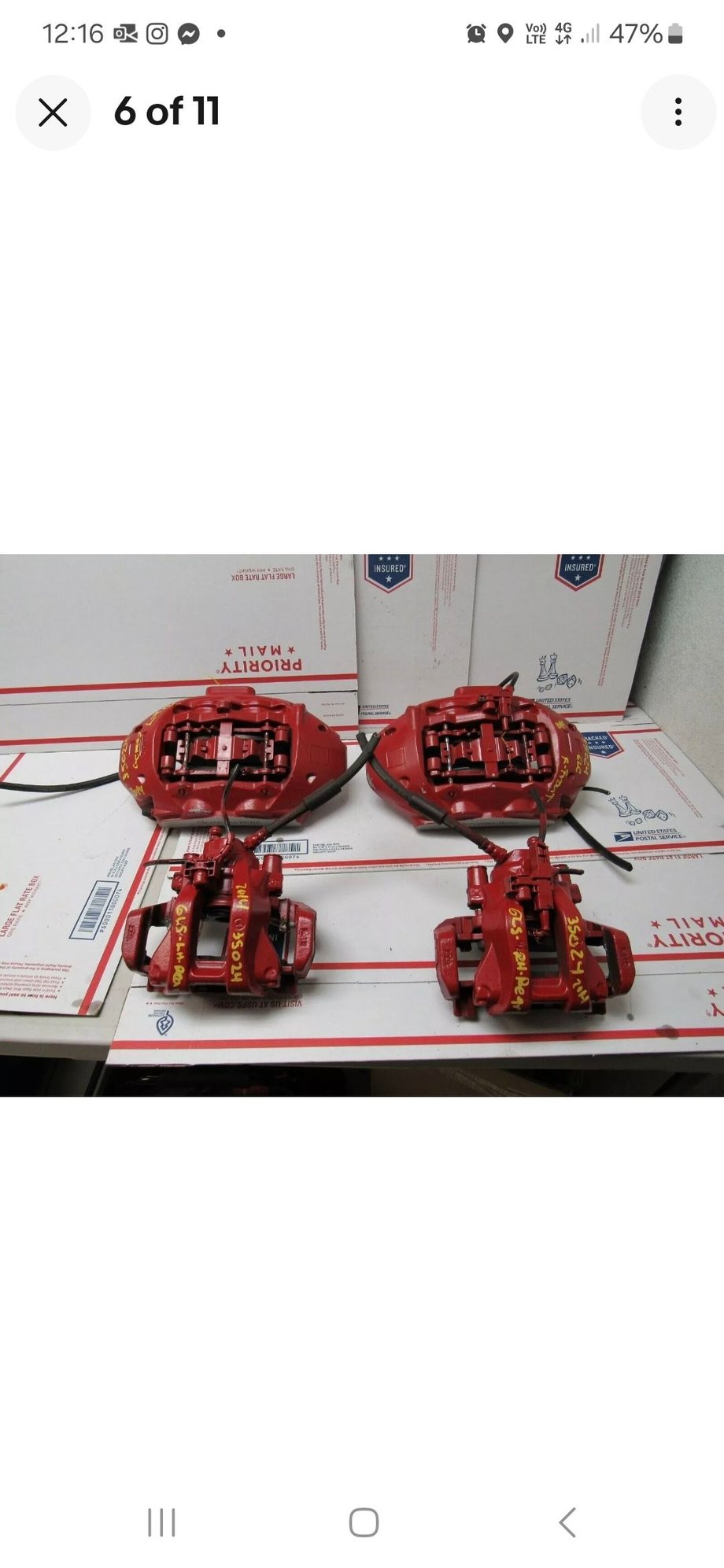

US/Left hand drive CLS550 Brake Calipers on RHD w204?
Hi all,
Does anyone know if left hand drive cls550 calipers will fit on a right hand drive 2011 c200 w204?
I believe the fitments should be fine as discussed above, but am unsure regarding the different drivers side and connection/sensor locations.
Also trying to still find out if the calipers are from a 4matic or rwd, I believe it was a rwd tho, I have attached some photos.
Any feedback is appreciated, thanks

Pretty confident connections will work after comparisons, just unsure if the rear calipers fit the w204.
