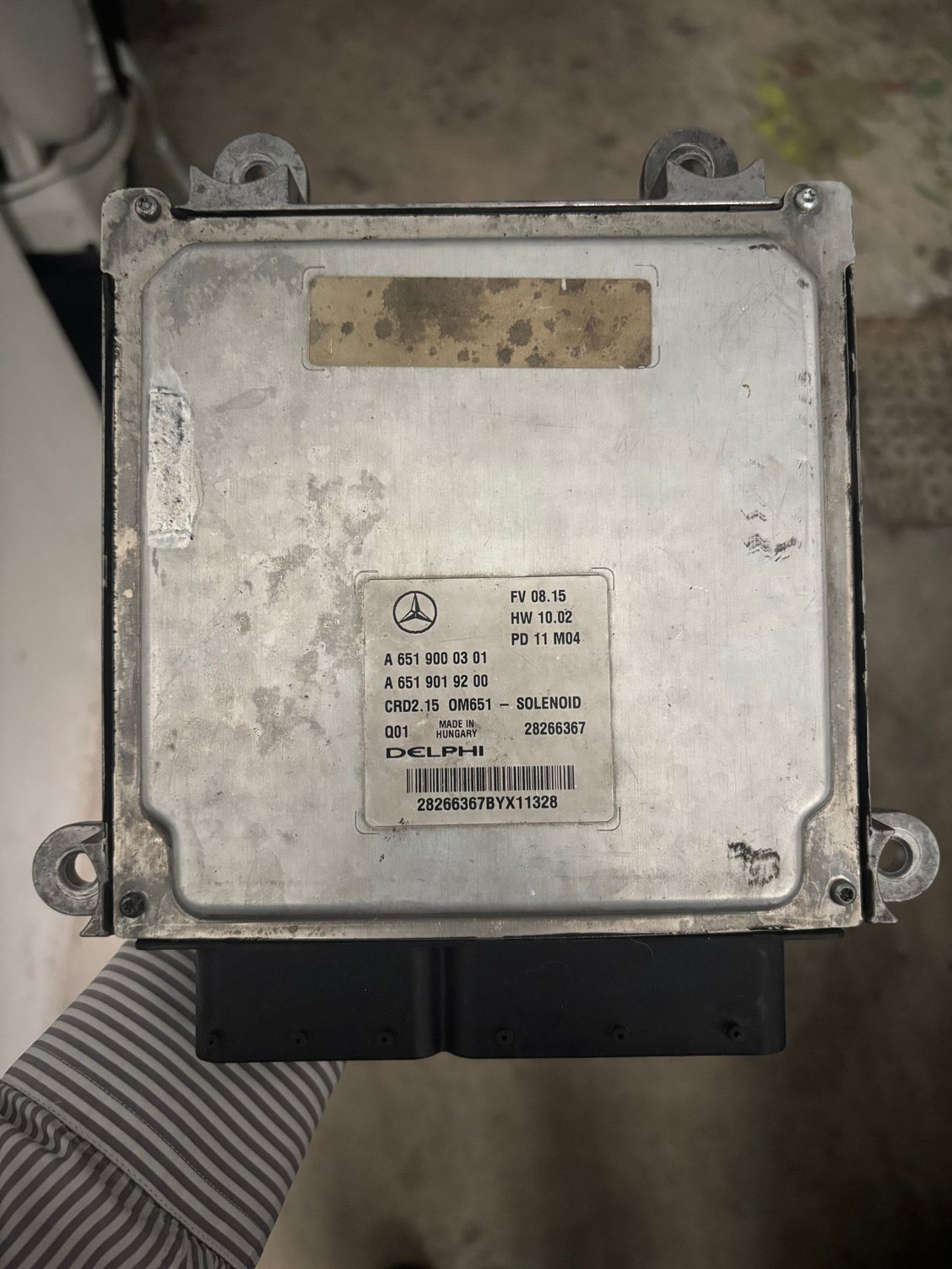

Hi there
Yes, I resolved the issue by purchasing a second ECU from a wrecker and cloning the old ECU data to the donor unit. The problem is now solved.

Good morning, and thank you for sharing this!
Unfortunately, I did the same thing about a year ago, but the problem was not solved — in fact, it got worse. So I thought I had simply been unlucky and bought another SAM with the same issue. I then sent the new control unit to a center that analyzes these components, but they told me they could not find any problems…
May I ask whether the system migration from the original control unit to the new one was done automatically/in bulk or manually? I’m starting to think that the bug is actually in the software and that it may have been transferred to the new unit as well.

Have you tried a different SAM controller module A2229009808 ?
Hello,
the SAM module controller has not been changed. As I mentioned, the ECU was changed instead (I’m attaching a photo).
Are you asking this because, besides the ECU, you also replaced the SAM module controller?
Thank you.
Old May 11, 2026 | 08:48 AM
bm2amb's Avatar
Joined: May 2023
Posts: 15
c220
I had an ECU issue similar to yours. We initially replaced the SAM module before replacing the ECU, but the SAM module didn’t resolve the problem.
Once the ECU fixed the issue, we reinstalled the SAM module to its original state.
Old May 11, 2026 | 09:03 AM
Gianfranco2697's Avatar
Joined: May 2026
Posts: 4
W212
understand, very clear.
If you were advised to replace the SAM module, it’s evidently because it’s part of the circuit and could be the cause of these errors. I could ask my mechanic to try this.
Do you remember whether the replacement SAM module needs to be programmed?
Old May 11, 2026 | 09:08 AM
bm2amb's Avatar
Joined: May 2023
Posts: 15
c220
I can't recall 100%, but i don't think needs to code SAM.
also i have replaced the engine main relay, injection relay.
