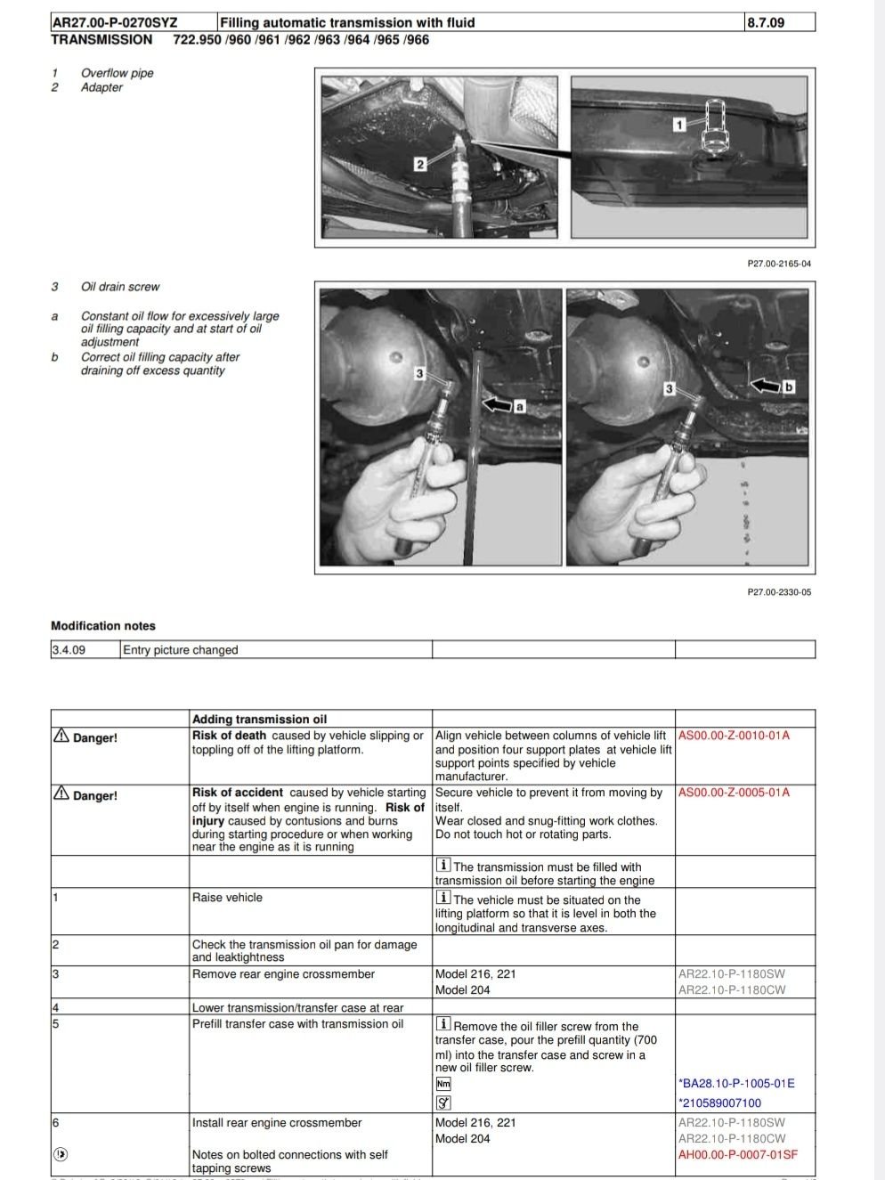

I have a question about what is the difference between the 722.9 transmission vs the 722.96/97? I came across some documents on filling the automatic transmission and they say "Transmission 722.9 (except 722.96/97)" Under Vehicle Information on my car it says I have transmission 722964 02 534269. Is there something different I need to do when filling the trans fluid instead of just the normal 722.9 instructions?

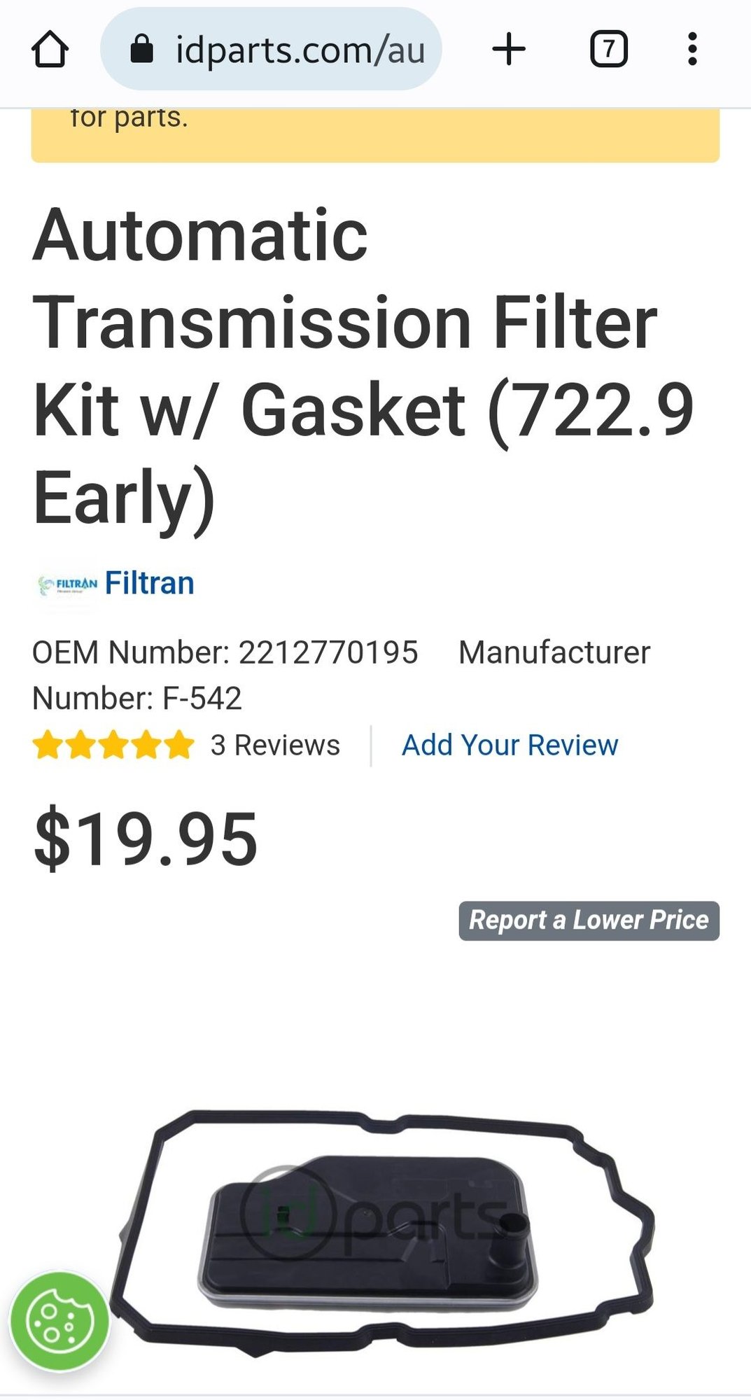

And I found this transmission filter and gasket kit for a good price. Listing says Filtran is the OE supplier. When i look at photos of a Mercedes trans filter it looks like Filtran is printed on it. Comes with Elring gasket. ID Parts is in MA and in the next town over from me so I pick up same day for free. They only deal with diesel Mercedes but they carry some parts I need like for the trans.

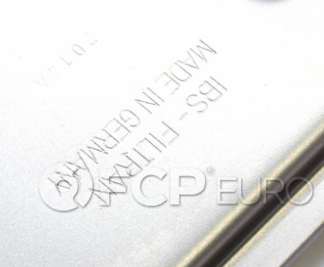

I looked up my vin on a few difference places and they all say the same. transmission 722964 02 534269
Im not going cheap, im going with the best price. Filtran filter with Elring gasket for only $20. When I look up mercedes brand filters they are stamped Filtran, so why wouldnt I just get a Filtran filter? It would be foolish to spend an additional $20 just to have Mercedes printed on the same filter.
Mercedes Filter with Filtran label.
Your transmission is 722.964. These fill instructions look appropriate:
https://www.weistec.com/forms/weiste...ervicedata.pdf

I found some instructions for my 722.964. I'm thinking it's due to the 4matic and having the transfer case. The instructions mention lowering the trans/transfer case and prefilling with oil. Think the instructions are written in a way as if its never been filled before. Mines obviously been filled. Good to know theres a fill on the transfer case.
8-18 is a little confusing. says pump in 6 liters, shut off, then start and add 4 more, but theres a note for filling what has been drained +0.5 liters. Ill have to sit down and digest what it's saying.
Excellent! And I agree. If you can get an OE or OEM part, especially one with "Mercedes" stamped on it, and save money, you should. I use aftermarket brake pads and trunk/hood struts to save money. But those things won't cost thousands of dollars if they wear out sooner, but when it comes to filters and fluids, I stick with Genuine, OE, or OEM parts.

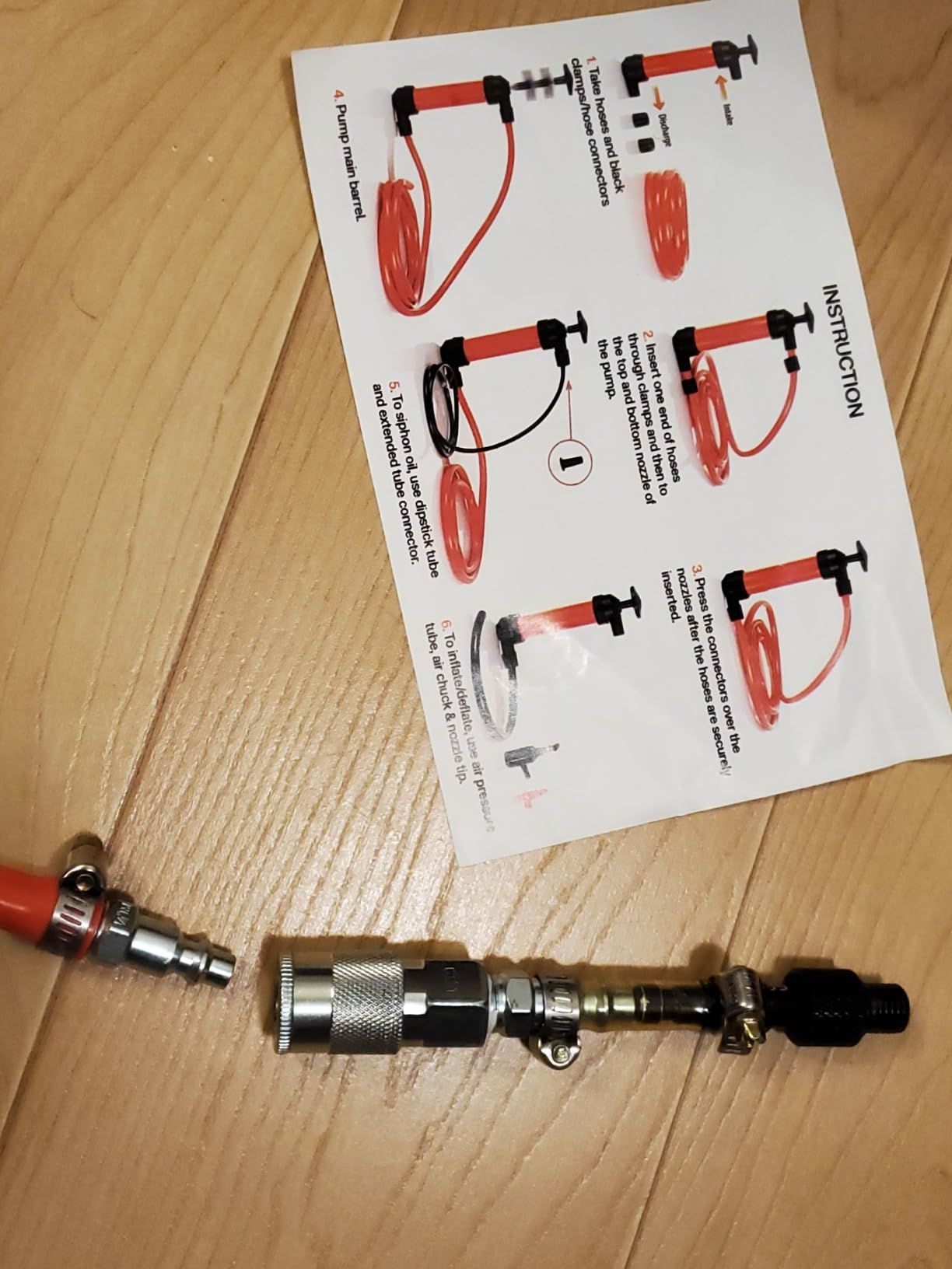

I'll be doing it soon on all 3 of my cars, this is the pump I got, comes with appropriate fitting for MB
https://amzn.to/3OWpBJU

I have a nice ABN brake bleeder pump but its had brake fluid in it. They have a 2 gallon sprayer at HF for $12.99 and I want to go there anyway to get a 1/4 torque wrench for this project.
Figure this can hold all the fluid and no need to stop and refill.
For the front differential i used just a cheap transfer pump, worked very well and fast. I did clean that up with soap and water but still dont trust reusing it for trans fluid. I had some quick connects laying around so just used those instead of getting a shut off valve, have the female end on the atf109 adapter side so when done pumping just disconnect and the fluid doesnt drain out.
Just disconnect when done pumping, fluid stays in while getting ready for next step.
