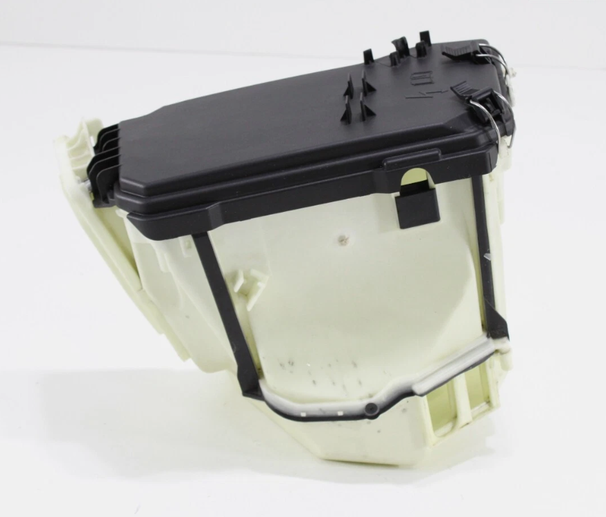

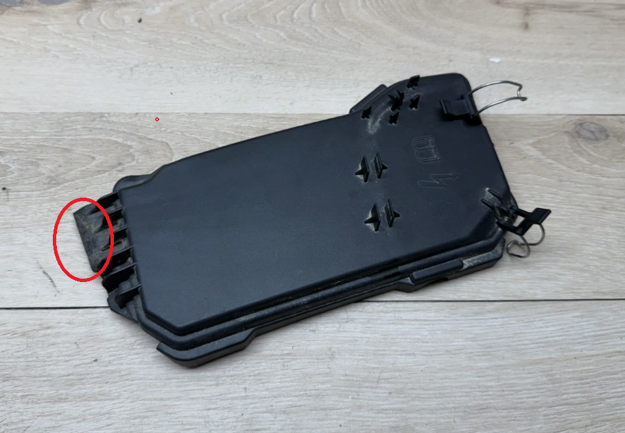

Wondering if some people dont know how to put the lid back on.
Its pretty simple once you figure out how its supposed to work. Angle the lid back on so the edge at the rear slides into the top of the box and push it all the way, then push the front of the cover down and everything should line up. Hook the two clips at the front and she should be sealed.
I was recently inspecting my lid after checking the fuses and the gasket looks great still. I have seen some used lids on eBay when looking around and the gaskets on them look flattened or couldnt even tell there was a gasket there. Something like that i would go ahead and get a new lid. With all the threads ive come across with front sam water damage im paranoid with mine.
