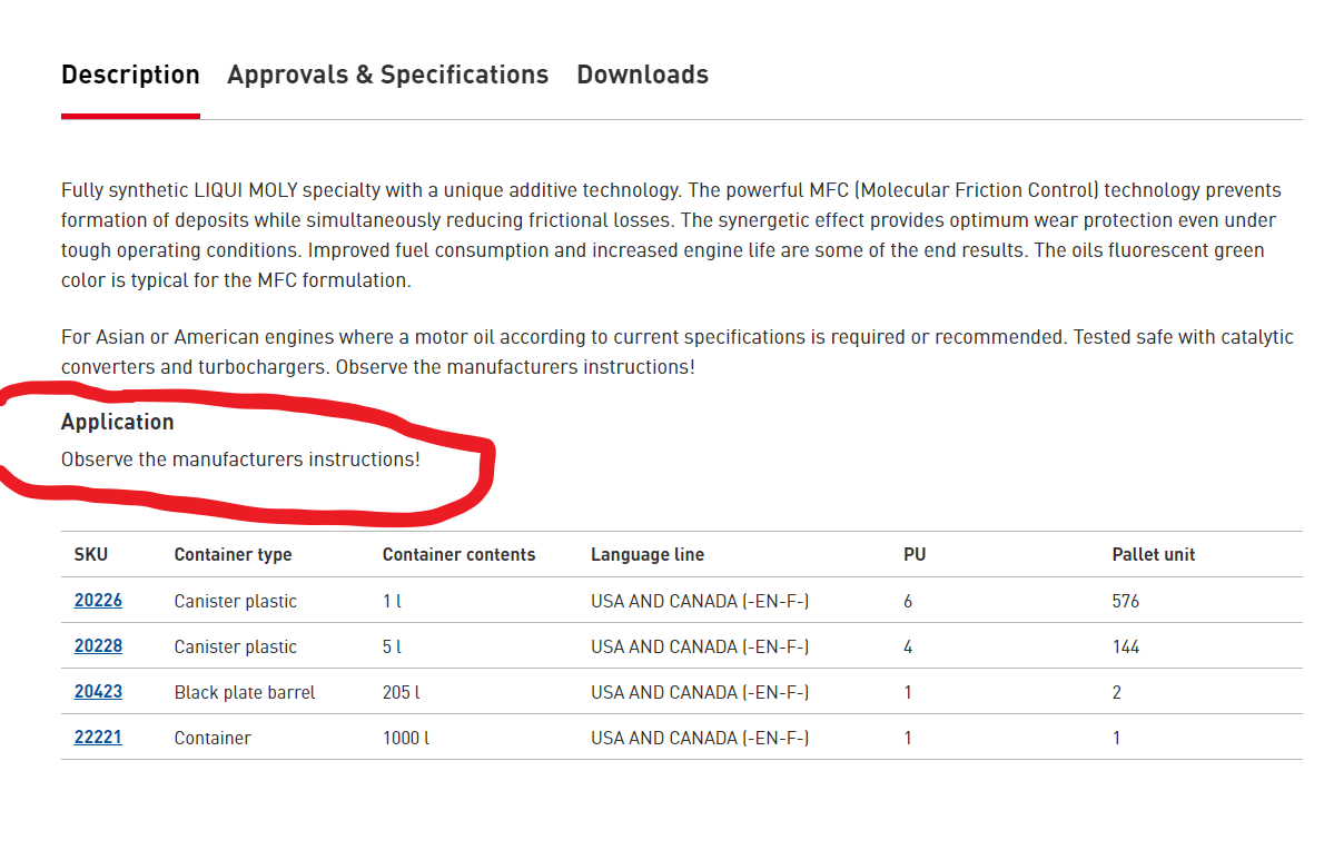

I looked up the Liquid Moly 5W30 green bottle and do not see it being approved by Mercedes. But there is another 5W30 that is.
Is it bad to use non approved oil, I dont know. But I like to keep it simple so theres no guess work.

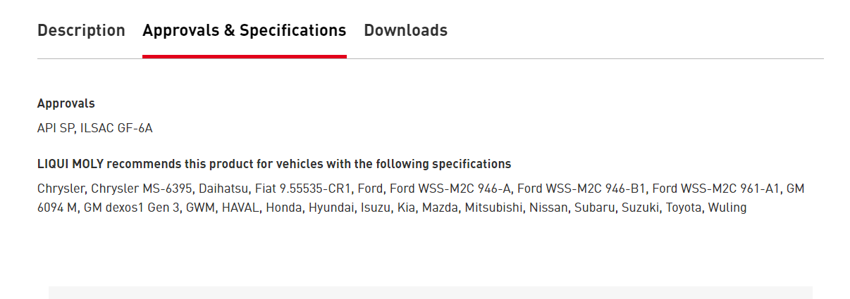

Liqui Moly recommends it for 229.5 applications but doesn’t have the actual approval. They do have approved 229.5 oils, so that’s a red flag to me. I would want to see that it had zinc and phosphorus levels equal to their oils that do or to the Mobil 1 Euro before using it.
Anything else is an experiment at the risk of your engine.
Old Mar 14, 2024 | 08:16 AM
Just204's Avatar
Joined: Jun 2016
Posts: 562
Likes: 75
Mercedes w204 4matic sport
To my knowledge that oil is not approved for our cars. They have a couple oils approved though. I will only use an oil approved by MB, I don’t know why it’s not approved but unless it is I wouldn’t use it. Not all oils are right for our cars. If I remember though it’s supposed to be orientated towards turbo cars. This is a couple years ago but this is direct from MB;

Here's the approved operating fluids website by MB. - https://operatingfluids.mercedes-benz.com/sheet/229.5
It gives all the approved oils for each spec requirement. You can toggle it by clicking the oil icon in the top left corner of that page depending on what your car requires.
Liquimoly is on the 229.5 approved list but not MolyGen specifically.
