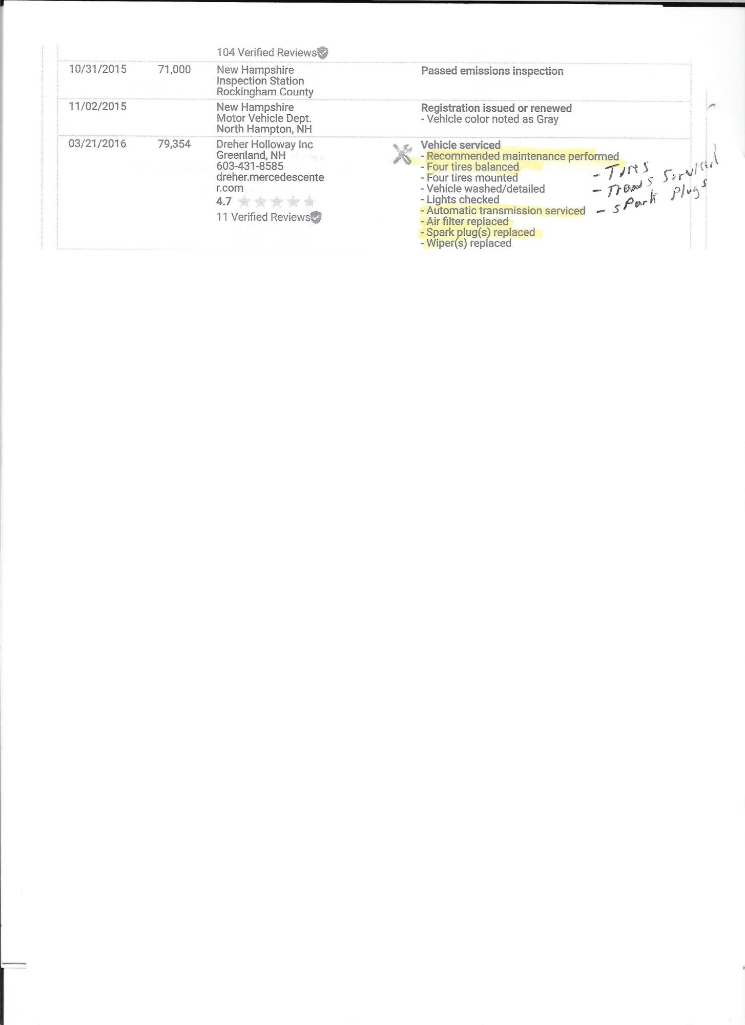

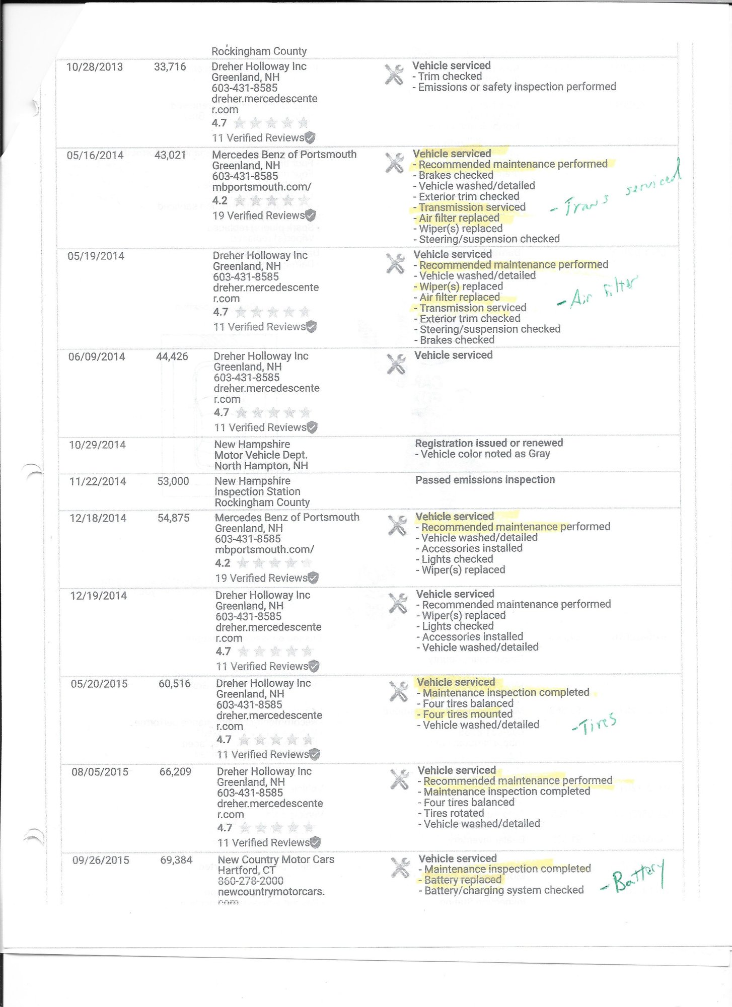

I'm going to say the trans was not done. I'm basing this on my car came with a Carfax that lists its service records. While it is not that detailed it does list things like trans serviced, battery replaced, tires etc. I'll attach a copy so you see what mine looks like.

those are generic itemizations. It could have just been a courtesy inspection, I took mine in for the sub frame inspection and a nys inspection, they reported similar to your car fax. If an oil change is done it should itemize something like “oil and filter changed” or “tire rotation performed” a tranny service should show as its own itemization like “transmission serviced” or even possibly “oil and filter changed”. If the carfax doesn’t show along those lines I’d suspect it wasn’t done. Check the pan bolts to see if they look newish, also there was an updated oil pan for the 7g trans. They would have replaced the original with a new one so if the pan looks old that’s another sign.
