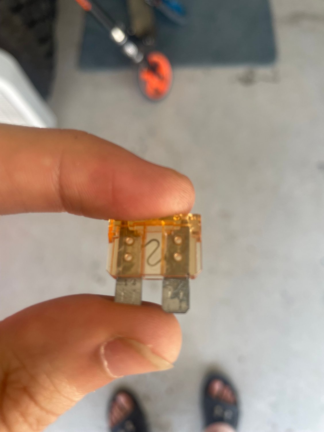

I would double check fuse # 16 in the front under the hood. That is the fuse for the OBD port. Test it with a multi-meter.
I would not be surprised if water got into the front sam and is causing these issues.

Not sure if I have one of those, but looking at that fuse again it does look like it’s about to give. You can’t see in the photo but the fuse itself looks a little singed

Not sure if I have one of those, but looking at the fuse again it does look like it’s ready to give, you probably can’t see it in the photo but the fuse looks a little singed at the top
