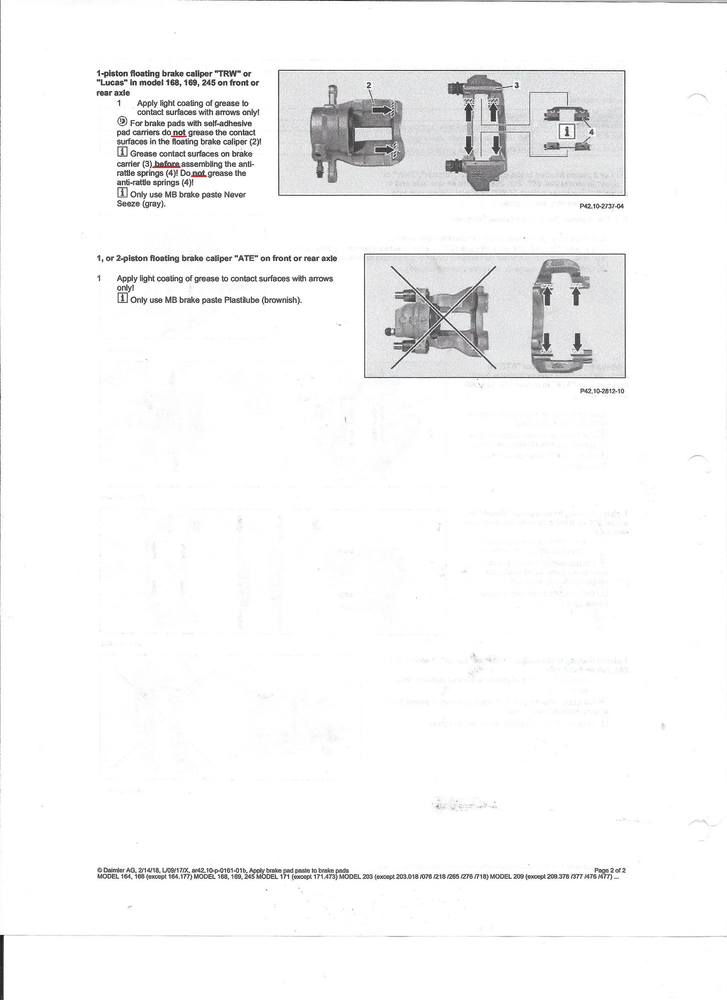

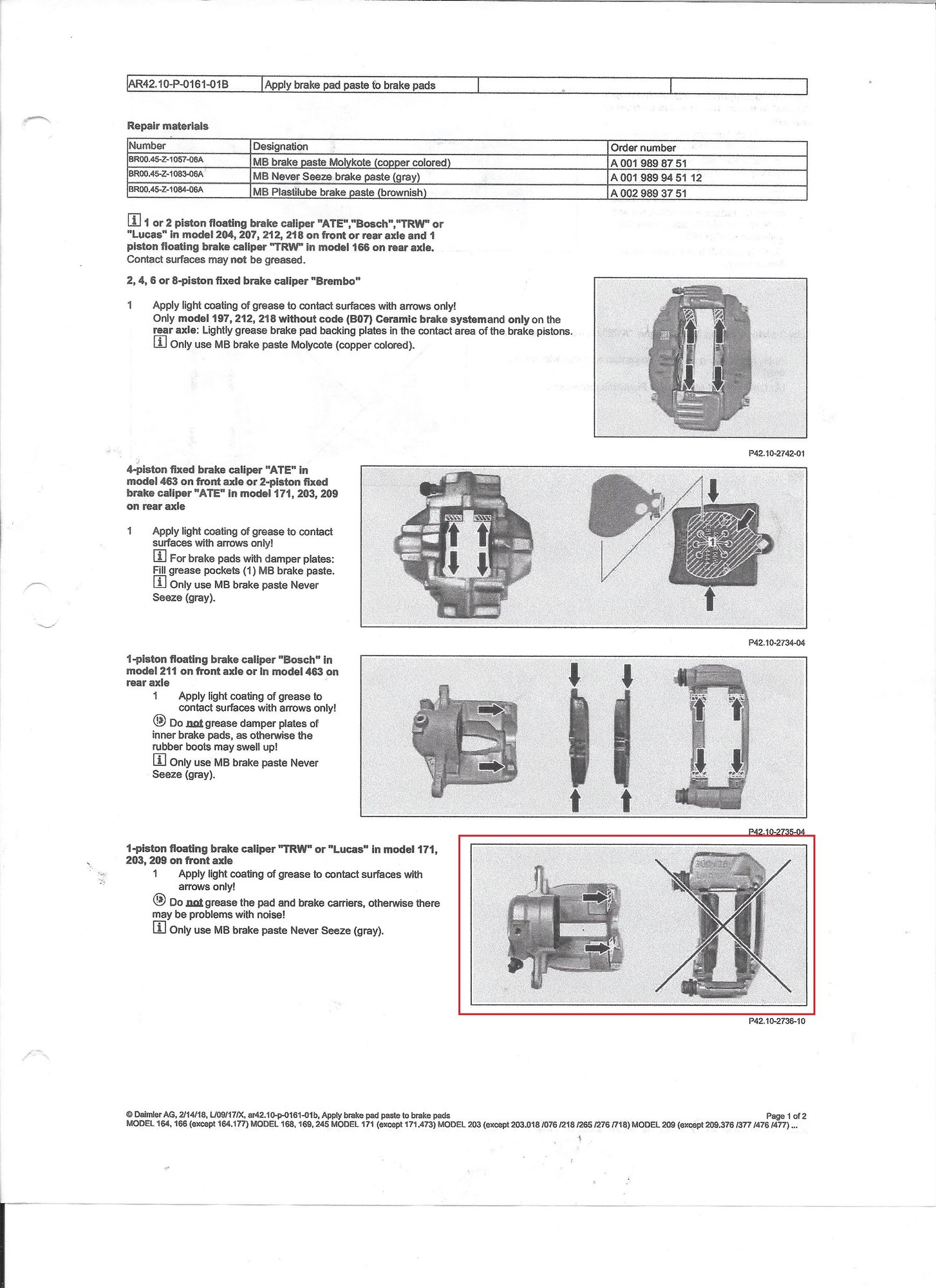

I followed the sheet below for where to grease. I put grease on the front calipers UNDER the anti-rattle springs. No grease at all on top of the anti-rattle springs where the pads ride. And because the pads did not have a self-adhesive pad on the back side I did apply a small amount of grease on the back of the OUTSIDE pad only, nothing on the inside pad. Every so often when I have the wheels off i will remove the calipers and clean off the anti-rattle springs, or just squirt some brake cleaner in there to knock off any built up brake dust.
For the rear I only applied grease on the caliper bracket where the pads ride. The pads came with an adhesive backing on the outside pads so no grease at all. When I happen to have the wheels off ill clean off the brake dust with brake cleaner then work some grease in that area using a q-tip.

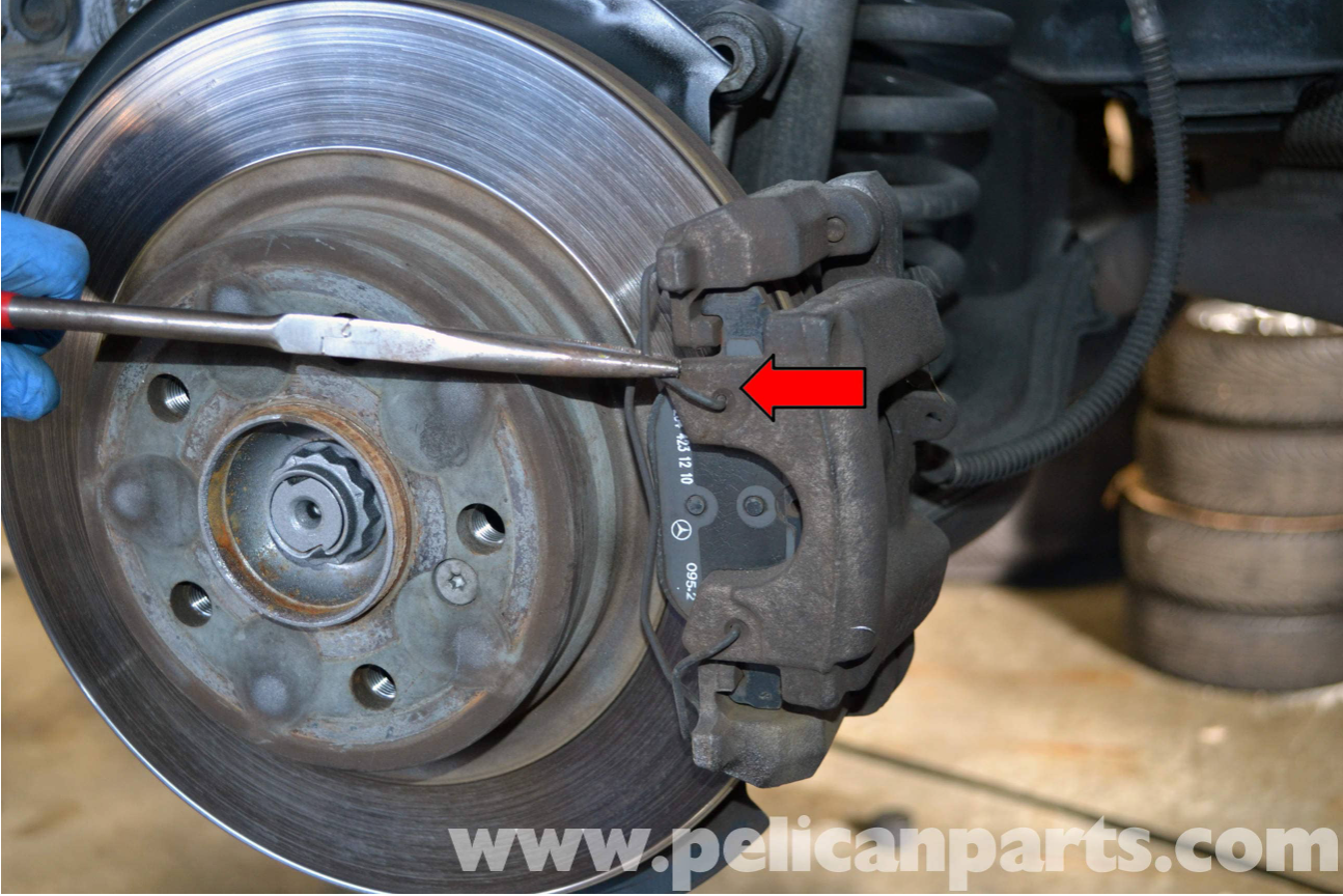

I would be checking to make sure the wire springs are installed right:

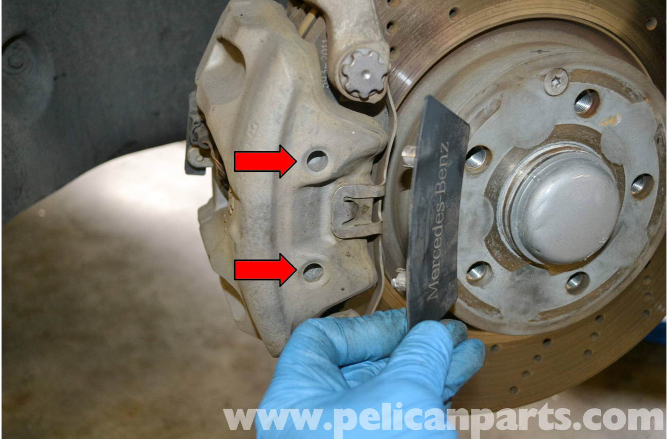

I would check to make sure the caliper pins are torqued:
Then double check the caliper bracket bolts to make sure they are torued right.

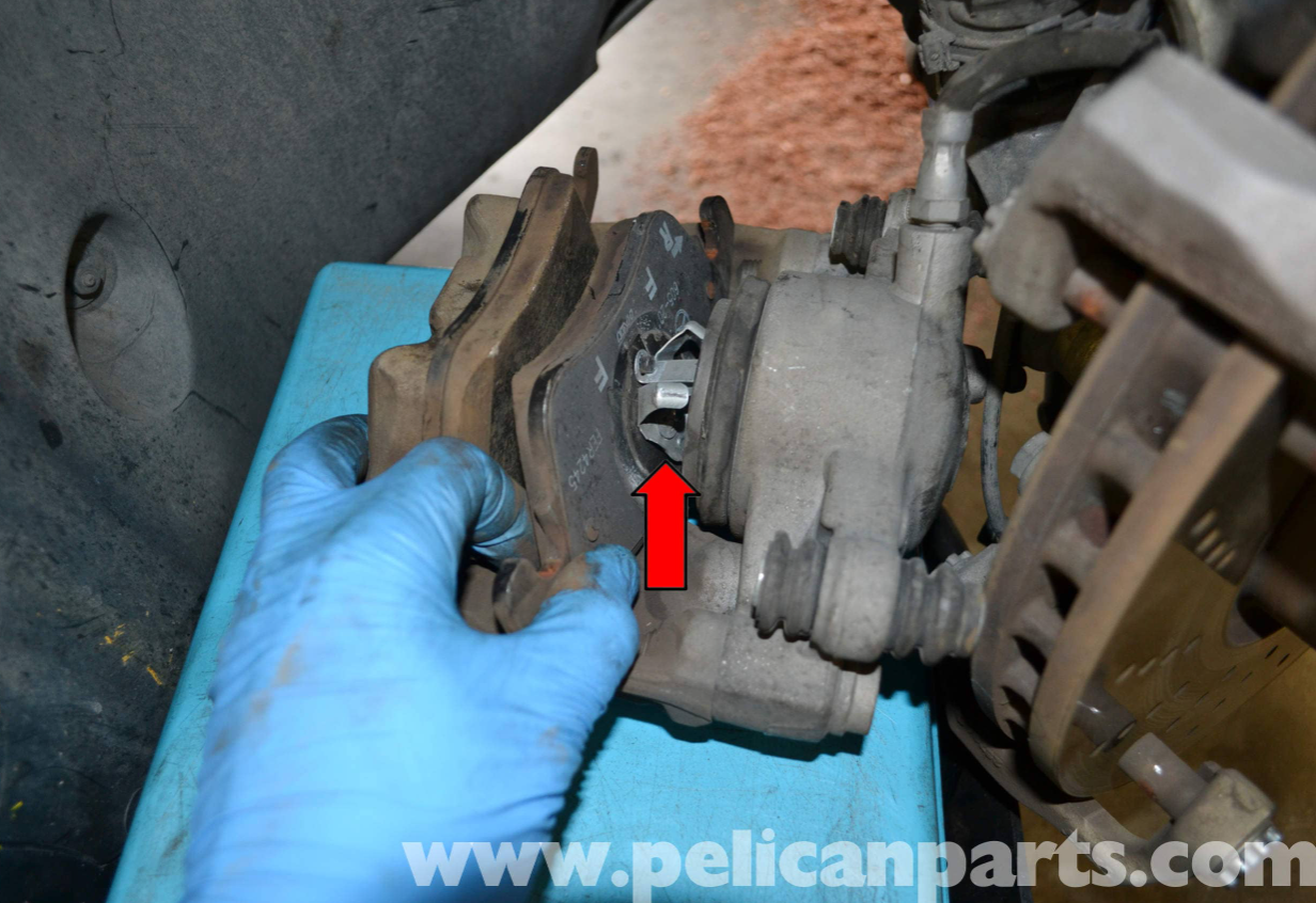

Looked like in the video it was in the rear. Im not familiar with all the different types of brakes on the W204 but i do know there are different ones in the front.
My fronts do not have a retention spring at all for the pads. Also the inside pad does not clip into the caliper. I see other types have the inside pads that clip into the caliper and they have a flat type spring on the outside pads. When I did my fronts i looked at the article on Pelican parts and i didnt see that flat retention spring on mine so was about to order them thinking they were missing. But no they wouldnt even fit my set-up in the first place.
Heres the pelican parts photos of the W204 they worked on, Fronts:
My W204 4matic Sport uses front pads without the clips on the back of the inner pads:
But I think the rears are the same across all models. The same as in the inner pads clip into the calipers and they have that wire type retention spring on the outer pad. Obviously I could be wrong.
