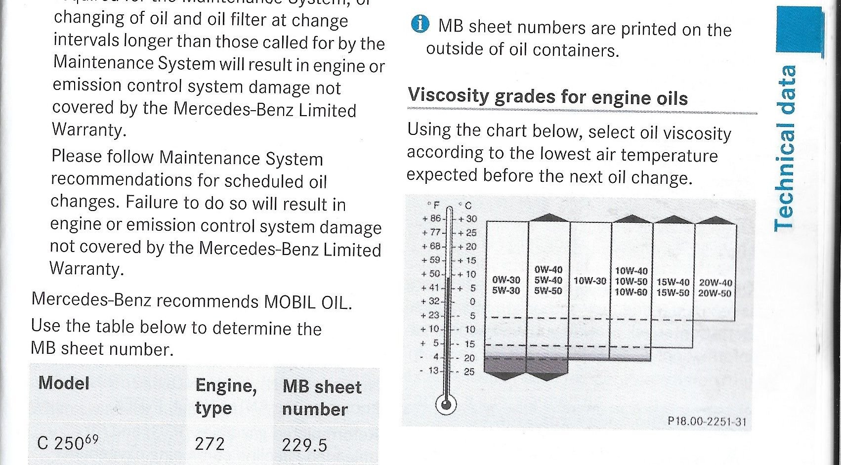

Out of the 5w30 or 5w40 I would use the 5w40 if I were you. Looks like the 5w40 operates in higher and lower temps. Im sure your car will see +86 degrees in summer.
Im in New England so see hot summers into the 90's then winters in the single digits once in a great while. I use the Mobil1 0w40 because it is low cost locally and I used it in my previous vehicles so im just used to getting it.
Based on the chart in the back of the Operators manual. Your manual may be different.

Interesting chart. I’ve seen it before but never really looked at it closely.
After doing more research - I also want to go with a 40 grade because I’m concerned about fuel dilution. Anything I can do to help the timing chain last longer and who knows - head off the cam phaser troubles. The car has 68k miles, hoping to keep it least until around 130-140k miles.

@TimC300 Just a note: For the cars that fall under sheet 229.5, I also like 0/5W-40 oils. However, isn’t that chart for the lowest temperature that the car will see? For me, SE Texas, I always thought it meant use anything.
