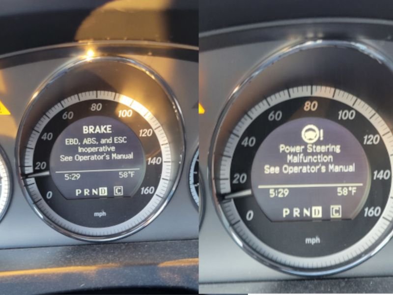

It has been discussed in past posts, but I wanted to re-open the discussion of the “EBD, ABS, ESP Inoperative” followed by the “Power Steering Malfunction”. I am seeing this error with my 2010. The car had this error for about a week approximately one year ago and it went away on its own. Now, it has been back for a few weeks and appears on every trip. The power steering still seems to work fine (I haven’t tried a panic stop to see if the ABS still functions!)
From past posts, here are some of the potential causes:
  • One or more wheel speed sensors have failed or gotten dirty/disconnected
  • The large plug connecting to the ABS/ESP module has dirty or oxidized connections
  • The brake pedal switch has failed (or partially failed?)
  • The ABS/ESP module has failed and either needs to be rebuilt or replaced
I’m hoping this thread can help catalog the process for determining the cause of the errors. In my case:
  • Based on monitoring with an icarsoft scanner, my wheel speed sensors are all working
  • I have repeatedly disconnected the large ABS/ESP module plug and cleaned/scrubbed the pins
  • My brake lights work properly. I do not know if the brake light switch can be the cause even if the brake lights work?
Scanning the stability program module with the icarsoft, I show the following error:
5001- Electronic Stability Program control module internal fault
I have also seen 5945 recently, which is also Electronic Stability Program control module internal fault, but that hasn’t come back since a previous clearing.
Is anyone particularly familiar with this issue- what should the next steps be for diagnosis?
