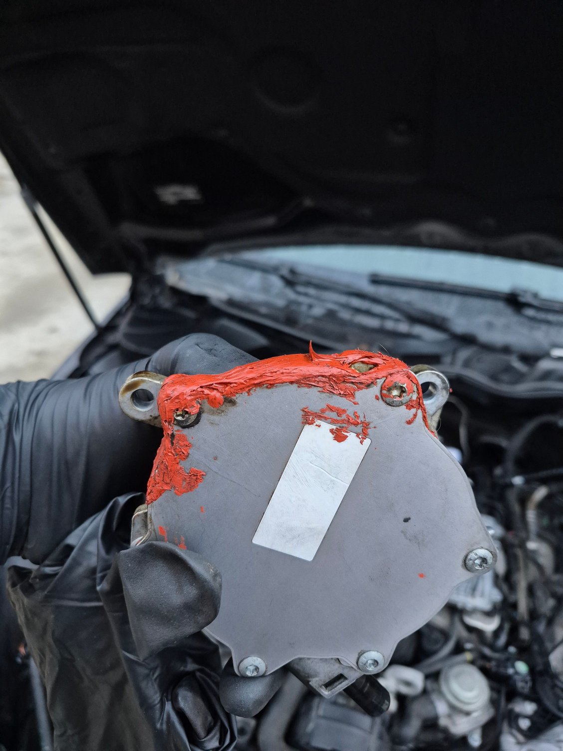

I just removed the vacuum pump. Top two bolts were easy. Bottom bolt underneath was a royal pain. I'm 6'4", so it is enough trouble just bending over that very low hood, then I have big hands and there is just no room back there. I took off the MAF, which helped a little with visibility, if nothing else (plus it is very easy). It would have been nice to remove the water hose through the firewall (to the heater core?), but that looked like more trouble than it was worth. I cut up my hand against it (through fairly thick rubber gloves. I was able to get a very small socket wrench on it to break it, but I could not hold it well enough to use the ratchey, nor get my fingers on it to spin it. I finally got a tiny ratcheting 5/16 box wrench and was able to hold it with my finger and use the ratchet, a couple clicks at a time until it was out enough to spin a socket with my fingers. That part would have been much, much easier with smaller hands
I'm both appalled and not surprised by what I found. The previous owner must have also found it difficult to remove and also must have thought the pump back was leaking and not the o-ring, so they slathered on an orange gasket sealer on the outside of the back of the pump. I'm going under the immediate assumption that it is the o-ring and they at least didn't hurt anything. It got dark and rainy, so I will reinstall it tomorrow. I don't think there is any reason to do anything to it before I install it, it just looks a little weird.
Rear of brake vacuum pump. Orange gasket sealer smeared on the bottom edge.
Front side of the pump, where it inserts into the head. You can see how much orange goop they smeared on.
