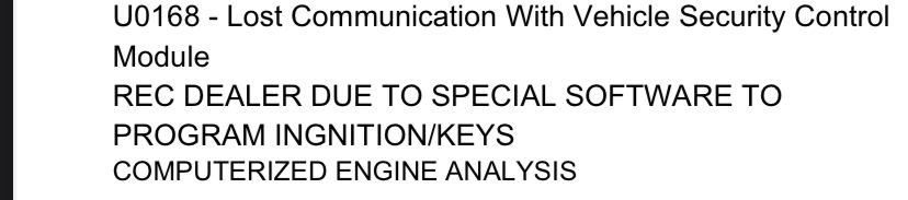

My car ignition won’t start my car no more . I tried to take it to a shop and they said take it to the dealership cause the programming is special . I’m wondering if taking it to the dealership is my only option. The key to my car works , locks , unlocks and etc . The problem is when I insert it , it won’t register and won’t start . I’m losing hope . Can they really charge me 2,000 for something like this?

The programming is not all that special. As mentioned previously, an Indy shop that knows MB cars will have the equipment. You really need to get the car to one to find out exactly which module has failed. The DTC seems to indicate the ESL. The ESL is a fairly straightforward repair. A new one or an emulator will need to be matched to you VIN. If you do need an EIS, the biggest problem is going to be parts availability. New ones can take a long time to get. Getting a used one will mean the shop will need to be able to erase it and then match it to you VIN. That’s an extra step. Pre-erased (aka “virginized”) ones can usually be found online. The Baltimore area should have a number of shops specializing in MB and German cars. Just be sure to talk with them about your problem before sending your car there.
