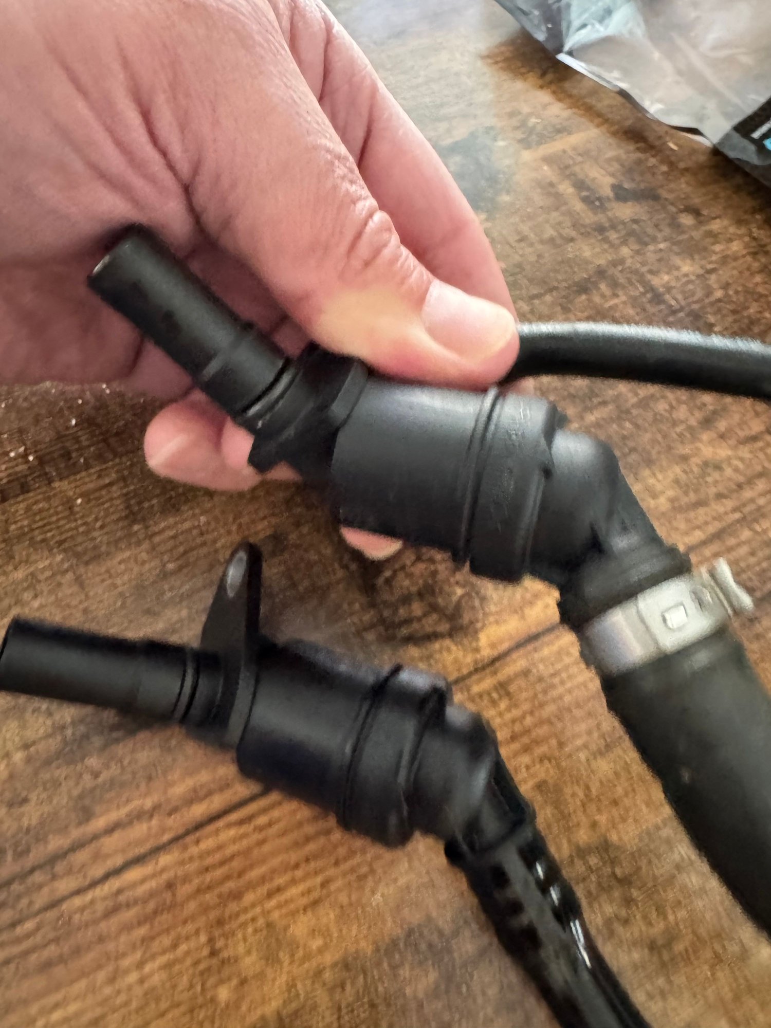

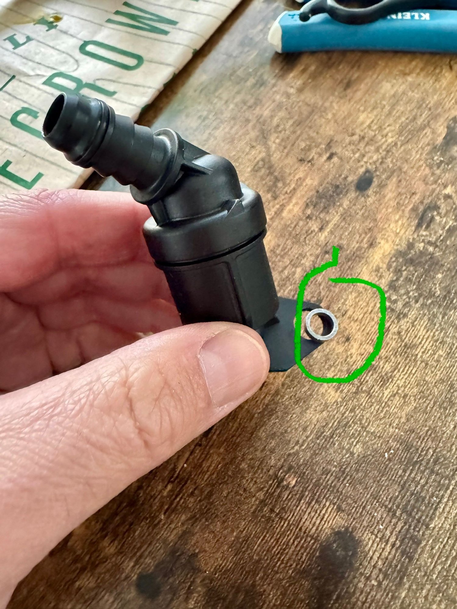

the vent valve seams ok, blows through the same (flows one way, blocks other way) as the new vent valve (small valve with the arrow). The valve I circled, the part that bolts to the crankcase, I cant blow through either direction. Should I be able to blow through that part in one of the directions, or could that be my blockage? Is that part itself repairable/cleanable?
(the codes are another issue, I was just wondering if they could be thrown if there was a crankcase ventilation problem. I do have diluted oil, rusted dipstick, and oil leaking.)
Your symptoms are the same as mine. I think you’re supposed to be able to blow through it in both directions with some resistance, but to be honest, I didn’t get that far because mine had a broken vacuum line on the check valve and the lines were plugged with sludge. I just replaced the whole thing. You may be able to clean it in gasoline. It’s plastic, so I think carb cleaner would destroy it.
But that didn’t get rid of the codes. Sometimes I had the small leak, others the large leak - gas cap off warnings. I took the car to a local indie MB shop and the owner, who I know well, found the cracked evaporative canister. The crack was invisible unless you moved the canister with your hand. I gave him a few $$ for diagnosis and changed it myself with a used one from eBay.

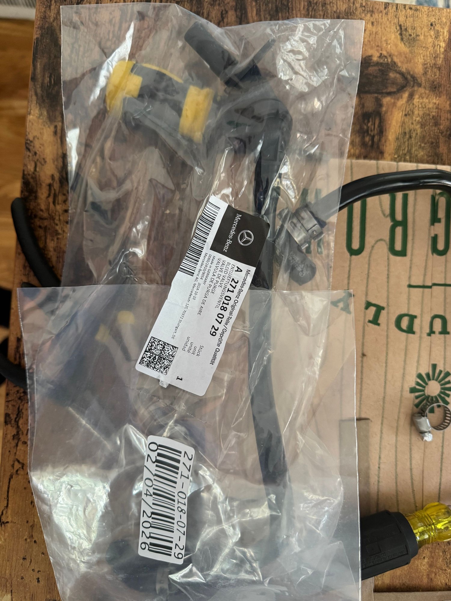

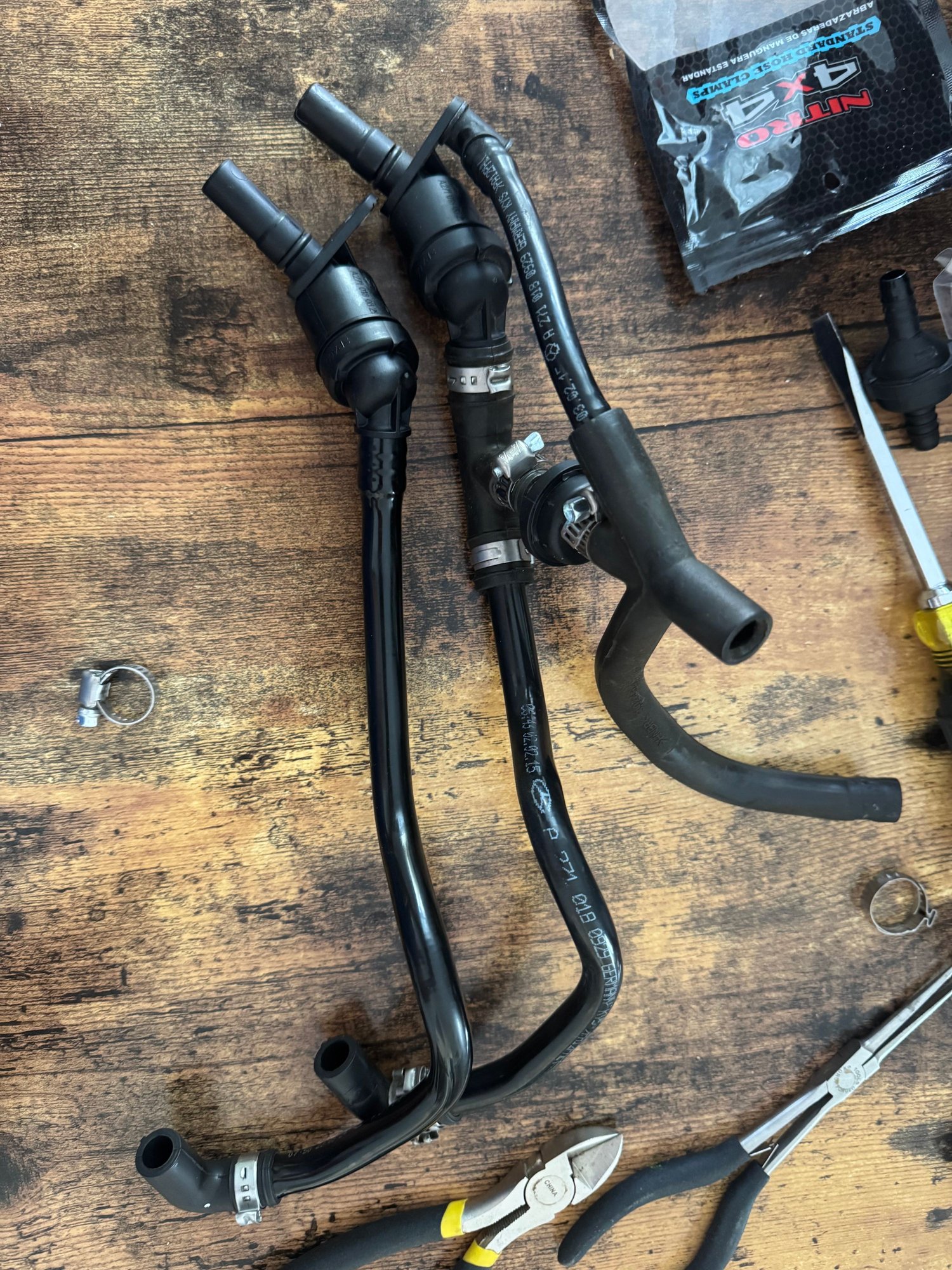

Ok so I pulled the crankcase breather assembly and the check valve was fine but the bleeder valve was clogged. Hoses were in great shape, no leaks or clogs. I was able to order that exact bleeder valve, genuine mercedes, for $40 without having to buy the entire assembly ($200+) --photos below, which include the part number (only need to pop the metal ring out of the base so the other hose fits back on--see photo). For anyone interested, the new part you can blow air from engine side outward, not the other way, and there is a bit of resistance just like the check valve. There is also a really great post about why that check valve sucks so bad and a modification that I will link, but that was beyond my interest at this point, however,I may look into that down the road.
I put it back together and while engine cold, theres vacuum at the oil cap. When warm, cap bounces. I know the bleeder was clogged so I am glad to have that replaced. I have a valve cover on the way and will just do that too. Will see what happens after that.
Still have the 441 code and now the 2422 is back (I checked the ohms on the canister check valve to make sure that didnt go bad in the few days its been on but it checked out good) so I ordered the on tank pressure sensor and when it arrives I will lower the tank and replace it. I also took the canister off again and thoroughly inspected it. Nothing rattles when I shake it, no visible cracks, no clogs, and I capped and blocked outlets and pushed air in, seamed to hold good.

@TimC300 Yes I just replaced the old canister shut off valve with a new genuine mercedes one about 3 or 4 weeks ago. A few days ago, I took the new one off (after getting the 2422 code again) to check the ohms and it read the same as before I installed it. I also thoroughly checked the canister and just couldn't find anything wrong with it. As soon as I can afford a Sentry I will get it, but for now I am just trying to get by. I saw a post where a mechanic who got the same codes was able to use sentry to determine that the issue indeed was the on tank fuel pressure sensor (sending bad info). So that part is on its way and when it arrives I will get it on jack stands and lower the tank to replace it.
On the PCV blow-by issue, I replaced the low side check valve,and bleed valve (which was clogged), and made sure the other hoses were in perfect shape. That repair did not stop the oil cap from bouncing around, especially when warm, so I got a new valve cover and am in the process of putting that on right now. There was oil leaking into one of the spark plug inlets so I guess it was needed anyway.

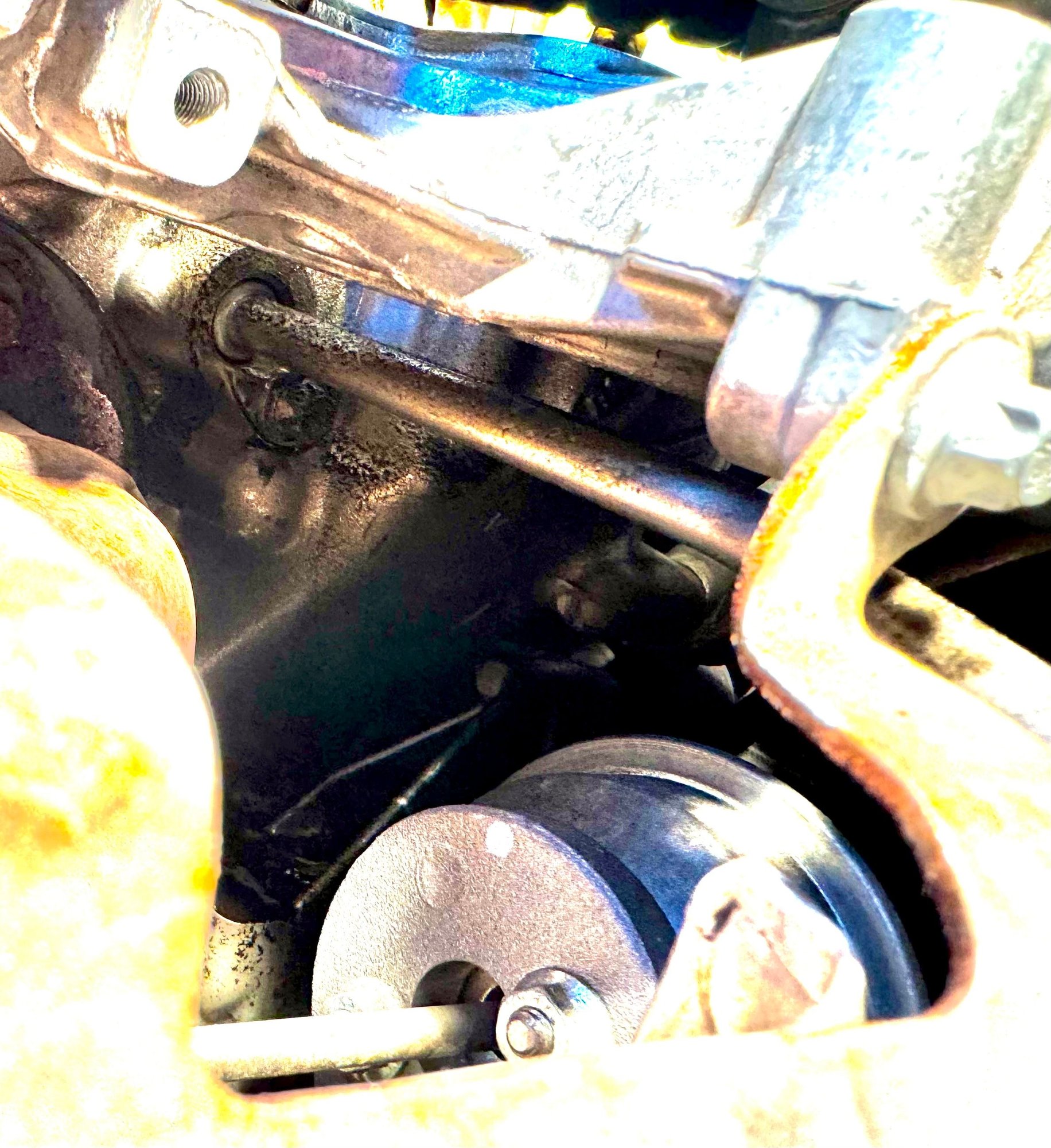

I also found a lot of oil leaking from the Turbo Line. Theres a thread on a fix for that that I will try out. Pics of that included below.
