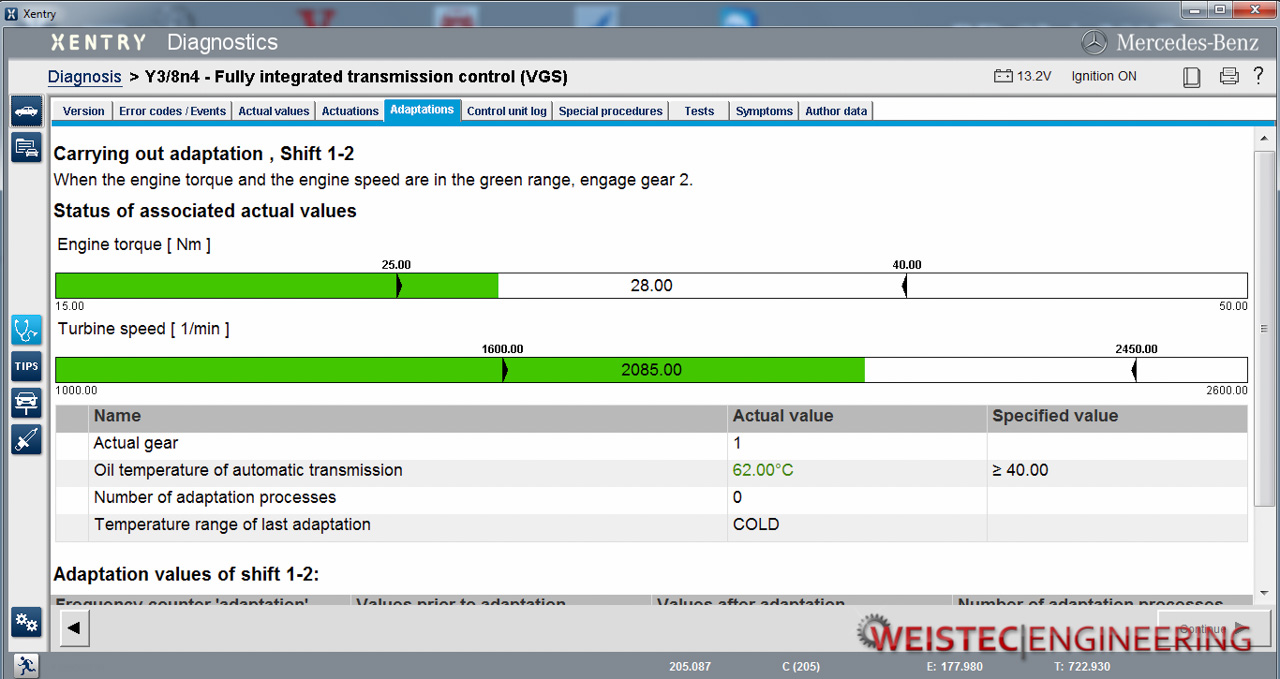

Originally Posted by raverx3m
second gear shift delay
Have you tried the relearn process that's activated thru a good scanner or Xentry? It may fix your shifting issue as you usually cant feel these cars shift much. This is a picture of the adaption learn page from Xentry.
