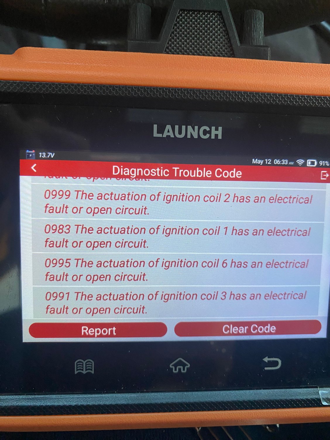

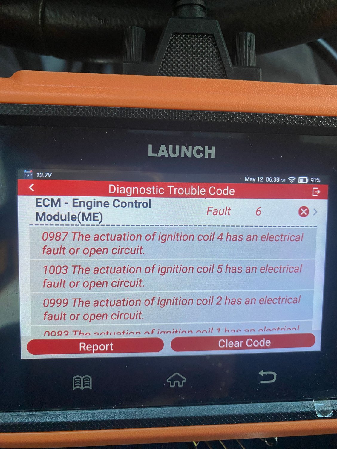

Help I just changed new spark plugs and I get these codes
I just recently did my spark plugs and coil packs . After a while of driving I started getting these codes . I don’t know what I did wrong? Is it bad spark plugs? I don’t see an issue .

How does the car run? I would think it would be misfiring and stumbling with those codes.
Are the codes STORED or CURRENT? Have you tried clearing them? Disconnecting the coils to remove them could have caused this.
What plugs did you use?

it says stored I believe . I clear them , they go away and my car runs smoother . But when light comes on , it starts stumbling a little bit not much but a little. Disconnecting the coils? What do you mean?

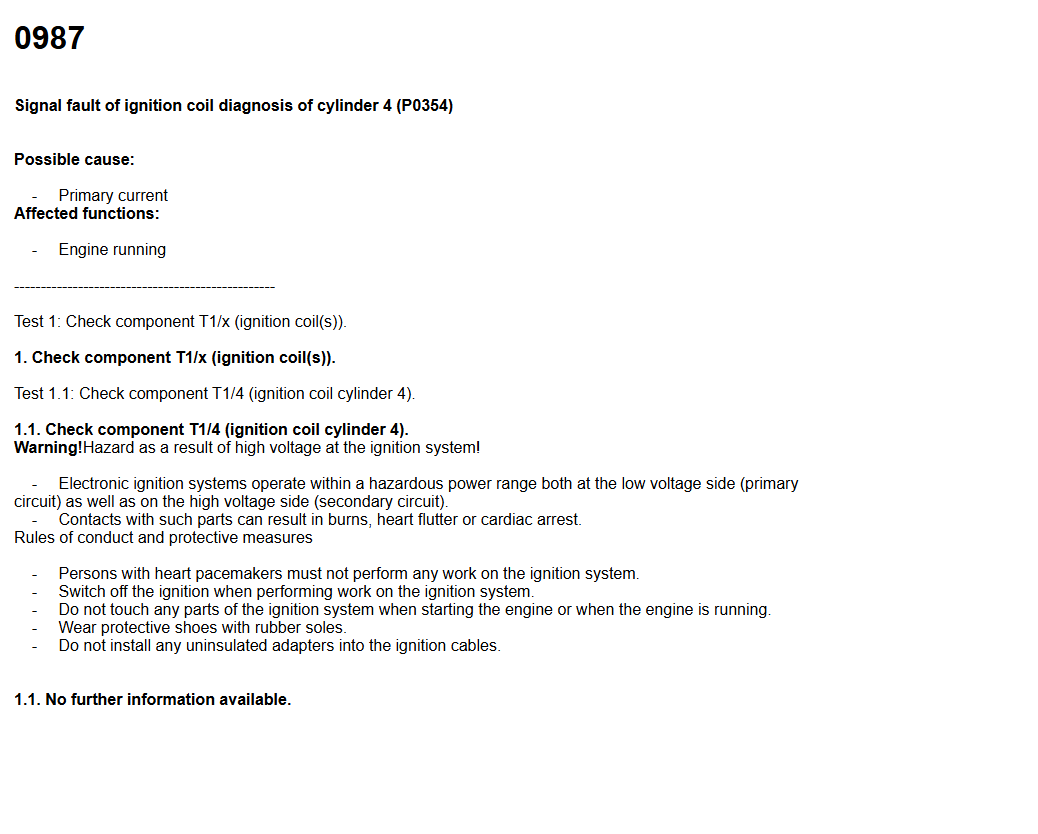

Re-install one of the old coils and see if the faults occur.
Im guessing using non-OE may be causing the issues.
Example of Ign coil 4 fault 0987:

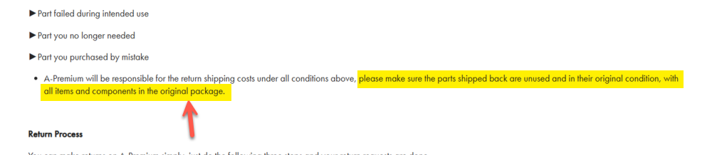

I was looking on the A-Premium website here: https://a-premium.com/page/return-policy

This part should be kept in mind. Most people will toss the packaging, etc. after installation.
