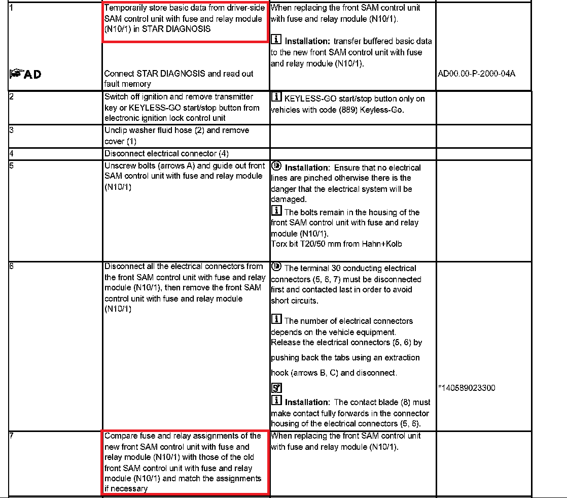

I've never replaced one so not entirely sure. The manual mentions downloading the info off the sam prior to replacing it.
If you are buying a brand new sam im guessing some features may have to be programed. Example if you have (234) Blind spot assist.
Ive seen people buy used and it was plug n play, then ive seen where someone bought used and had to go to the dealer to get some features working.

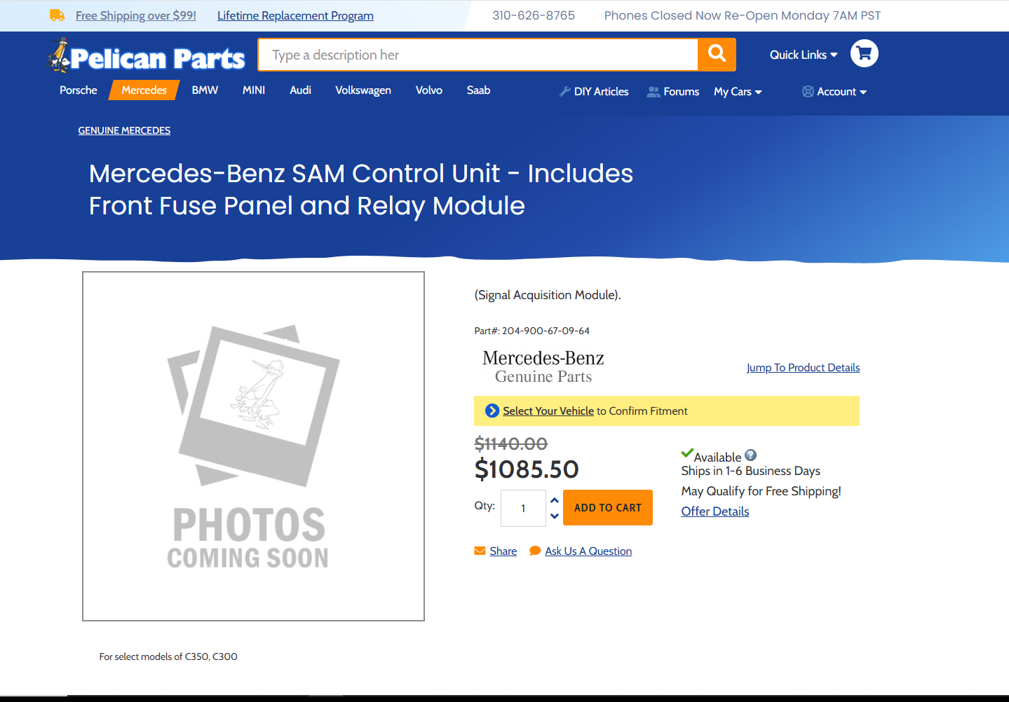

I'm thinking I'm screwed on this. Mercedes don't have a sam that will work and no date on if they will get one. Plus 1200 and coding is just too much. I have found one that might work but my icarsoftmb2 won't connect to odb and don't think it will be able save info from the sam. What kind of had me baffled is the list from that link don't include the part number from the sam that's in the car now.

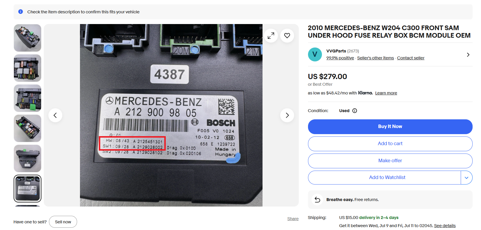

I havent looked at the label on my front sam but had it on the scanner and read the numbers. I looked around on eBay and think I found one that may be the same. I'm too lazy to open up the sam and look. What does your sam label read?
Heres mine, then one I found on eBay.

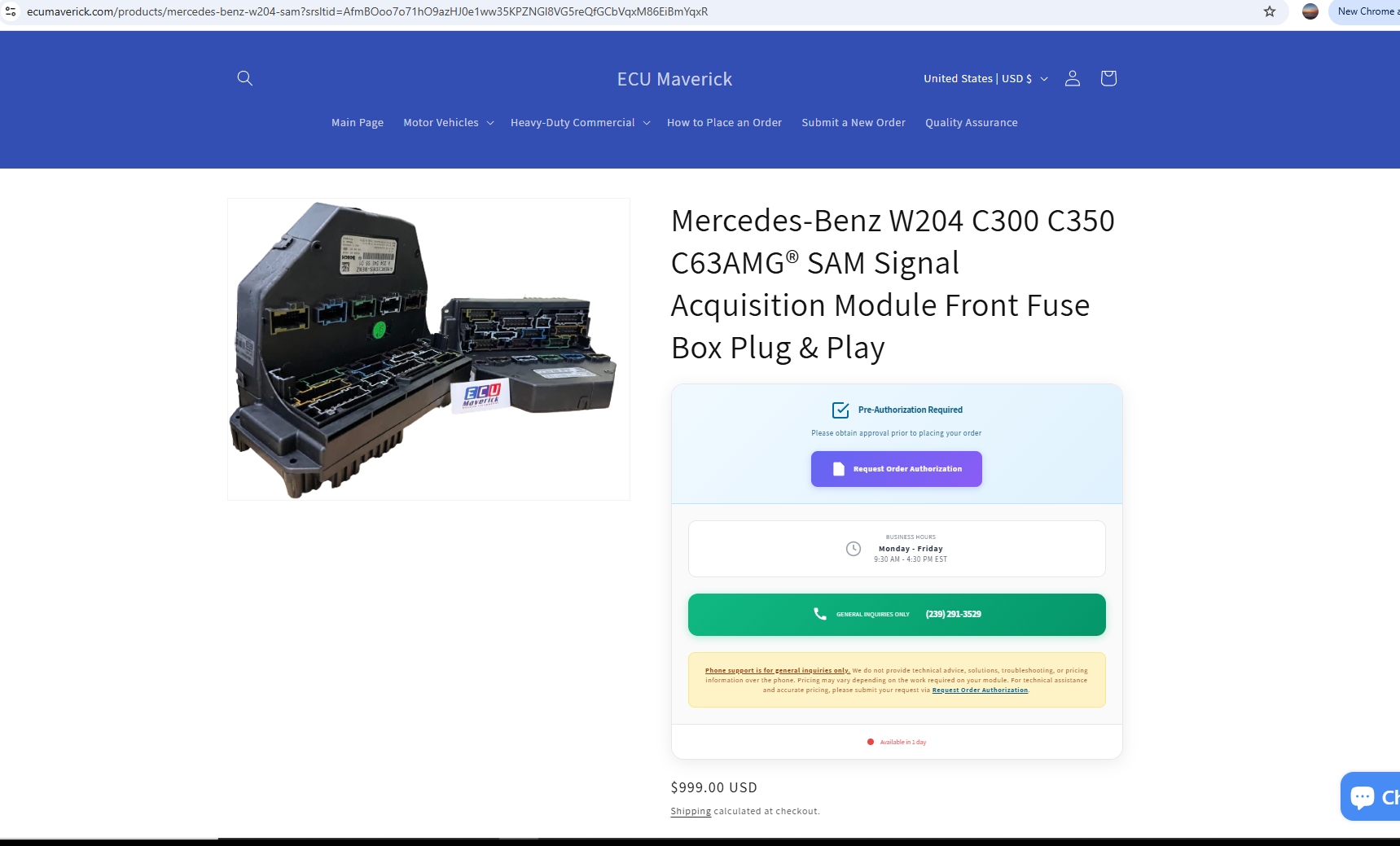

Hi there, I have been through everything you have and I hope you get lucky,but, it'll mk isn't likely need flashed at an MB dealer. Or, ECU mavericks will basic fix the one you have and flash itnplug and play for like $500.
I was lucky to find a new front Sam out of some dealers in RI, bb it water got in again and while mine still works, the lights stay on all the time the cars running and the horn doesn't work.
I'm wait for the end of the year to utilize ECU mavericks, but yeah.
