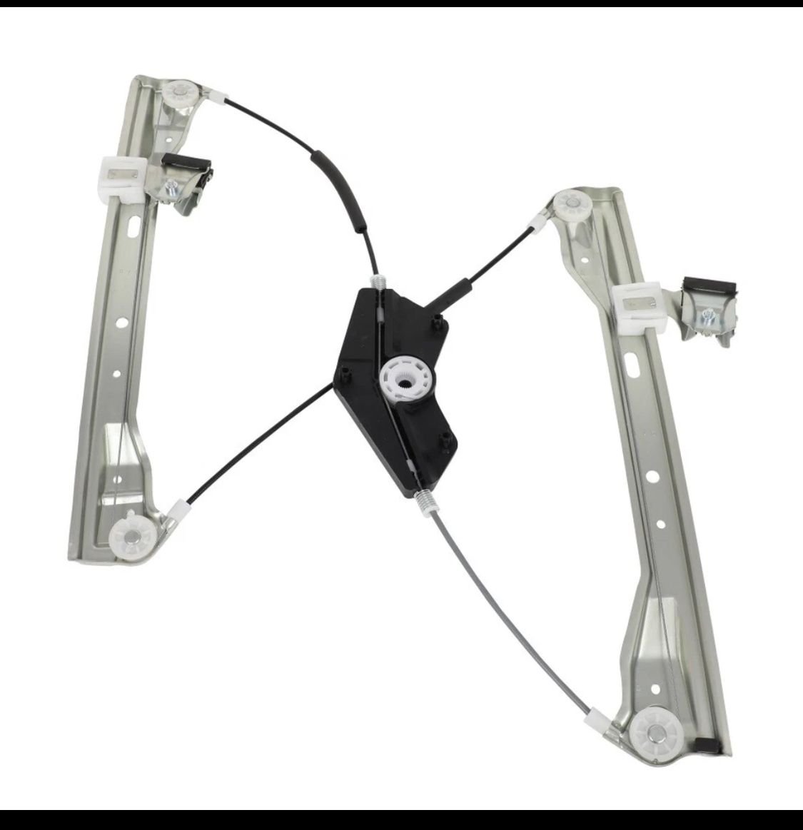

I’ve seen replacement parts online. Some are just the regulator, while others come with the regulator already attached to the panel.

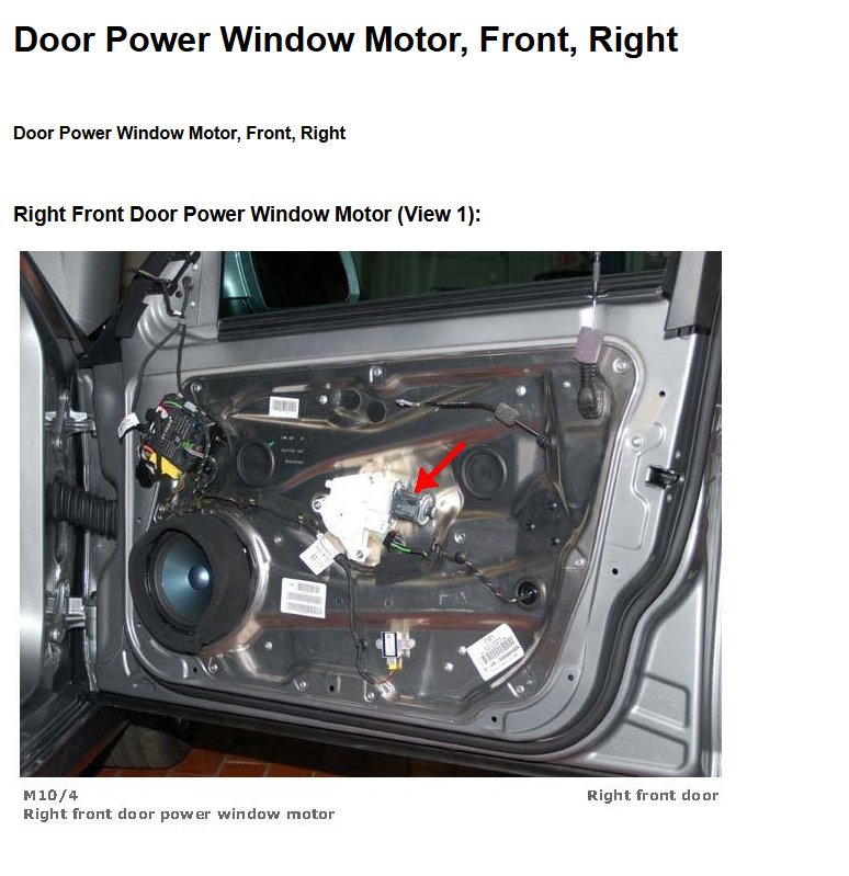

Do you have a scanner to check for faults? My scanner has functions to test the switches to see where the issue is.
Can always look thru the manual for instructions: https://charm.li/Mercedes%20Benz/201...d%20Diagnosis/

Easy enough. But get the one with the carrier included to cut down on the work. You’ll need a drill, a riveter and 1/4 and 1/8 rivets. You’ll be moving the wiring, a module and the actuator from the old carrier to the new. There’s a guide on pelican parts.

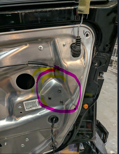

I removed all the rivets, the panel seems stuck on the right top or middle. I'm not sure if I need to drill out the 3 black plastic rivets (it seems rivets).
This is the front passenger door panel.
The glass is all the way up. I removed the 2 screws in the plastic clips that holds the glass.
Any help is appreciated.

You don't need to drill out the plastic rivets at that juncture. Should be able to come out now.
Follow the Pelican Parts guide and see if everything is good. That's the guide I used.

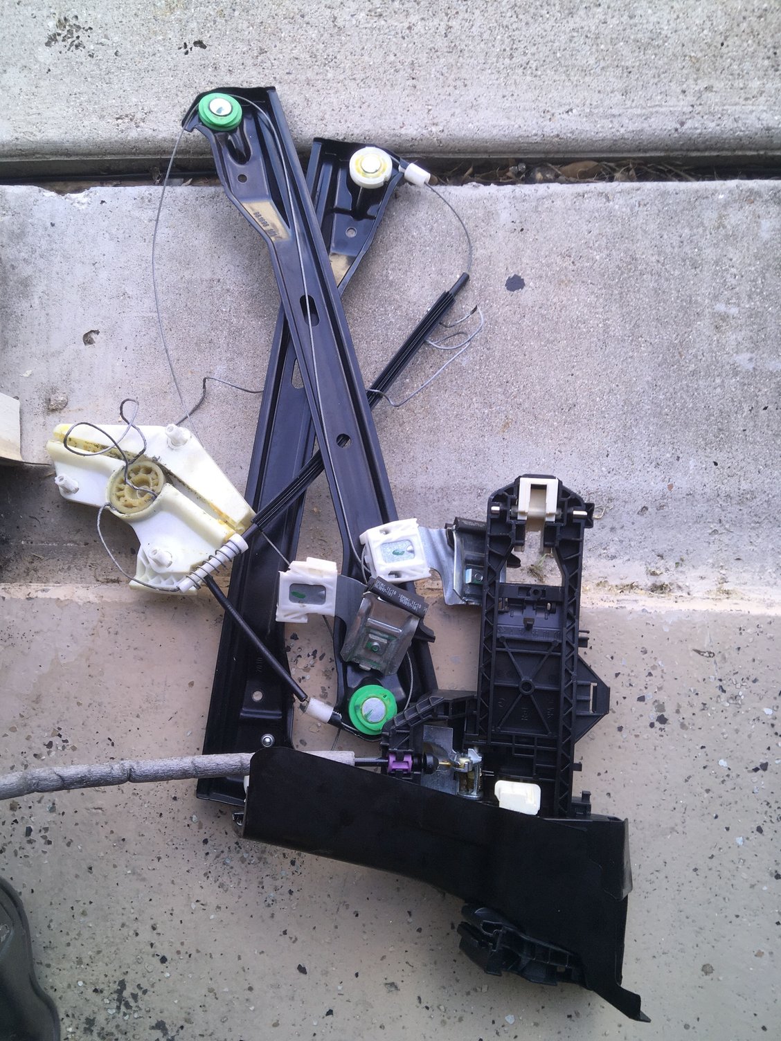

I removed the old panel, riveted the new one in place, and started reconnecting everything. I haven’t finished yet, but it’s coming along.
I realized I missed one rivet that holds the plastic piece behind the door handle. Is that rivet essential, or can I get by without it? I’m not exactly sure what that plastic piece is for.

Which plastic piece? Fully assembled:

These 4 actually.
The group of three has black plastic tabs, I'm thinking of using push pins of some sort.
But I'm not sure if I don't secure them what might be the consequences.

I'd rather not you find out, as that would mean having to take the door apart again. Use washers to size the holes down, use tape to hold the washers. I don't remember having to remove that 4th rivet in the picture.
