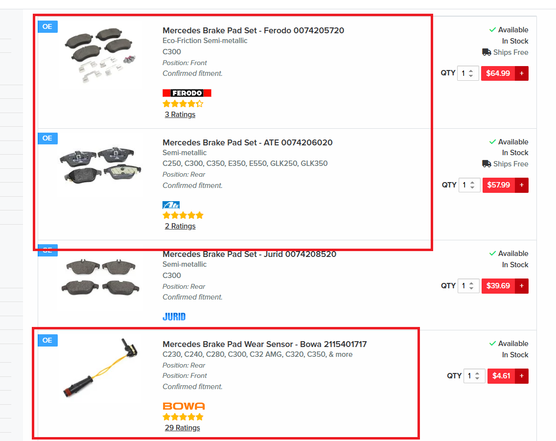

I have a 204.081 2010 C300 4matic Sport. I went with Zimmerman rotors, Ferodo semi metallic front pads and ATE semi metallic rear pads. I think they work great. The pads appeared to look the exact same as the Genuine MB pads I replaced from the car. These Zimmerman rotors seem much better than the Genuine MB rotors I replaced, the MB rotors looked rusty and were deeply grooved though I have no idea how long they were on the car if they were replaced with the pads last time.
Only complaint is the rims look dirty very quick, im always washing them.
Heres the exact ones I have.

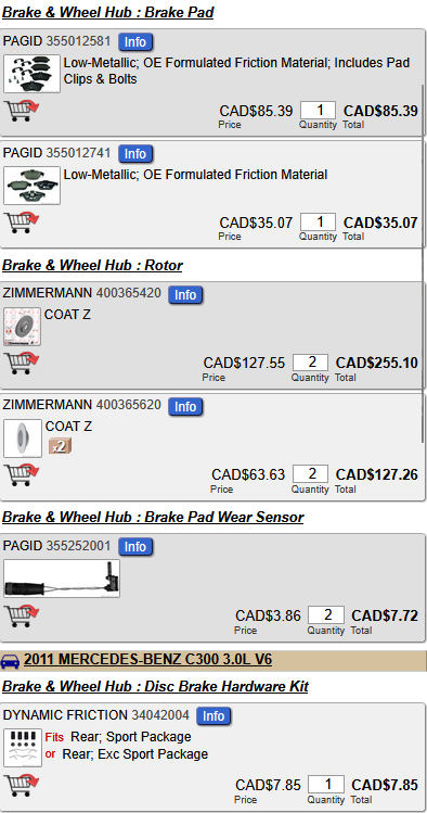

Appreciate the info folks, I called around different dealerships to confirm part numbers.. A bit odd I was getting different part numbers from different dealerships, but I'm guessing that's due to multiple part numbers associated with a single part.
front rotor
000421301207
0004211112
front pads
0054201520
0004209004
0004200105
rear rotor
2044231512
2044230912
rear pads
0074206020
0004200205
0004200720
sensor
2115401717
2115401817
Below is what I ended up ordering, based off my research these *should* fit. I also learned there's different brake pads on the rear depending on if you have a cast iron caliper versus aluminum.
