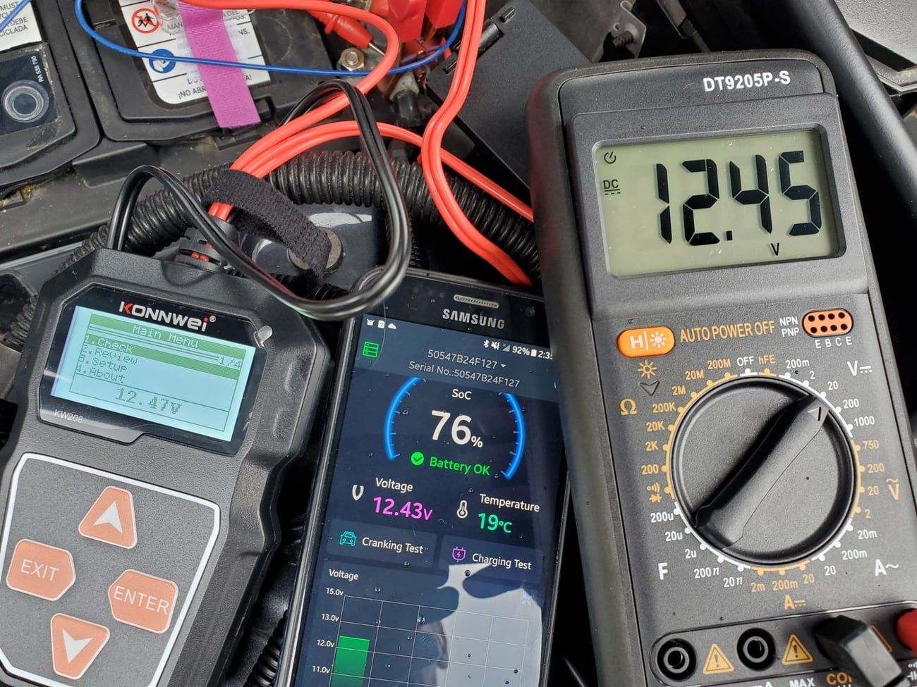

12.45v seems fine to me. I was having a red battery warning pop up on my dash awhile ago and did alot of testing. The warning stopped coming on so I never did anything with it.
I was using two inexpensive battery testers and a multimeter.

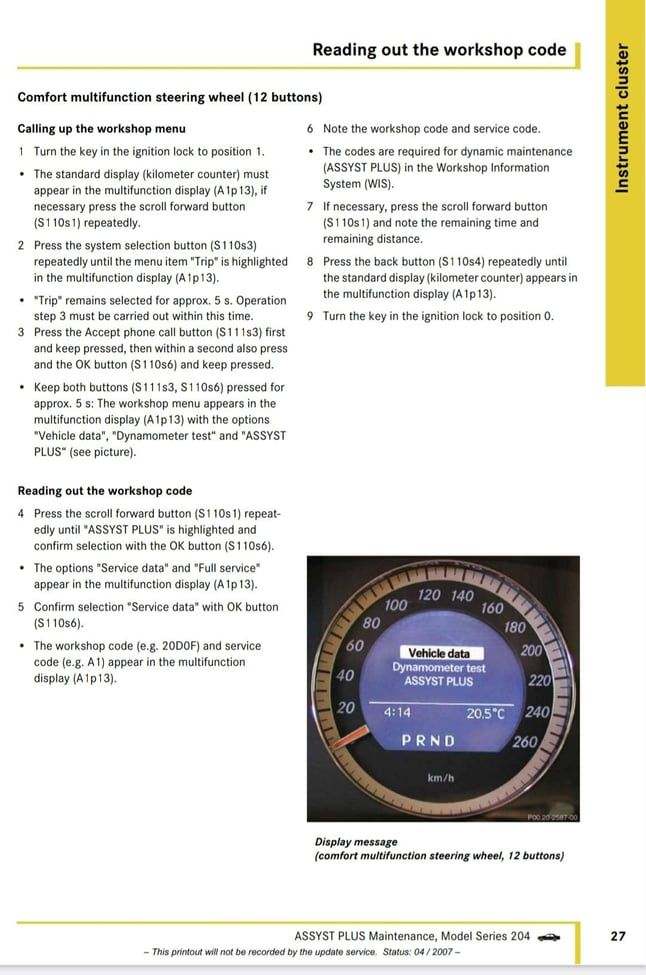

Can you learn to display voltage on your IC display while driving.
You will be able to witness how voltage & amps flow in/out of batt/ALT

OK, here is the Voltages measured with Voltmeter through windscreen(The Voltage menu display does not work in this car)

If your alternator is not properly working you may be able to just replace the voltage regulator which is a less expensive option than replacing the alternator.
When I was testing out my charging system I bought an inexpensive battery tester that I hooked directly to the battery and with bluetooth allows me to view the voltage as im driving. I found it handy. What it showed me was as soon as i started the car the voltage went up indicating the alternator was fine. Heres a link to the thread I made on it. Theres alot of useless information but gives you an idea of what I did: https://mbworld.org/forums/c-class-w...eadings-2.html

You can see the voltage using the ASSYST PLUS menus from the dash display.
Follow the first set of instructions for Calling up the workshop menu. Then when your screen looks like in the photo below go into Vehicle Data.
