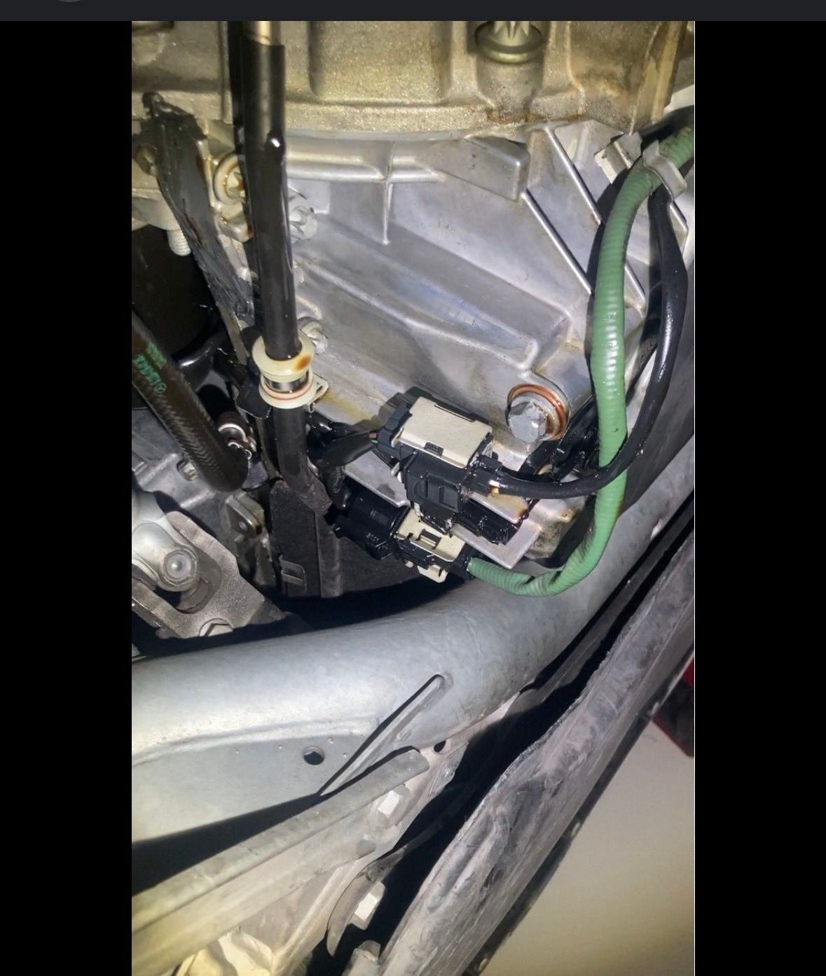

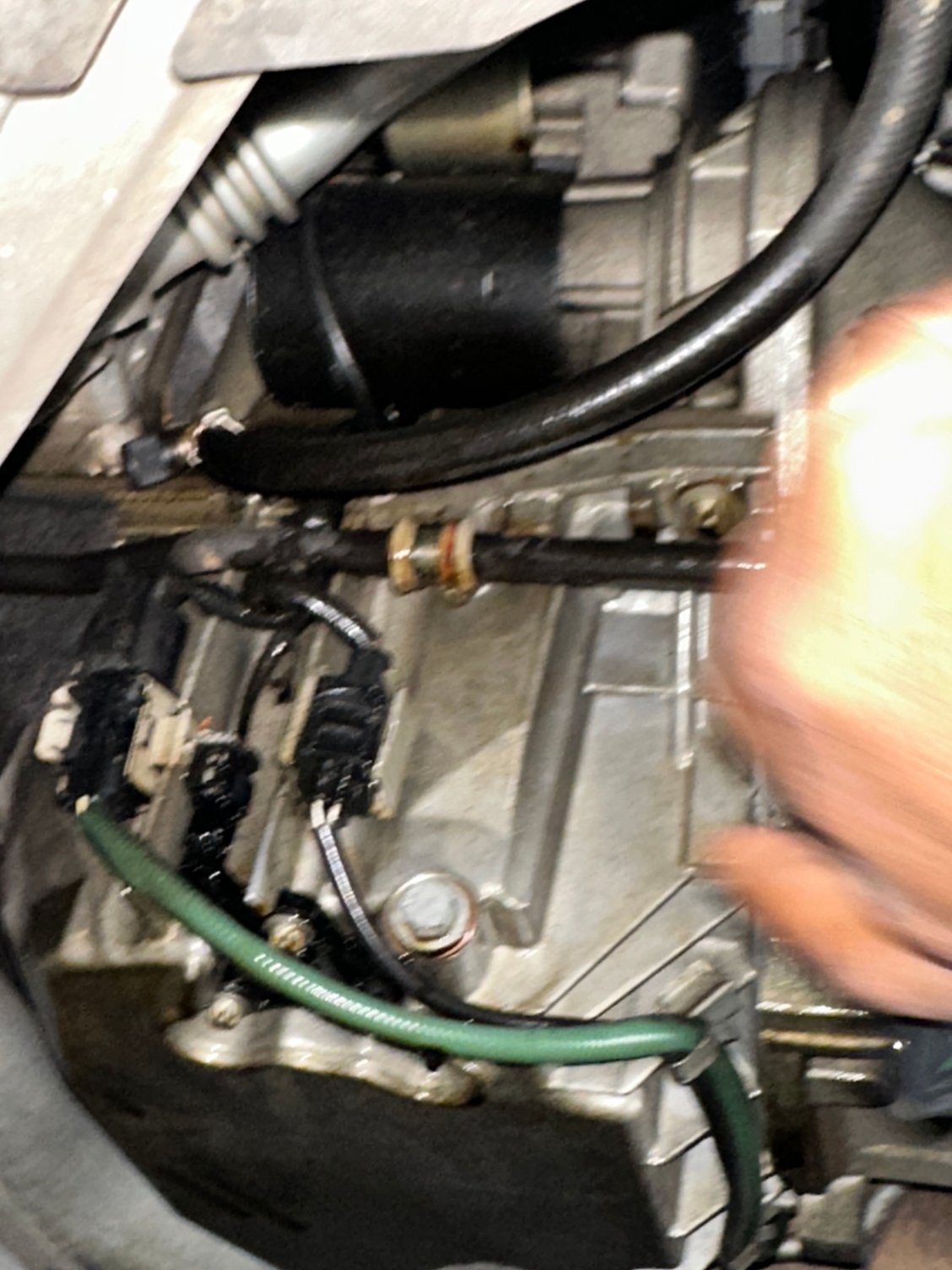

Can any one tell me what this part is

Most likely it's you oil filter housing gasket. I have a 2013 C250 and had similar issue.

no it’s the tube that I’ve ahown in the picture it has an crack in it

I just can’t figure out what the part is I’m thinking it’s the oil cooler line for the transmission maybe ?

If it is the trans fluid line there should be a part# stamped on one of the fittings.
That leak looks like oil to me.
I would thoroughly clean the area then try and see exactly where the leak is coming from. If you havent already.

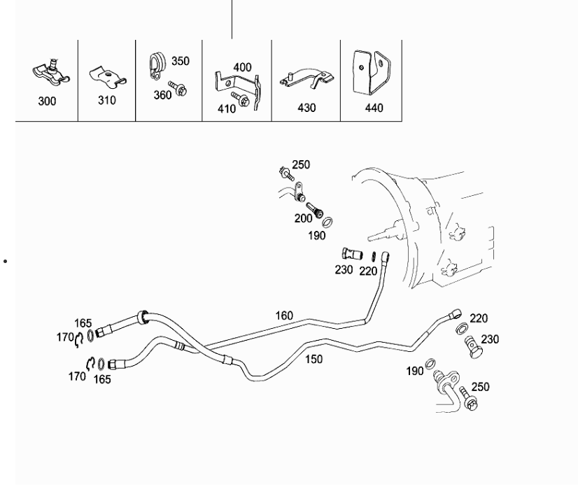

I was reading thru a thread and came across an interesting photo. It shows the transmission lines and it appears the lines have some type of cover over them. Made me think of this thread with thinking the line is cracked. It could just be the covering/coating on the line.
2013 transmission should have blue fluid I believe. The leaking fluid in the photos looks like oil.
I could be wrong.
photo below.

yo Tim it is the transmission line that goes into the radiator on the left side it has a crack on the black part of the hose , it is indeed transmission fluid not oil
