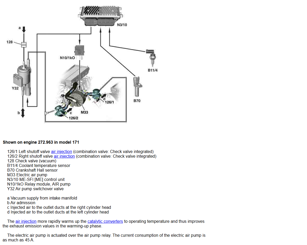

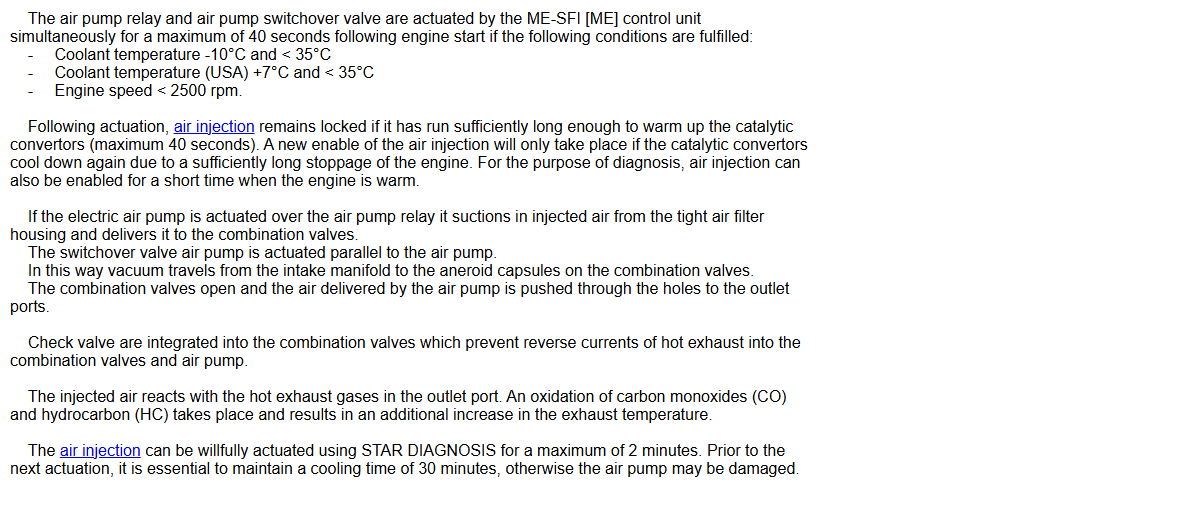

If it is the secondary air pump it does sound a bit off.
It should turn on at cold starts and run for 40 seconds. Its for emissions to get the cats hot quickly.
Depending what obd scanner you have you should be able to function test it. If you do the manual says dont run it longer than 2 minutes.
