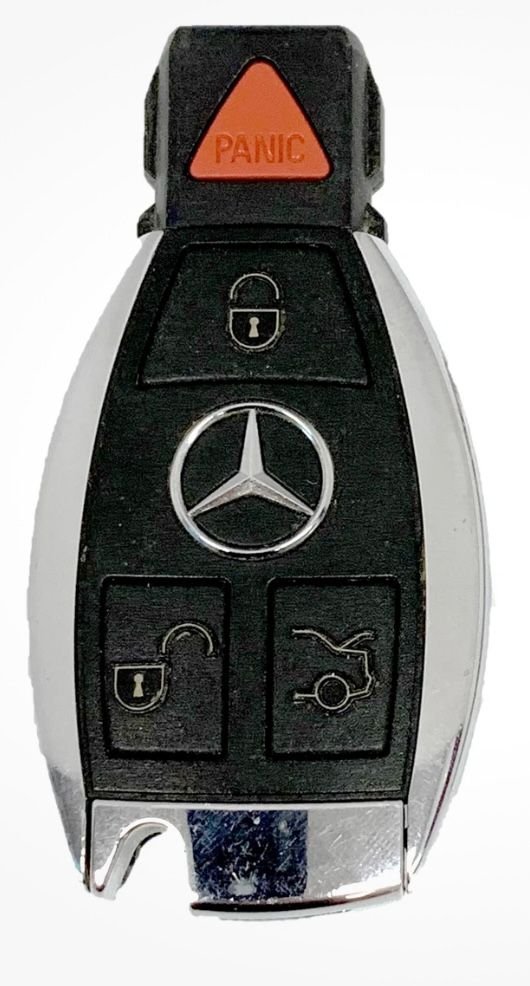

Is this what the key looks like?
If so, the single CR2025/32 has nothing to do with starting car.

Yes that's the key I have and that's odd I wonder if I was having problems with something else and it just happened to work when I changed the battery. I did check the car battery and tried to jump it just to see but nothing different happened
