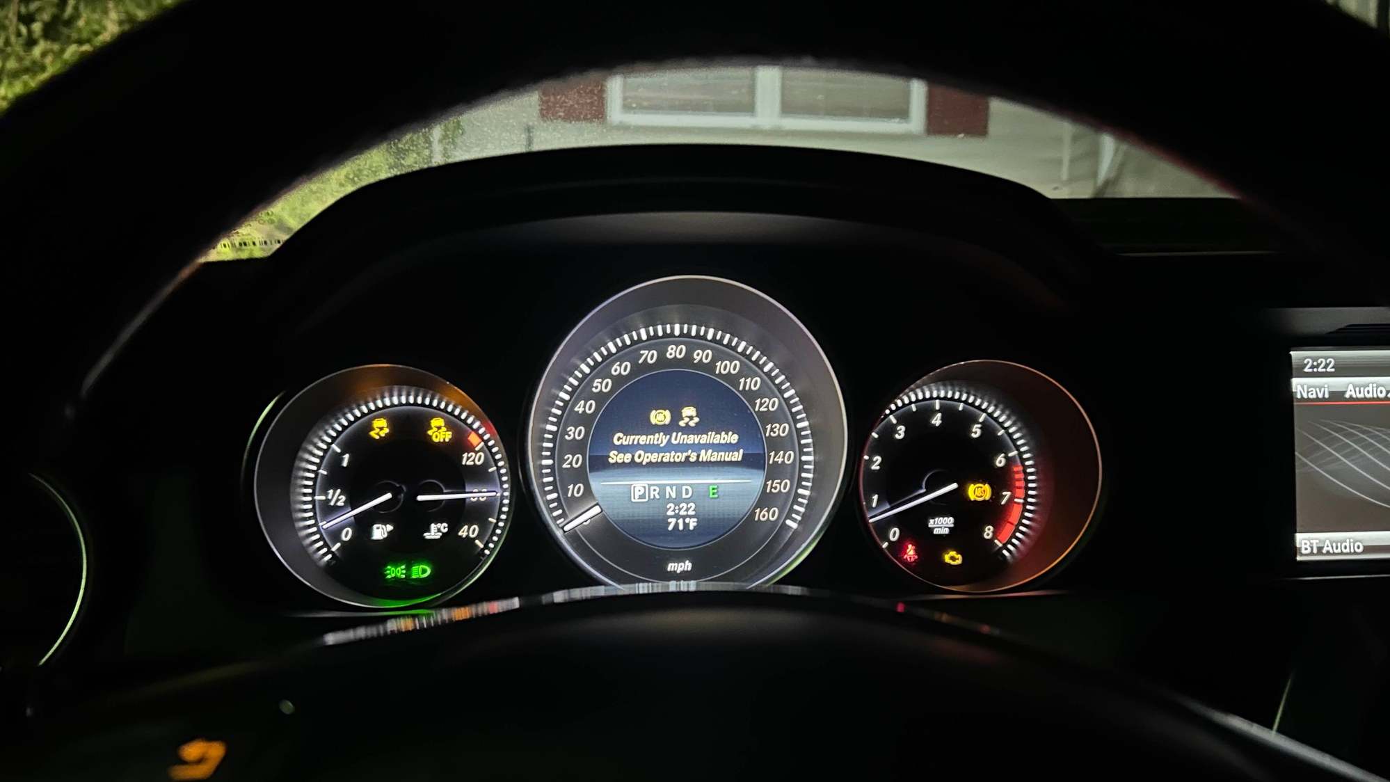

Angry My 2014 C300 has an erratic abs speed sensors, I think??
So early this year after a normal drive the TCS, ABS & TCS OFF lights all came on the dash as well as a message in the center info display stating the systems were inoperative and to refer to my owner's manual. So I did online research on common issues that could trigger this, and most of my symptoms pointed to a failing/failed abs wheel speed sensors. Hesitation on takeoff, wheel spin on takeoff etc etc. So my natural instinct was to refer to a local mechanic to get this job done. And they then confirmed my theory was right and that the abs sensor has gone bad. So lots of money spent and "replaced" parts later. It was fine for a while, not a single light on the dash whatsoever until a couple weeks later. It came on while driving right after i felt the car jolt. This was new, not only did the systems not work but when the car was first started/driven there would be a jolt during your initial takeoff. And sometimes even the check engine light itself would come on!!! This car has already had a history of problems that I won't mention as they aren't relevant/already fixed. But this has been a lingering and dangerous problem. And if the car has sat in the cold for a while sometimes the systems will reengage temporarily until driven for about 5 minutes or so, wtf is wrong with my car? 2014 Mercedes C300 4Matic Sport w/ sub 80k miles

What parts did they replace? and you probably didn't get told what wheel it was. But lets start with you'll need to identify which wheel it is with a Mercedes specific scanner off amazon they are like 150$
second there are two parts to each wheel sensor the electrical pick up or the wheel speed sensor and the magnetic ring that give electric pulses for the sensor to pick up. I'm guessing they only replace the sensors and the magnetic ring or rings are bad. Our cars have a habit of the rear ring rotting off the rear CV axle and they need to be replaced sometimes.
Basically figure out the wheel then if its got a new sensor then its probably the magnetic ring.

They only replaced the front left sensor.

I would hook up my OBD scanner and check for fault codes. At this point you would just be guessing.
Launch scanner for Mercedes is around $100 on AliExpress. Amazon is slightly more.
