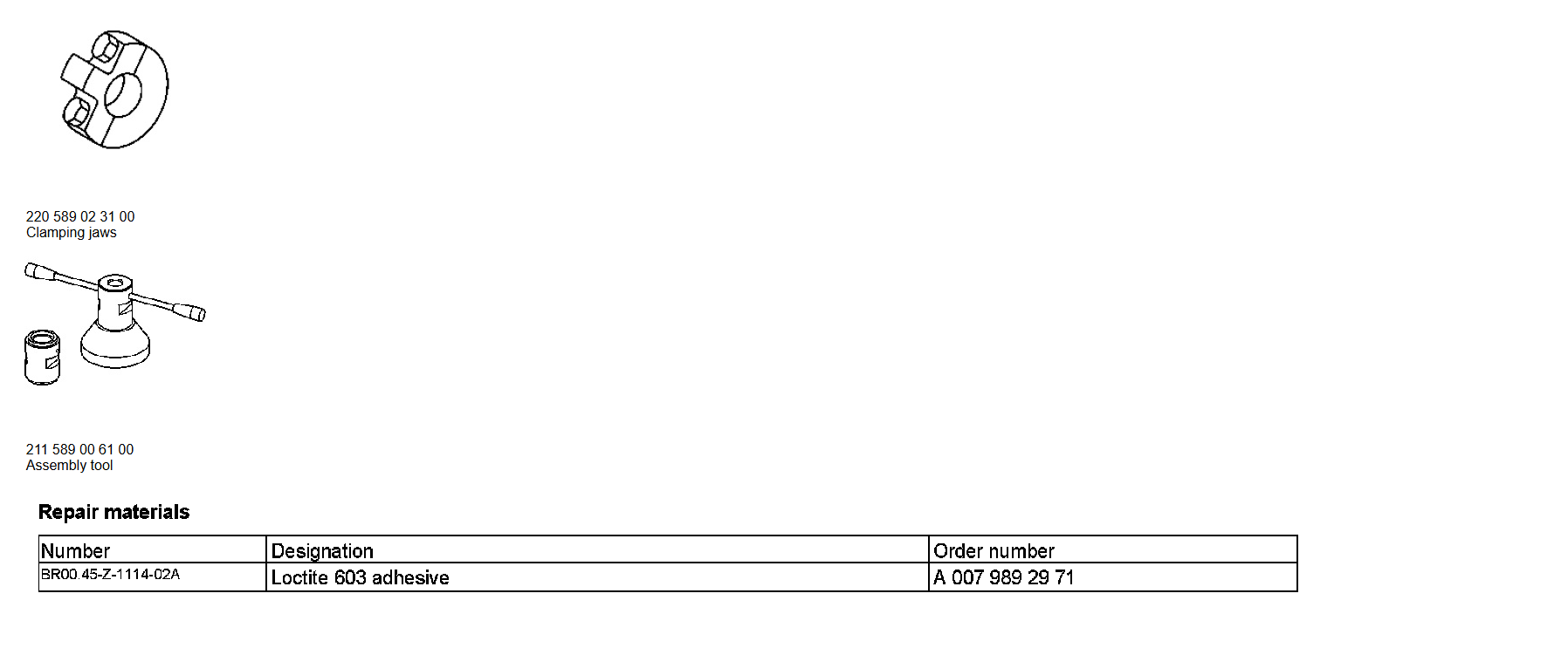

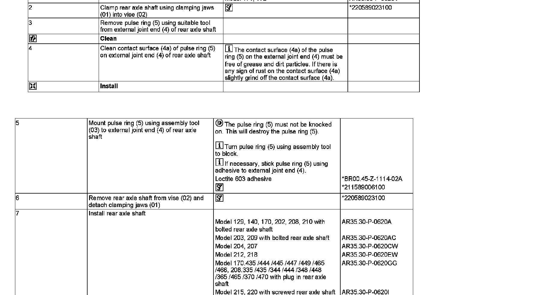

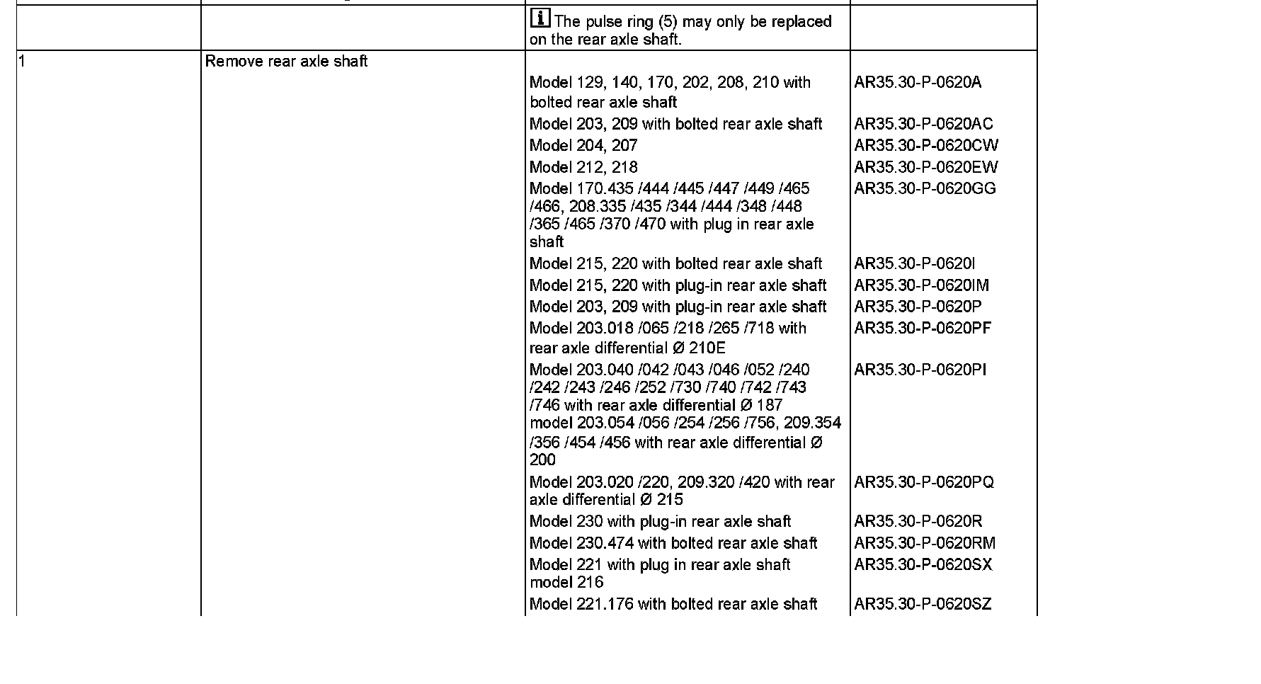

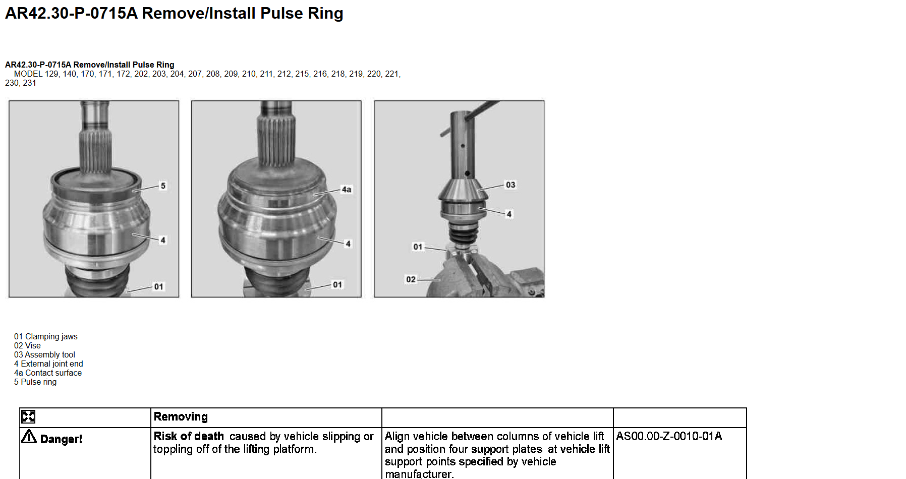

I've seen a thread where someone replaced a rear tone ring. They unbolted the control arms from the wheel carrier and removed the wheel carrier from the car leaving the axle in the car. Slot the old tone ring to break it free from the axle. Then they tapped on the new ring. The MB manual says to NOT tap on the new ring which can damage it. MB shows a pressing tool used to install it.
Reply 1

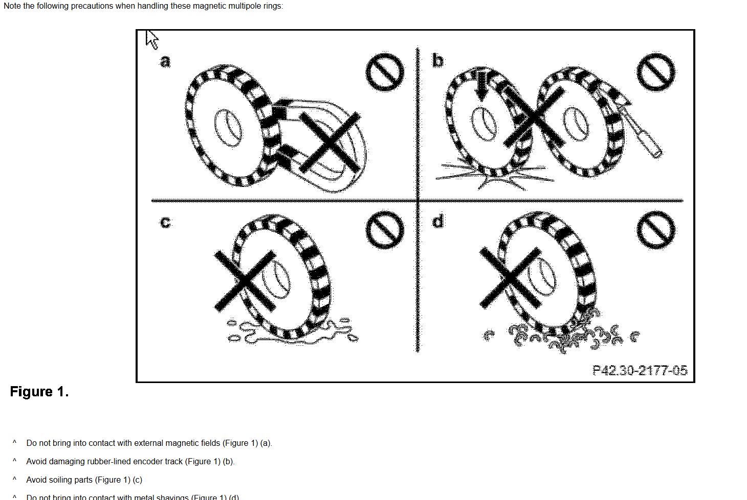

Be sure to keep anything magnetic away from the wheel carrier/axle.

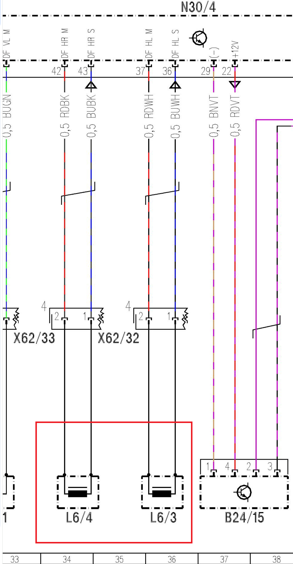

Nov 16, 2025 | 08:52 PM
I will also add the specific fault codes you are getting can point to the issue. Recently someone with a W221 was getting the abs warning on the dash after having the suspension in the front worked on. The specific fault code was something like left front sensor open positive/ground. That pointed to either faulty sensor or wiring issue or sensor not connected. I think it turned out the sensor was not reconnected.
Another fault code could be something about implausible readings which would point more towards a faulty ring. The car recognized the sensor was connected but was not seeing wheel speed readings matching the other sensors.
I dont have 2013 manuals but from my 2010 manual its showing the sensors are wired directly to the abs unit. So it can test if the sensor is connected and if it has an open circuit.
Rear sensors in red:
