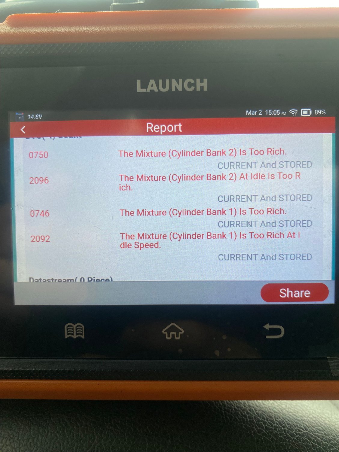

I just solved this issue 2 weeks ago and it came back. But the thing is now , is that I literally feel nothing wrong with my car . It’s driving great , there is zero noise , no vibrations . Cleaned my MAF sensor 2 weeks ago. I’m gonna check the air filters after this snow storm . Maybe there’s my issue . But I want to hear another opinion .

B1/B2 : Rich AF...
Both banks too rich... (bad for cats!)
can you read your fuel trims?
Have you cleared faults from your ECU after recent MAF service... do it.

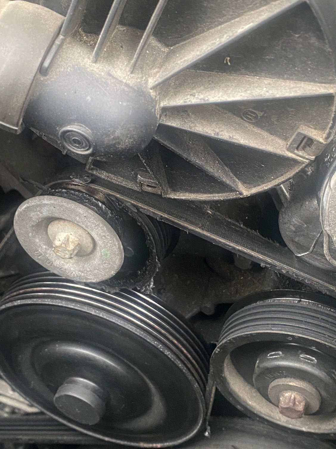

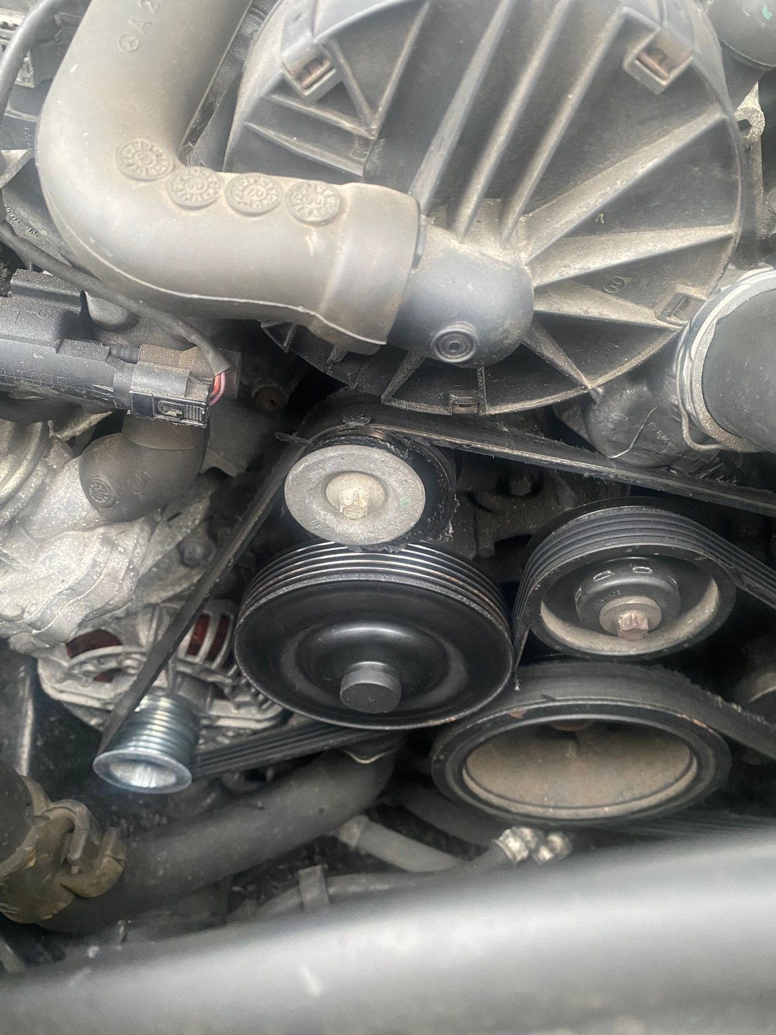

was diagnosing the car for being rich and this happens . Looks like my belt kinda burned the groves . This is a whole new problem

new priority shuffle
Inspect ALL your accessories pulleys are operable without too much loose wabbling.
Ultimately at least replace belt kit: tensioner + idlers + serp. (+ accessories).

Realise the belt controls your steering assist... you best need a Pro to make this system RELIABLE for the next 60k.Mi.
This job starts with a belt kit ~$150 + TBD. failed accessories.

it’s just replacing a belt and some pulleys , would I need to do something else other than replacing belt & pulleys? You telling me to take it to a shop?

also back to this . Before my belt gave out , I was scanning ECU for codes and now it’s just saying Bank 2 is rich and bank 1 is okay . I have cleared the code when I finished the service . When I look at my fuel trims what am I suppose to be on a lookout for . Say for example , my MAF sensor is going bad , what kind of data would I look for? Or say my O2 sensor was going bad , what data stream would diagnose that? Sorry I’m still new to diagnosing , I don’t know what data is for what.
You right about Fuel trims! LTFT can help diagnose combustion of:
  1. low fuel pressure
  2. old Lambda upstream sensors
  3. Overgapped spark plugs
  4. dirty MAF sensor
  5. oily MAP sensor
Read LTFT 1+ 2 at warm idle.

wobbly pulley bearings
You need this machine to be safe & reliable, right?
Someone needs to assess the accessories to make sure only the tensioner caused the slippery belt failure.
The service of serpentine accessories is really not time consuming nor too expensive if nothing else
  4. dirty MAF sensor
  5. oily MAP sensor
I have a launch Creader elite V2.0 I kind of don’t know how to look for specific data . Like MAF OR MAP or low fuel pressure data . Overgapped spark plugs can cause my engine to run rich?? I figured that’ll be a misfire ? Sorry for asking a lot of questions I really want to get to the bottom of my engine running rich
