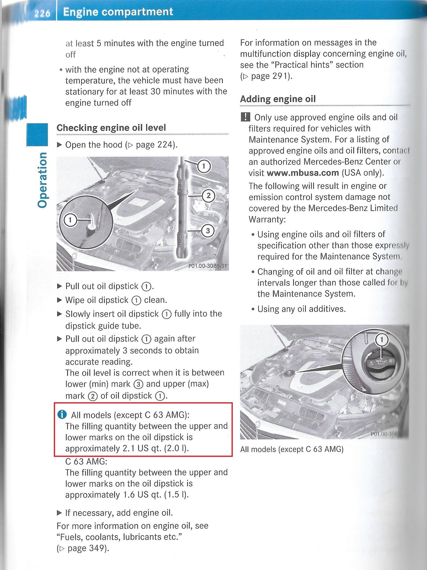

How are you checking and confirming it is indeed losing a quart of oil every 500 miles?
In my Operators manual it notes that the quantity of oil between the lower and upper marks on the dipstick is around 2qts.
You would measure how much you put in to get back to a given point...
