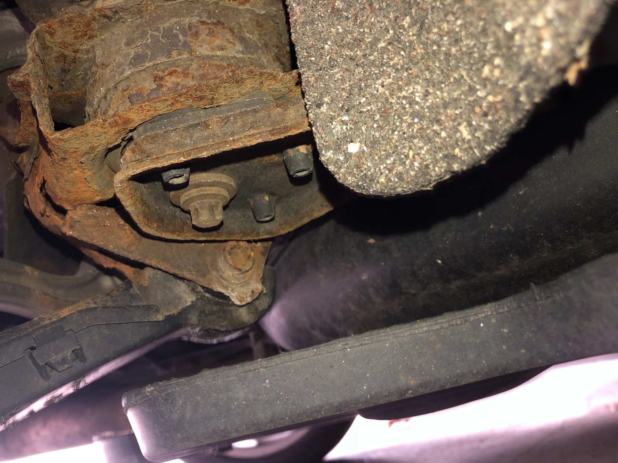

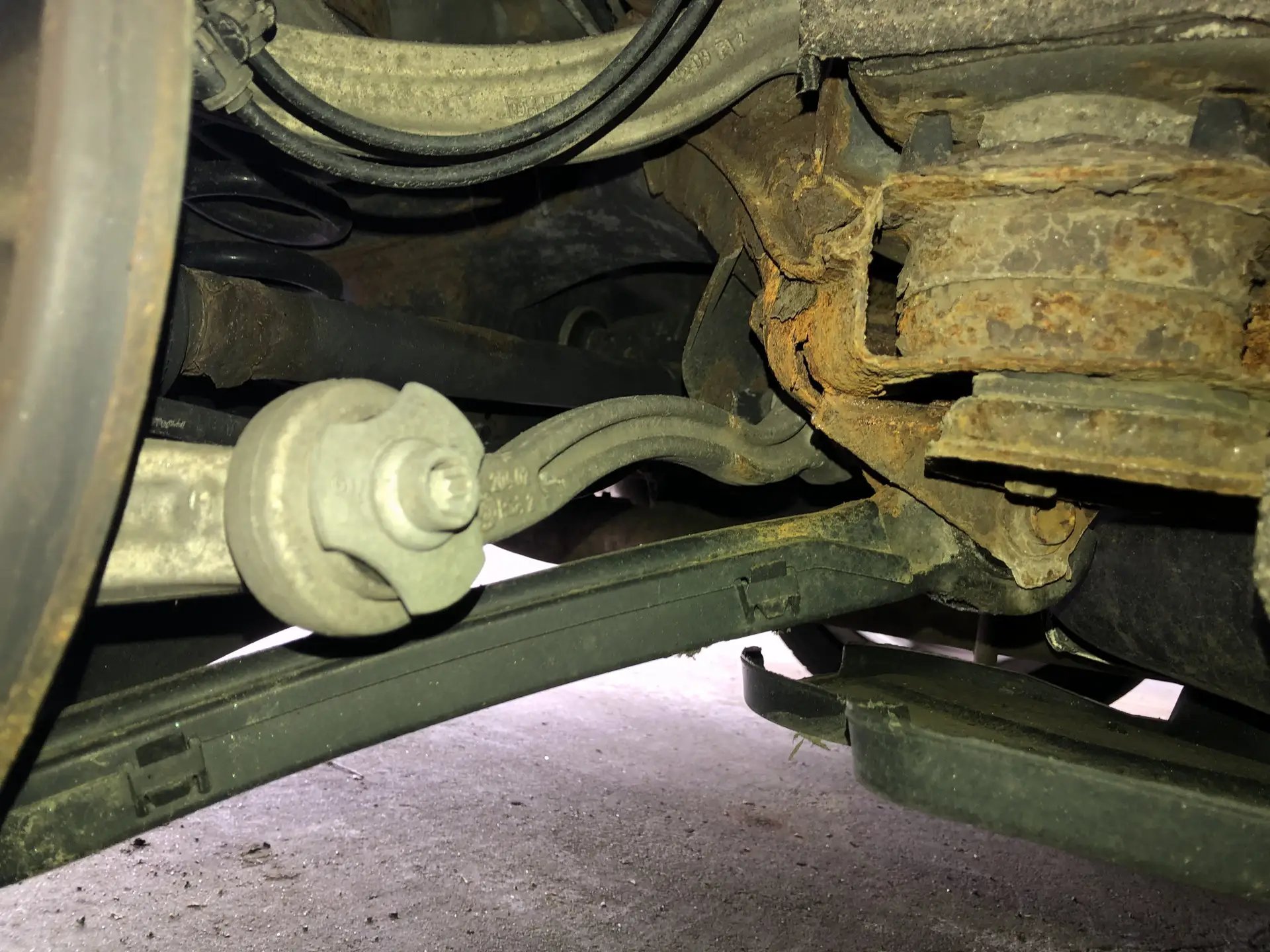

My subframe is rust out 2010 c300 4matic sport 94k miles

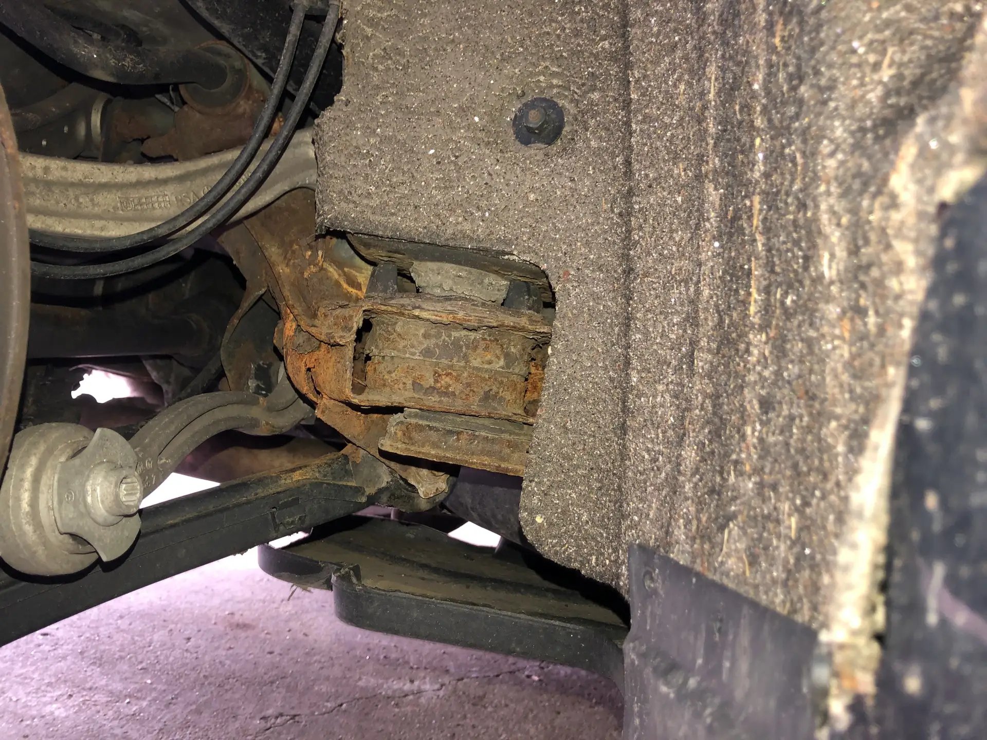

Hello, just got word from my indy mechanic that my subframe has rusted in half. Bringing to Mercedes to have it looked at. Hopefully they will cover the replacement. Do you think they will cover it no questions asked, its making a clunking sound and back end slides out when braking hard. @TimC300 Hey Tim, hope you are well. I remember you helping me out a ton 2 years ago when my C300 was hit.

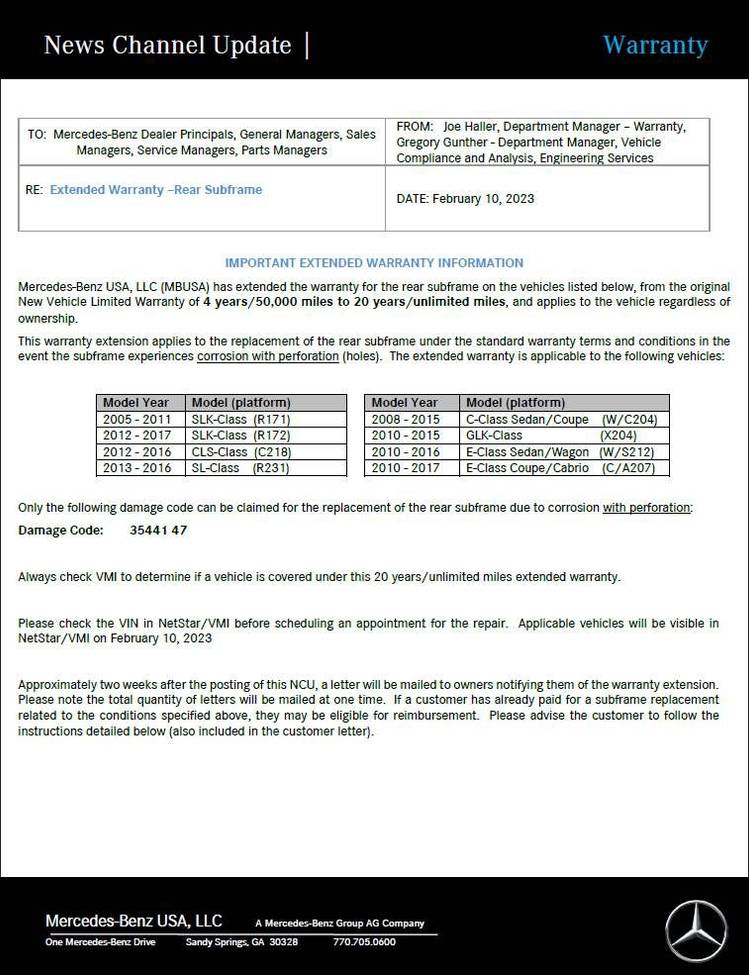

Extended warranty from internet search:
Mercedes-Benz has extended the warranty on rear subframes for specific C-Class models (W204, 2008–2015) to20 years with unlimited mileagedue to corrosion issues, particularly in cold-climate regions. The, often free, replacement is valid if the subframe has structural damage like holes or broken welds, as confirmed onthis Mercedes-Benz NHTSA documentandthis related NHTSA document.Key Warranty Details:
  • Coverage: Covers the rear subframe and its mounting bolts if perforation (holes) from rust is present.
  • Models Included: Primarily 2008–2015 C-Class (W204) and 2010–2015 GLK-Class (X204).
  • Models Excluded: The newer W205 (2015–2021) C-Class is typically not covered, despite similar rust reports.
  • Action Required: Contact an authorized Mercedes-Benz dealership to have them perform a safety inspection using your Vehicle Identification Number (VIN).

there is a 20 year/unlimited mile extended warranty on these cars for this exact issue. wondering if anyone had any luck getting them to do.

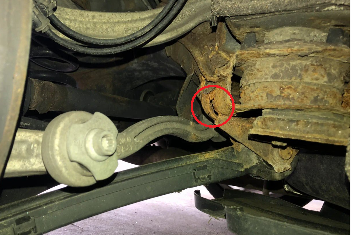

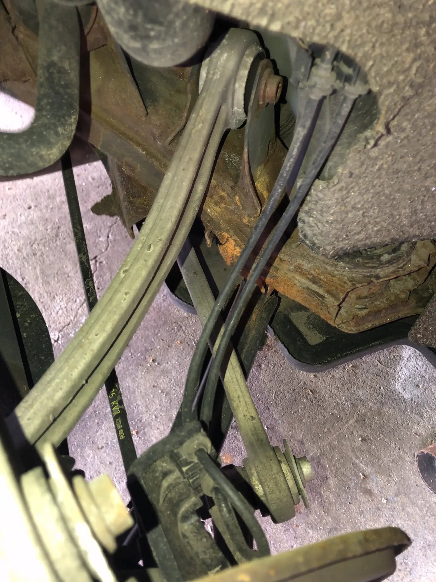

Looks "perforated" to me, Frame looks rusted and split at least in the photo.
I would print out all the warranty information for the subframe and bring it with you to the appointment with the dealer. They will inspect it then provide you a write-up of what they observed and recommend.
Ask for a detailed quote of everything they plan on doing. From my understanding from what others have said the subframe replacement includes all new bushings in the subframe itself. I think the new subframe comes with the new subframe bushings and differential bushings already installed. They should use all new hardware.
In my opinion this is a good time to have any worn control arms, sway bar, even rear passenger brake line replaced if it needs it. They will probably bill you for that work but with the subframe already off the time should be significantly less. My local MB dealer will even install parts I supply.
Though i'm sure they will try to charge you $2K to replace the rear brake line since they will want to replace the entire line from the engine bay back. You can easily replace the line yourself if needed. I did the rear section of mine for under $100 in parts.

Even with regular inspections and no noticeable signs of perforations mine broke. after a bad winter driver side thrust arm separated. I’m guessing the years of fluid film I was putting on just masked the outside and it rotted from
inside. Poor quality part that should be replaced as it ages, should be a recall.

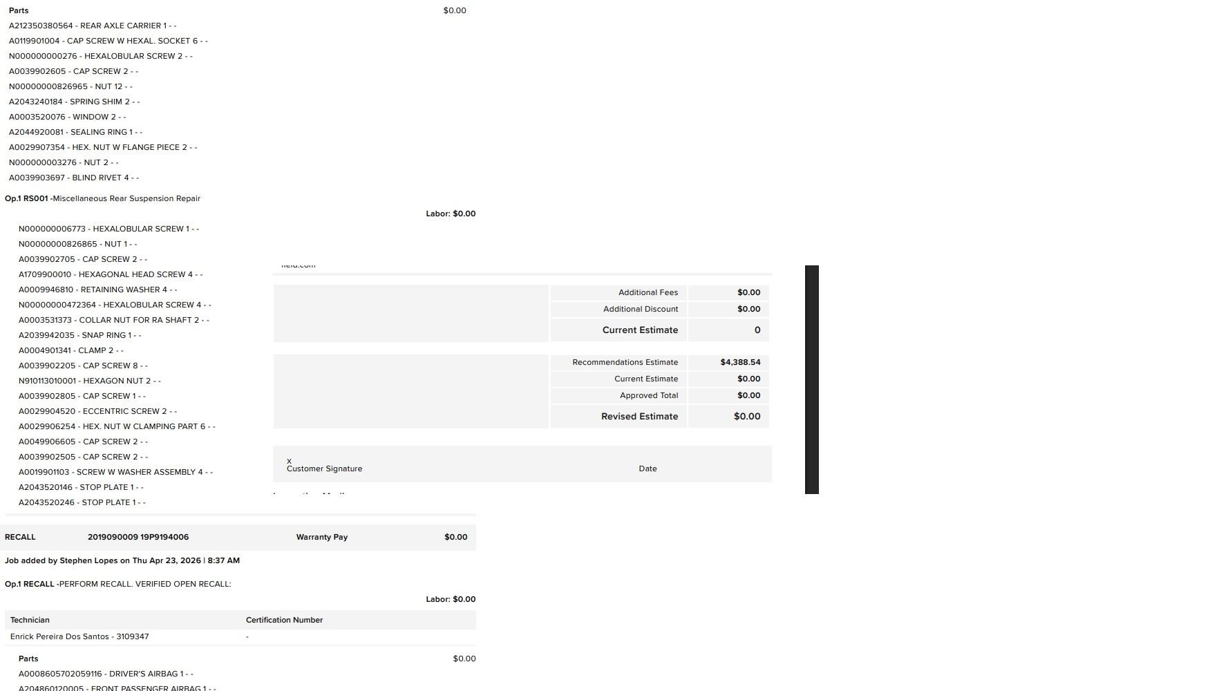

Brought it in this morning, they said it will be ready sometime tomorrow and it is covered under the extended warranty. they recommended almost 5k in other work which i deferred but hopefully no surprises and it will get done completely free.
Old Apr 23, 2026 | 06:16 PM
Boston M Benz's Avatar
Joined: May 2024
Posts: 86
C300 4matic sport
@TimC300 Good news, they are fixing it under the extended warranty and will be done sometime tomorrow. They recommended that I do my brake lines for $2700 but I declined. Also said I was leaking a little tranny fluid and wanted to do the filter and fluid for 900. Brake lines do look pretty rusted but I am going to wait. Tim I know you have a very similar model to me, have you done your brake lines and if so when? How's your car running, any major issues lately?
I will say, I was a little nervous about the whole situation and thought they might give me a hard time but so far their service has been first rate. They've made it very easy.
Old Apr 23, 2026 | 06:23 PM
Joined: May 2024
Posts: 86
C300 4matic sport
This is what they gave me regarding the subframe.

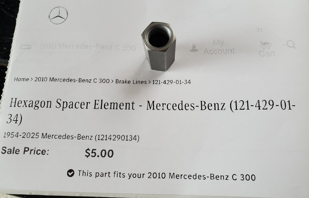

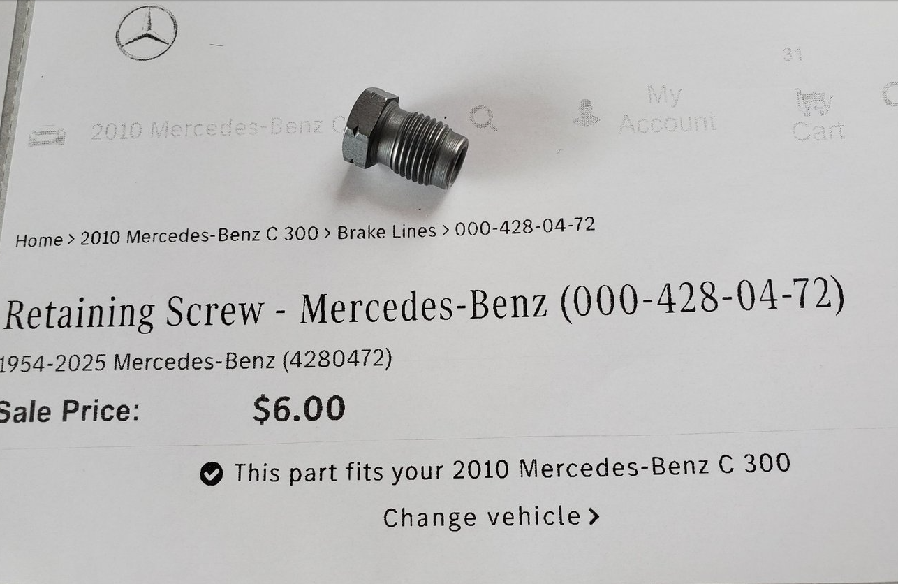

I replaced the rear section of my rear passenger brake line. It was severely rusted from the drivers side wheel well over to the passenger side so I simply cut and spliced in the new section.
I wrote a detail thread on it here: https://mbworld.org/forums/c-class-w...ake-lines.html
It was inexpensive to do. I think the specific brake line flaring tool was the biggest cost. I highly recommend using the Genuine Mercedes nuts and connectors.
I think I really lucked out because as I was working on the brake line the old line started leaking.

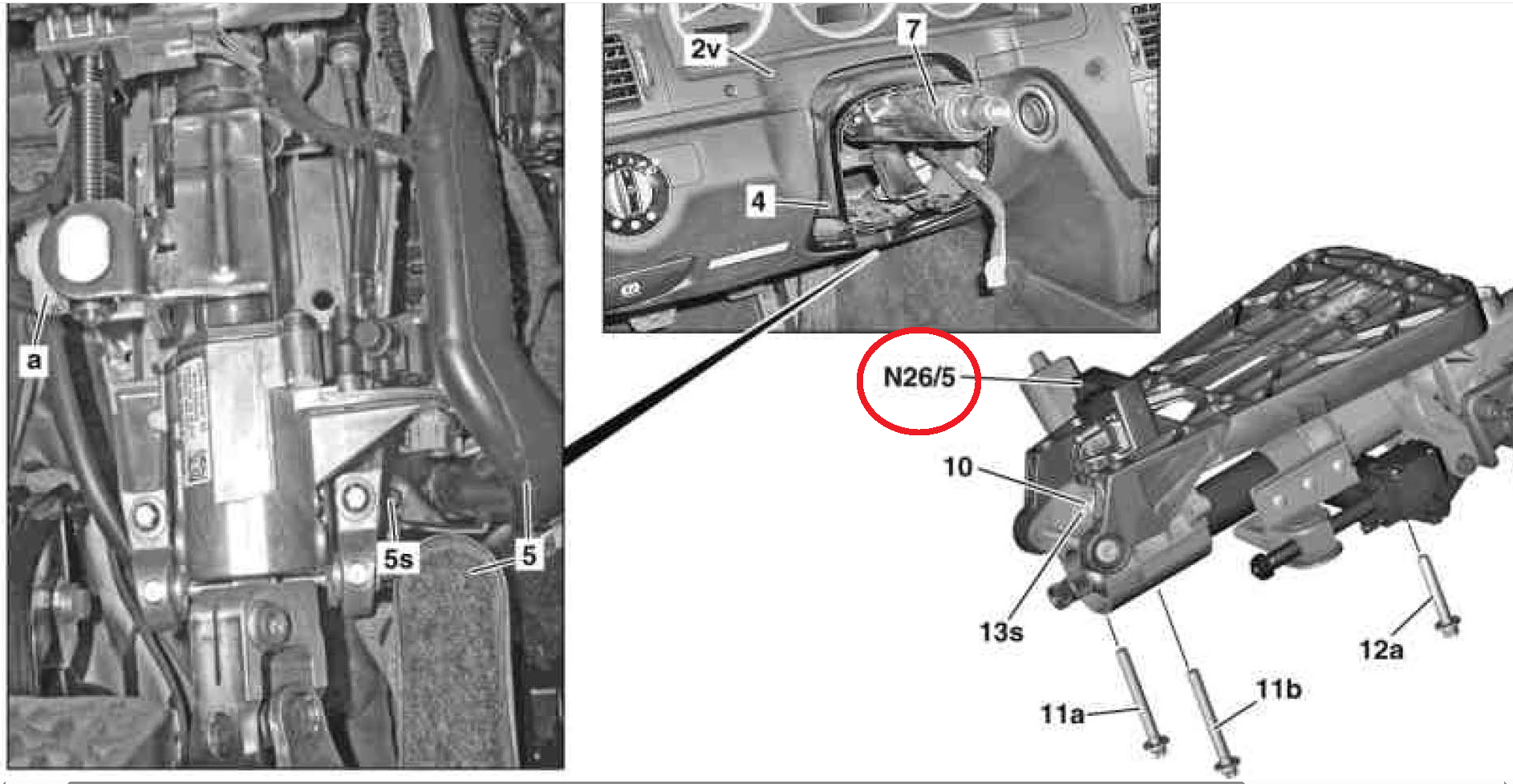

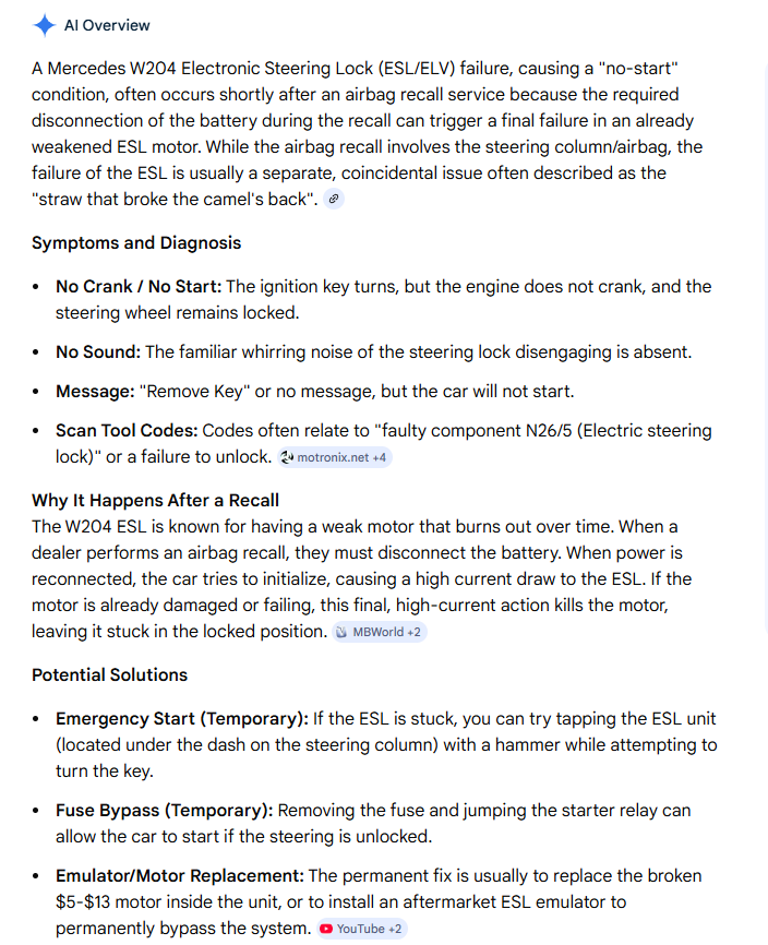

UPDATE: I brought my car in Thursday morning for the subframe and airbag recall. They "fixed" both and I went to pick it up Saturday and the car won't start. They said my ESL failed and needed to fix it for $2700+ plus a new battery $475. I did not want them touch my car after that, as its been my daily driver for the last 5+ years and never not started. Apparently the airbag recall commonly causes the ESL to fail b/c they disconnect the battery and when they reconnect it, it sends high voltage or something. I had it towed home. Now my steering wheel is locked. I replaced the battery but nothing. Anyone have any advice on the ESL, I heard about an emulator? Anyone know someone that can fix this in the Boston, Massachusetts area? Thanks @TimC300 have you had your ESL lock up before? Also, did you have to bleed your break lines and how did you fill them?
Old Apr 26, 2026 | 07:11 PM
TimC300's Avatar
Joined: Aug 2023
Posts: 3,687
Likes: 1,109
From: MA Coast

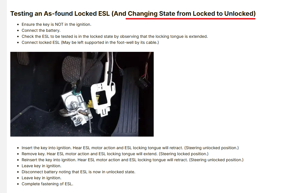

I never worked on the ESL before. If it is just the blown electric motor I would try replacing it. Seems the big issue is removing the ESL since its in the locked position. Will have to research how to remove it.

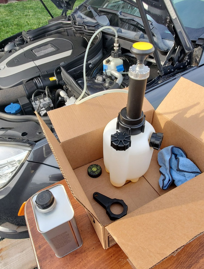

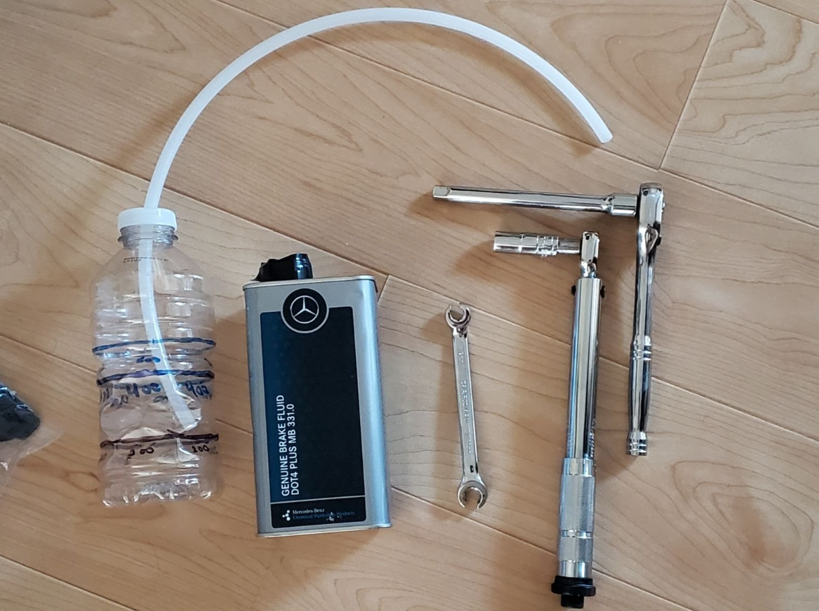

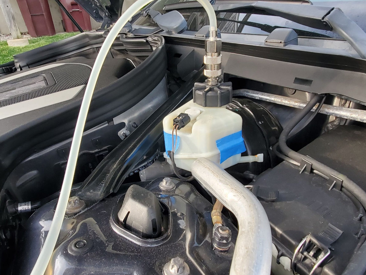

I replace the brake fluid every 2yrs. My brake fluid will turn a dark brown color or at least not as clear as new fluid. I bought an inexpensive bleeder and it works great.
I wrote a short thread on it here: https://mbworld.org/forums/c-class-w...ake-lines.html
I buy the MB Dot 4+ brake fluid on ebay pretty cheap. A 1 liter container is plenty to do the job.
- Use tape to mark the level of brake fluid in the reservoir. You want the level to be the same when done the job. (unless replacing brake pads and rotors)
- Open brake fluid reservoir and suck out as much old fluid as possible. Fill to the top with new fluid.
- Fill brake bleeder with rest of new brake fluid. Connect bleeder to reservoir. Pump up bleeder to 10-15psi.
- Open bleeders at each caliper and allow the fluid to run into container until you see the new clear fluid then close bleeder. I use 1/4" ID tubing on bleeder to container. Torque bleeder screw 14nm.
- Release pressure on brake bleeder and remove from reservoir. Correct fluid level in reservoir to original level.

ESL stuck in the locked position is a pretty hard job, you have to take the steering column out. The dealership broke it after they did the airbag recall b/c their notes say they test drove it after the subframe was put in and it drove normal. Either way, now I need to get it fix and I think the emulator is the way to go. Does anyone know someone in the Boston, Massachusetts area that does emulators? Man this sucks.

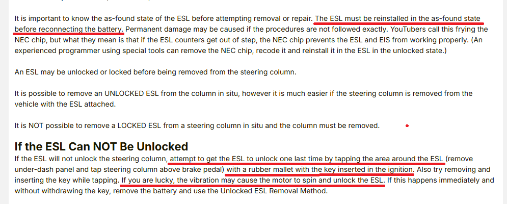

Last resort, try to tap the esl directly with a hammer while turning car on, long shot but may work one more time.

I was reading thru a very good detailed write-up on the ESL here: https://www.benzworld.org/threads/ho...art-1.3071246/
From reading it i would try to replace the electric motor. Wont have to mess with finding and paying to have e new ESL coded or an emulator coded.
One very important step i read was to make sure the ESL is in the SAME position as it was when hooking the battery back up. Something about the car counting the exact number of thimes the car is locked/unlocked and if reinstalled wrong it can screw up the car.
I would try the step noted above tapping the steering column trying to unlock the ESL.

So, MB USA extended warranty coverage for rear subframe rust through….

@TimC300 yea I've looked into changing the motor on that ESL, man I don't think I am comfortable taking the whole steering column out. In the technicians notes, He test drove it after the subframe and it drove normal. So they must have busted my ESL after they did the airbag recall. They said it even drove after that and the steering wheel was not locked!! I have a case # with MB corporate to see what they can do, I just seems too unbelievable that the ESL failed right when they called me to pick it up. I can get a local locksmith to removed the lock and programed an emulator for $700, need to have it towed to them but I am going to see what MB corporate says.
Honestly Tim, you might want to get ahead of the ESL as it seems like not an "if" problem but a "when" on our model, although mine never failed before. its that little zip,zip sound you hear right when you put your key in. Those little cheap motors like to fail, terrible design. If I get it done they remove the whole ESL and zip tie the emulator right under the kick plate so if it fails for any reason, they can reprogram it or replace it easily, which is rare from what I read.
