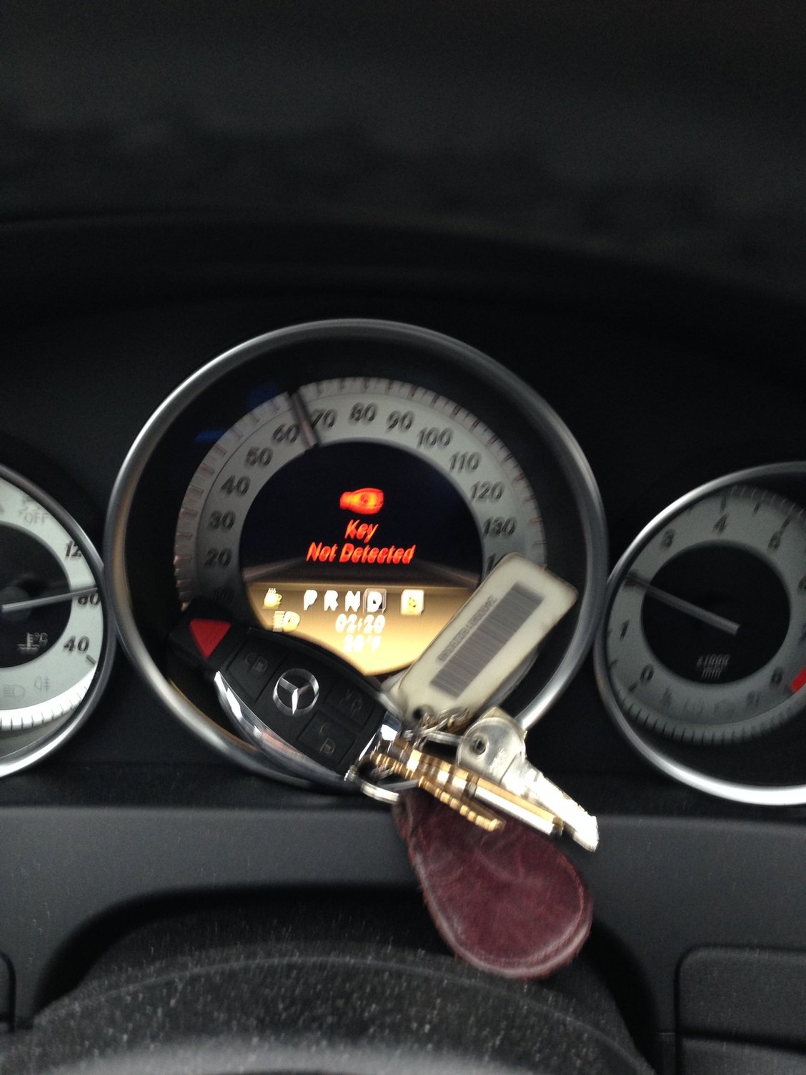

Let me be clear - I never had a KG error that kept me from entering or starting the car in a non-KG fashion - ie; if KG failed to work by pulling on the door handle or by not starting when I pushed the start button - then it WOULD work by unlocking the doors by pressing the unlock button on the key.
In every instance except two, when I pressed the unlock button on the key, the system would return to normal operation. The 2 exceptions to this were when it decided it could no longer find the key while I was driving! Then it didn't matter how many times I pressed the unlock button - nothing happened until I stopped the car and turned it off and then back on. See photo of me driving 65mph when this happened... yes, that's the key... in the photo...
This was in my 2012 C300 but I had a similar KG problem the very first day I had my 2015 C300...

I have had 8 keyless go MB vehicles, since my 2003 SL 55 (wallet key), and invariably, cold weather or not, when the key was not recognized, a battery change corrected the problem. BUT my 2015 ML250, did not recognize key- so pushing the open icon on the key allowed recognition and a keyless start. Battery voltage was 2.95. New battery, no problems. WE NEVER OPEN AND CLOSE OUR CARS WITH THE KEY OR START THEM WITHOUT KEYLESS. This car was delivered 3 1/2 months ago! (OK bad Panasonic Battery).
But what's really frustrating is the 2015 S 550 delivered January 29. One out of five times, the key was not recognized by the ignition! I was only locked out once from touch handle, but pushing open on the key, solved that problem. One key had 2.97V, the other 3.01V. New batteries, no difference. Software upgrade was done and keyless start worked flawlessly for two weeks, even though the lead mechanic at the dealership did not think it would make a difference. This morning it was about 15 degrees in the garage and the key was not recognized by the S550 ignition until the open car button was pressed. Battery - 3.03Volts.
But my 2013 SL550, mostly idle winters because it can't get up a slippery driveway with the Bridgestone summer tires-has never a keyless problem weather not withstanding and it has same batteries as when delivered. (I like to drive it winters if my driveway id free of ice and snow and the roads clean.) IT IS VERY COLD IN MINNEAPOLIS, and I think keyless problems are to some extent weather related, but the keyless problems seem to be worse with 2015 model year vehicles. I suspect they have changed something, and its for the worse.

I've had 'Key not detected' once whole sitting in the car with the key in the cup holder.
I exited the vehicle, locked and unlocked the car three times (this used to reset the W204, have no idea if it does on the W205) and it stopped the error.
