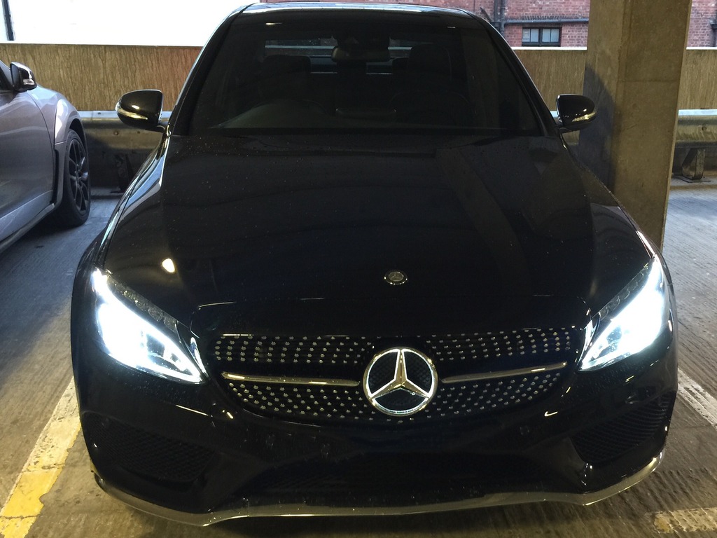

Car with diamond grill and illuminated star..not the most glamourise of locations I know ! But only one I have with it lit!
Looks nice are you interested in selling the illuminated star?
Sorry,I'm hoping once I get the car back to to keep it! You can order the star pretty easy tho just look on eBay etc
