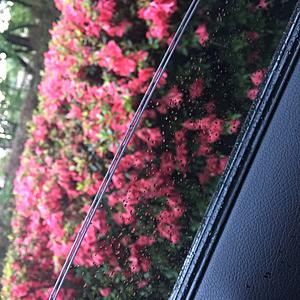

got my windows replaced. so much quieter now..
Attached Thumbnails Official wind noice service bulletin-2016-05-06-19.41.26.jpg
