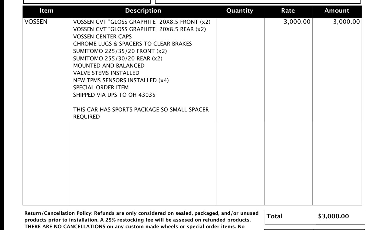

Just ordered some Vossen CVT 20X8.5 for all four.
Front: 225/35/20
Rear: 255/30/20
I have the US C300 4Matic w/Sports calibers.
Will I need 5mm spacers in the front since its not a 450?
Thanks for your help!
Front: 225/35/20
Rear: 255/30/20
You wont need spacers, itll be close but work fine

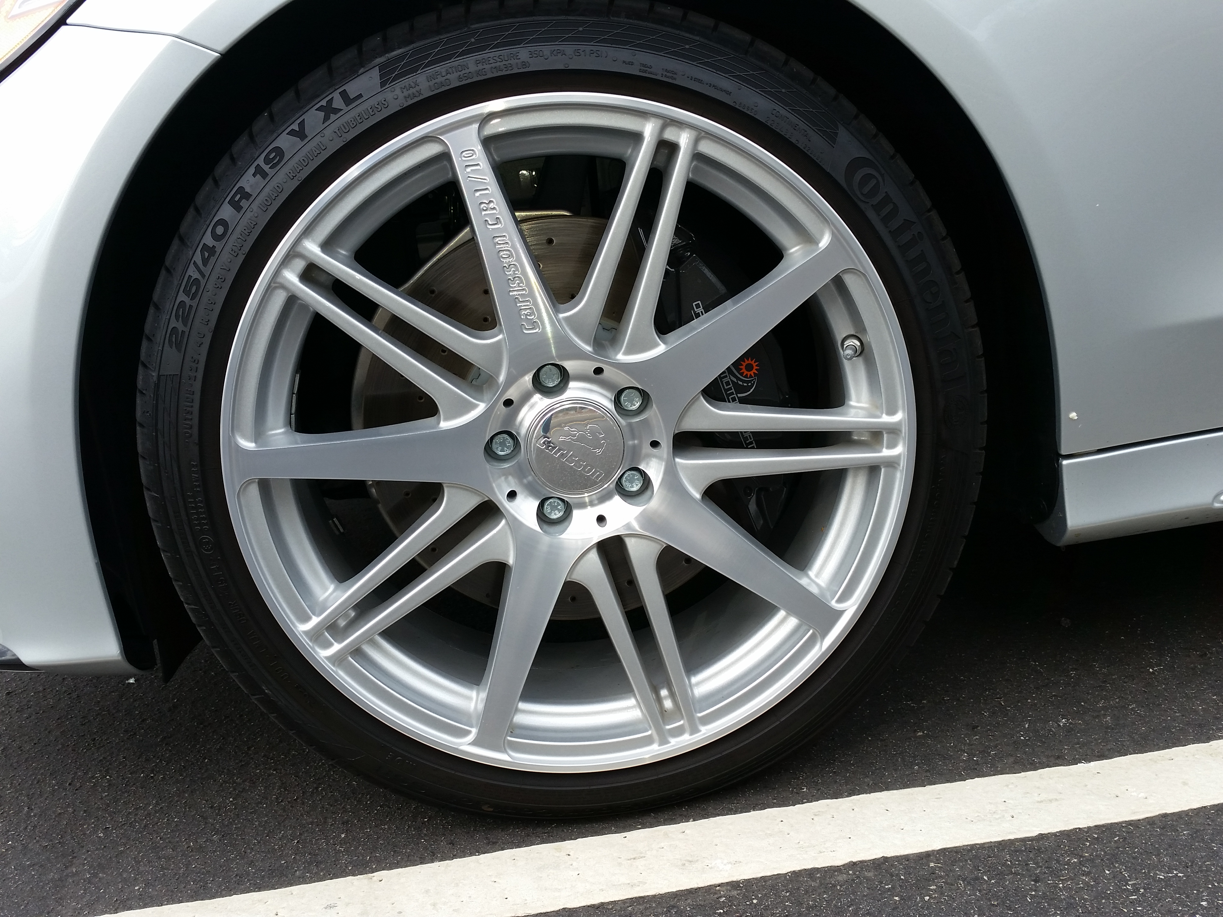

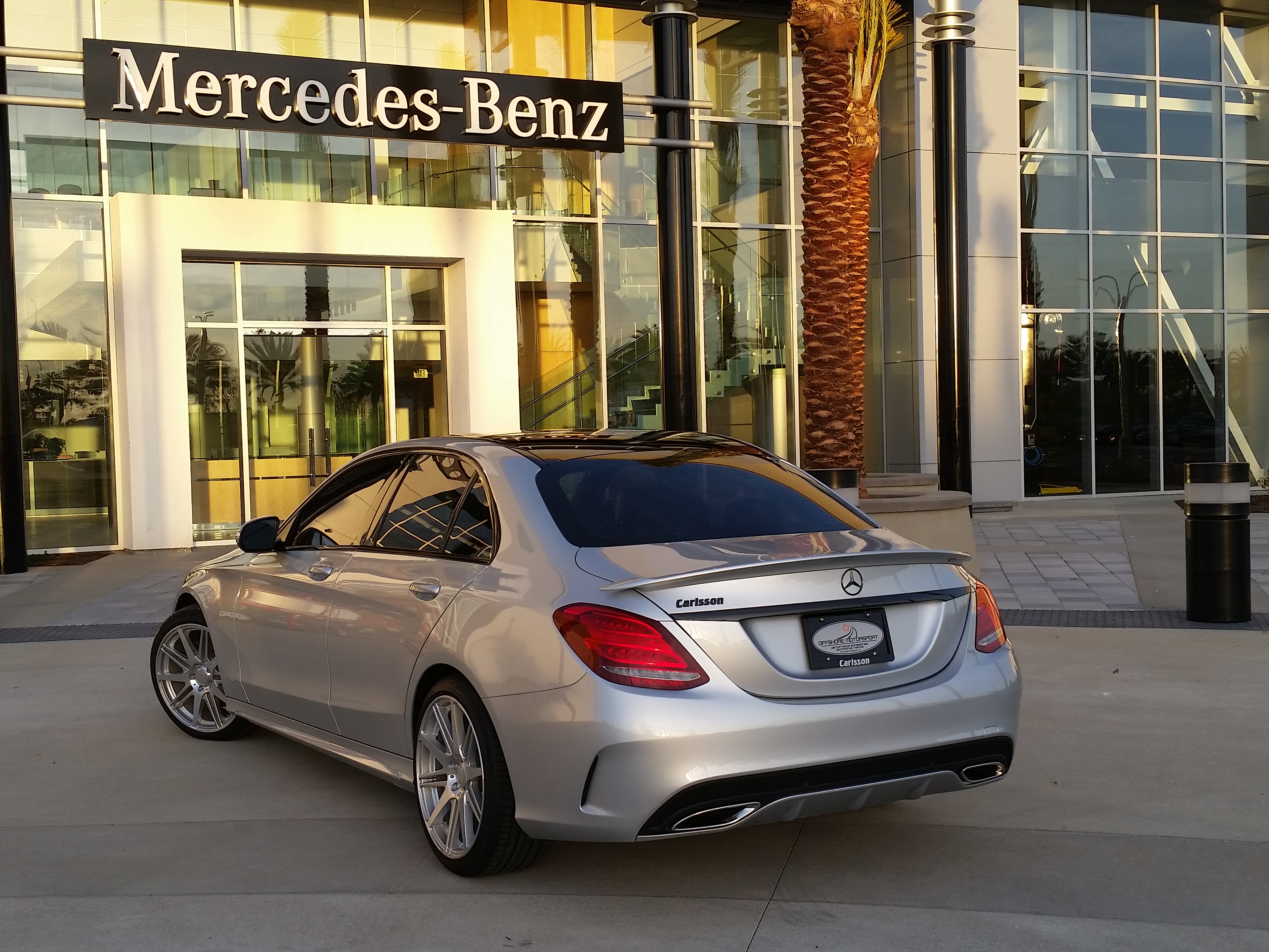

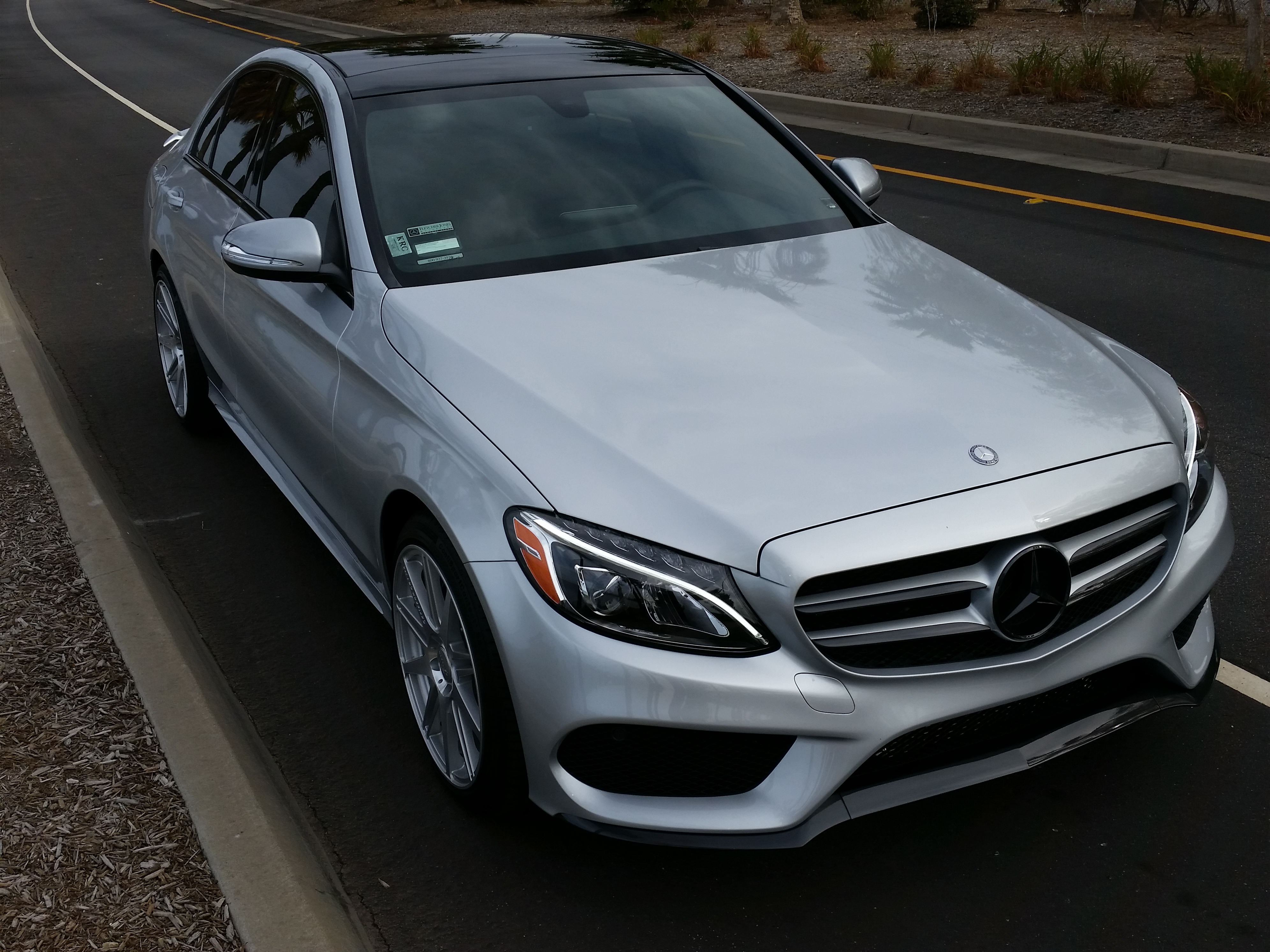

Attached are picture of my car when we had the Carlsson package on it, the front wheels are 19x8.5 ET45, and the rear wheels are 19x9.5 ET50.
The car came with the factory 19" AMG multi spoke wheels that are 19x7.5 and 19x8.5. We swapped the tires on to the Carlsson rims which stretched the tire a bit both front and rear, but it looked good and fit properly, and with all the 4 matic cars in the market this set up was applicable to those models as well.
Currently testing is being done for the new C450 as this car has a larger arm on the front suspension. The C63, keep in mind has a wider front fender, so the applications for a 63 version will not be the same application like the standard cars, and the 450 does not have this wider fender either.
If you have a C300 or C400, or a 180 or 250 etc in Europe, the 19x8.5 ET45 and 19x9.5 ET50 will fit and work perfectly with the factory spec 19 inch tires.
The rear wheels with a ET45 will sit past the edge of the fender...so if you run a larger tire it is just going to hang out the fender that much more.
Hope this info helps.
