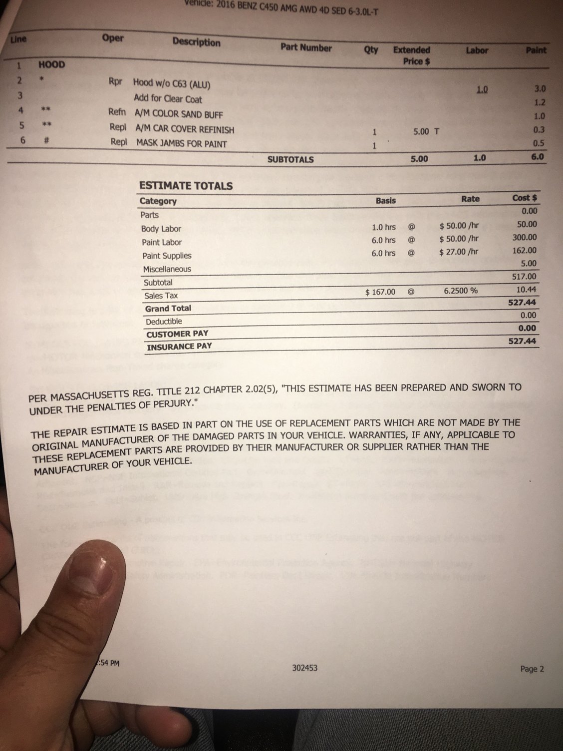

Well I took the car to a certified Mercedes-Benz collision shop.. They said they only need to paint the hood of the car. They do not need to blend the paint into the fender? I asked them why and they said they use special Mercedes paint that does not require them to blend as much as other body shops.. Then I went to another body shop and told them what the authorized collision center told me and they said that there is no such thing and for the job to be done correctly they need to blend the fender... I don't know who to believe. And I don't want to have a body shop have to redo the paint work so there's 10 inches of paint on my car...anyone here work as a body shop guy that would know?

Blending is really only an issue when the paint color is not a perfect match, and that's usually due to aging of the existing paint. The blend is intended to make the variation less obvious by not limiting the new paint to one panel. If your paint is in good shape and the shop uses color matching the first shop should be fine. Typically you'd want as little of the factory finish disturbed as possible. What color is the car?

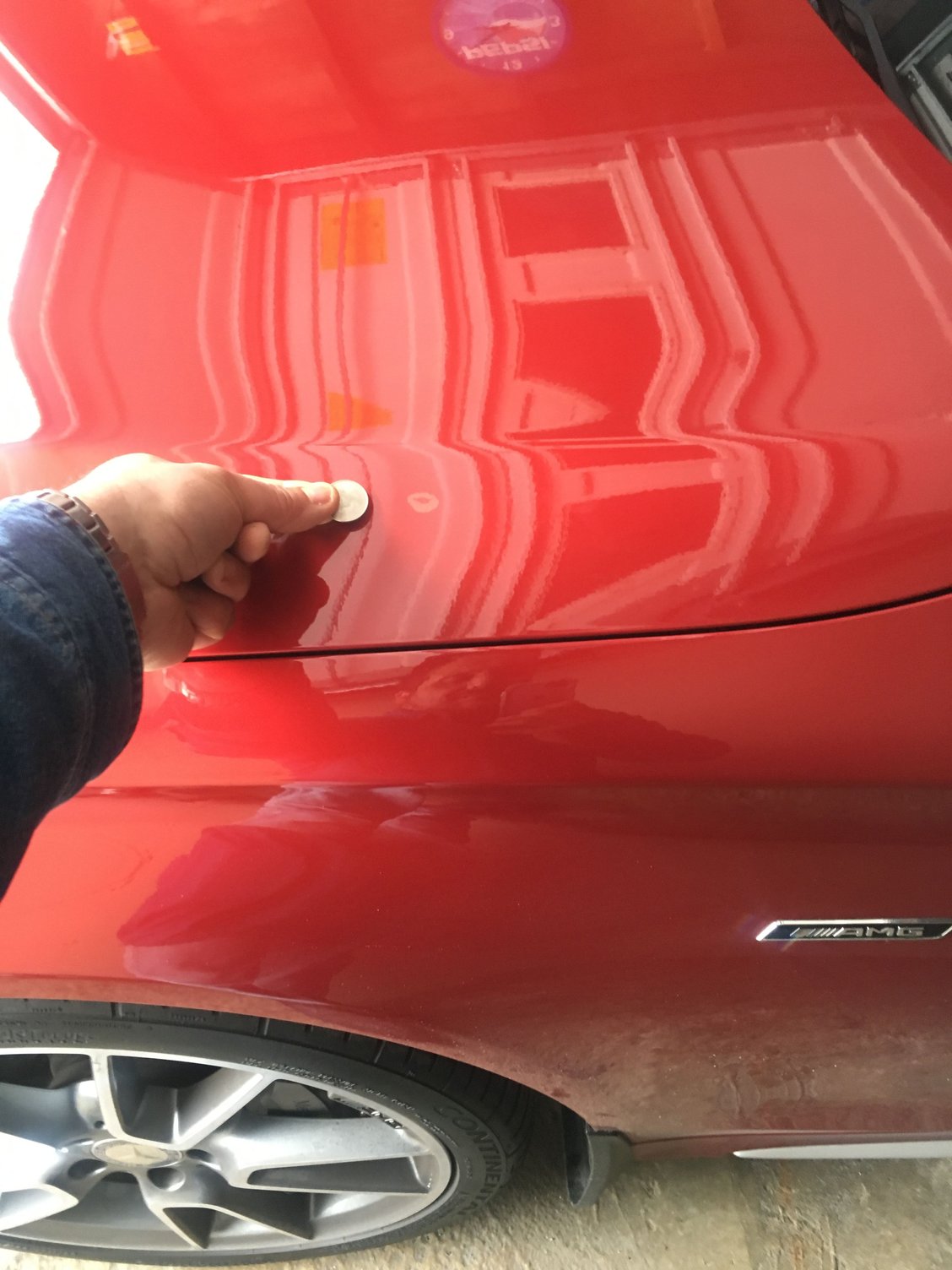

The car is a c450 cardinal metallic red.. Here is a picture of where the blemish is.. It's on the drivers side of the hood about 4 inches from the fender..

Is that a bubble in the clearcoat?

No I sanded through the clear trying to fix a rock chip

Got it. So do they need to feather in the defect in the clear, sand the entire panel, prime and reshoot color and clear?

I don't know how they would do it? That's why I'm asking all these questions cause I don't know if they can match the hood with the fender without having to blend into the fender

I don't know how they would do it? That's why I'm asking all these questions cause I don't know if they can match the hood with the fender without having to blend into the fender.. If you know can you explain if just painting the hood will match the fender please.. The dealer said they only need to spray the hood, some other body shops said they need spray some of the fender .. I don't know who is rite?

Did they write an estimate for you and if so can you post it? I was an adjuster for ten years and a buddy of mine owns an MB certified shop and I can run it by him if I can't sort it out for you.
Somehow they have to level out that low spot in the clearcoat, so I'd expect they wrote for a couple hours of repair.
