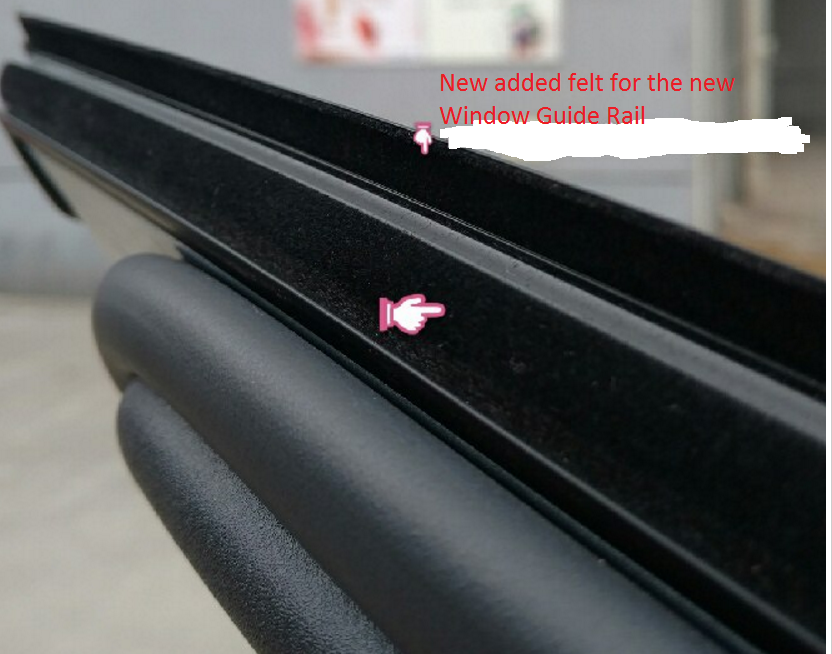

Hi Everyone,
I am new here and recently just bought Mercedes W205 C300 4Matic.
When I do the test drive, it is all good but recently I can hear the Door Rattling//Creaking clearly.
First, I browsed many forums and read about the door rattling//creaking issue seems quite common to W205.
Yesterday, I went to my dealership and asked them to fix it.
Today, I picked up the car the my dealership told me they add the lubricant to fix it. However, When I drove my car later, the passenger side door still be rattling//creaking in a certain of noticeable sound.
Then, I browsed more websites and realized this happens in China a lot and Mercedes in China is willing to change the WINDOW GUIDE RAIL for 4 doors to solve this annoying issues.

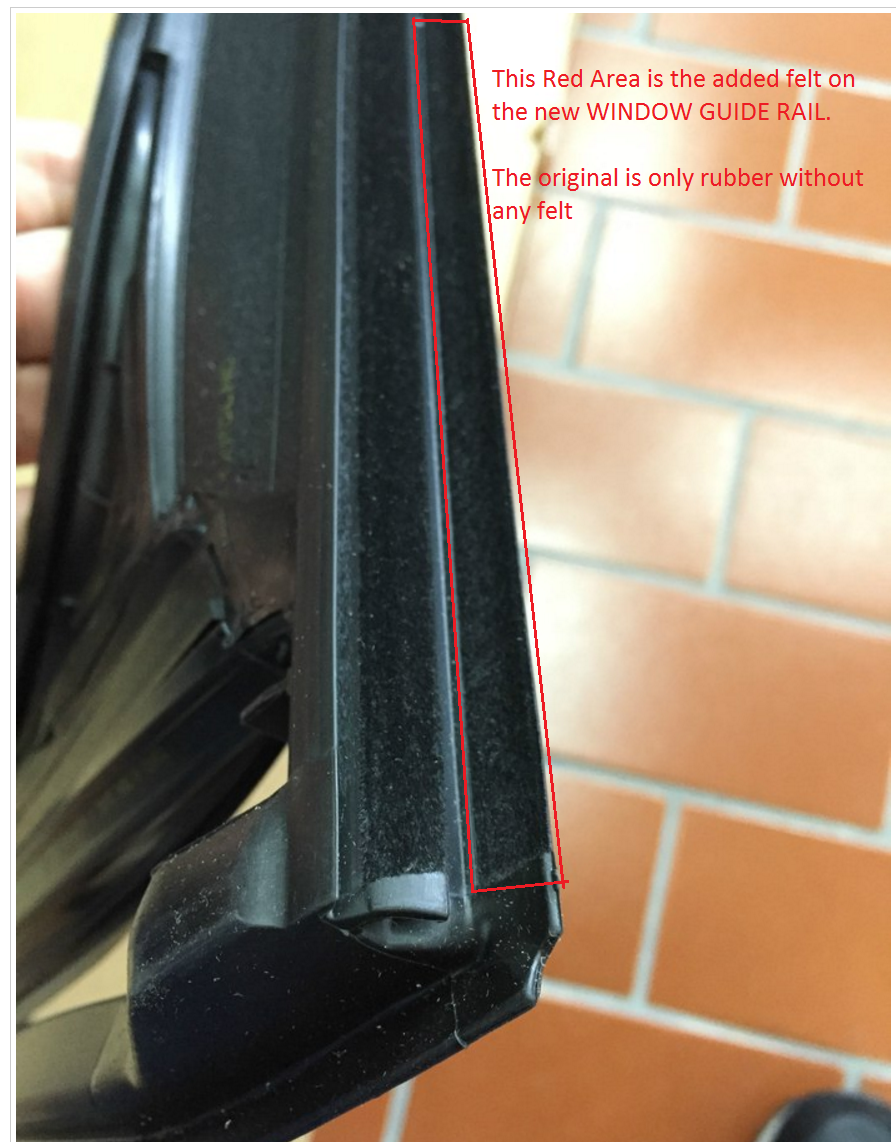

(The new WINDOW GUIDE RAIL comes with 2 felt)
(I am from Taiwan and can read Mandarin).

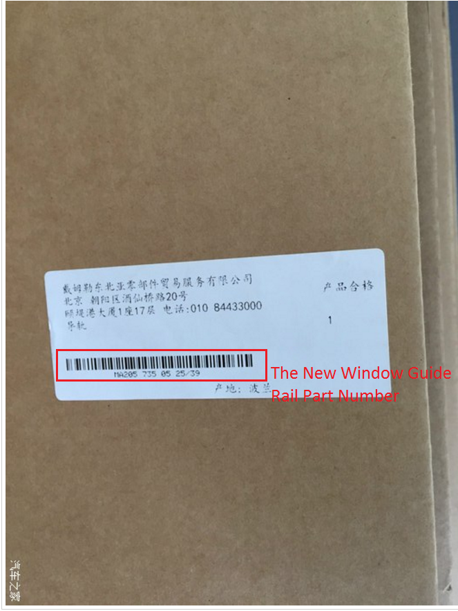

I have attached some pictures for the new WINDOW GUIDE RAIL comes with 2 felt and Part Number.
One of the Window Guide Rail Part Number is A 2057350625 (should be 4 different Part Number since 4 different Windows Guide Rails.)
I also checked the Part Number and found out we can purchase overseas (cannot find this Part Number in USA). Below link is the example.
http://benz.17vin.com/partsmain/1/205145/C12/73/FG/060
My question will be why Mercedes in USA has not taken any action or notification to ask W205 owner to change the new Window Guide Rail?
I am thinking about to buy the 4 different new windows guide rails to have my dealership change for me.
Any feedback will be helpful.

I have applied the felts to all 4 doors, and it's double sided compared to your pics which show single side.
Got the felts from China and the original solution was from a post from autohome.com.
90% improvement. But still can hear the rattles, but may not be from the same positions, I don't know... Definitely a lot better than before. It was rattling like hell, and it probably did not happen on many cars here in the U.S. and that's also why there's not enough complaints about this compared to almost every car in Mainland China.
It is the same website that I found the solution for the added felt.
I think I know what you are saying for the double sided felts.
I also checked another website that seems Canada Mercedes also applied for the added felt as the solution.
Will go to my dealer next Wednesday and ask for the added felt to solve rattling and acoustic windows for the wind noise.
Update you guys next week.
If anyone has any other good feedback regarding the rattle//creaking solution, please kindly share if possible. Thank You!
